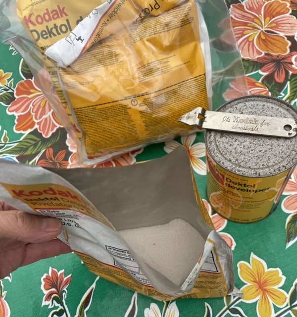

Three bags brown. Was about to give up. Got out the ceremonial can-opener and emergency can.
Then I found it! One bag of Dektol that is not brown!
My others had all been oxidized. Not by the Kodak supplier issue but by oxygen getting into the packaging. Two by mice, one by old age and bad luck. Since I found the brown Dektol turns my prints cream-colored, I am not willing to use it. Besides, with it really being oxidized I think it’s really ruined (as opposed to a harmless manufacturing impurity).
Anyway the can lives another day to be on hand for another emergency.

Me, no. I didn’t call anyone. I can’t blame camera store or Kodak. I had a lifetime supply given to me when they retired the “Headliner” at Burroughs back in 1985. The vintage multilayered plastic/foil/paper bags were well engineered and gave superior protection against breeches in most bags except when something sharp breached it. The next generation all plastic bags will breech if you fold it wrong. But in my case they were breeched literally by mice. Except this one I am mixing now. This one is going to be fine. A gallon lasts me a long time so I might be good for six months or a year unless some fury of desire calls. But that’s it, I am out now except for the can. Looking for more but have a couple months before I really need it.
Have I ever mentioned how much I love the darkroom because you have the potential to accumulate a supply stockpile that will last forever or six months whichever comes first.
The new batches where supplier is suspected is another unrelated issue with Dektol. I don’t have that. But am suspicious if I did it would stain my paper just the same.
The can opener is Beautiful! I have emergency cans as well. I panicked when Ilford went into receivership 15 years ago, I bought 10 or 12 5L packs of Bromophen. I used the last one a couple years ago, perfect. I panicked again when Tetenal got in trouble, I bought XTOL, Kodak Rapid fixer, and more Bromophen :laugh:. The XTOL move turned out OK. And the other stuff will keep. I'm definitely a "just incase" not "just in time" :errm::ninja:
