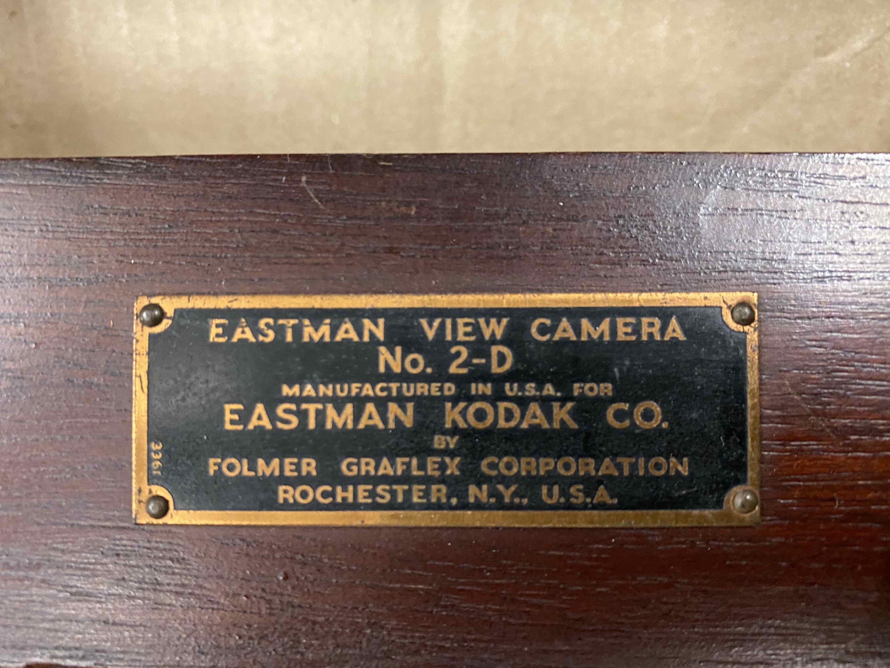

I’ve just picked up an Eastman Kodak 2D 5x7 Serial # 237844 and would be very grateful if I could get a date of manufacture.
Tag reads:
Eastman View Camera
No. 2-D
Manufactured in USA For
EASTMAN KODAK CO.
The FOLMER GRAFLEX CORPORATION
Rochester, NY USA
Many Thanks,
Kyle

About the middle of a listing for 200 5x7 Eastman View Camera posted 12/1/37. Next listing is 6/38. From other camera listings it appears Folmer Graflex made the cameras shortly after the listing was entered then shipped them out to the stores and made the next batch when the minimum from the dealers came in which depended on sales.
