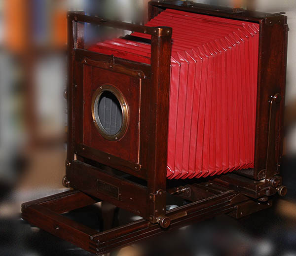

I just picked up the 8x10 2-D shown this morning from someone local on craigslist. From the C-1 plate, I'm guessing it's from 1941 but I should be able to confirm that from the graflex serial number.
It's a nice camera overall but needs a ground glass - any suggestions on the best/cheapest way to pick one up?
Thanks,
Dan

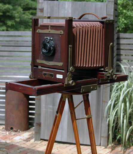

5x7 Eastman View 2-D
I was recently gifted this fine piece (including tripod). Its serial number is 121082. It didn't come with film holders but, that shouldn't be an issue. The shutter still works on the high end which surprised me. The glass was also amazingly clean once I removed the layer of dust! Not sure if this lens came with it or not, the board looks a little different from the body. From reading this post, it must have been from the 1920's (if the numbers apply to all formats, not just the 8x10's). The bellows looked good (just the sunlight test, not film) and with a little TLC should make a come back. I've been shooting 4x5 for the last 25 years so this will be a fun jump up.
If that's a 7 inch lens, you'll need something longer. Nice gift!

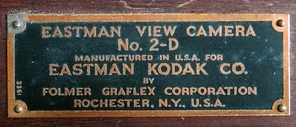

another 2-D for the record
Serial 174725
Eastman View Camera
No. 2-D
Manufactured in the USA for
Eastman Kodak co.
by
Folmer Graflex Corporation

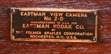

I have a 5x7 2D: Serial # 161257 and an 8x10 Serial # 191257. What are the dates on these cameras?
Thank you,
m
Thank you for the information. I hadn't noticed that the 8x10 is an Eastman View, but that is what it says on the nameplate.
m
161257 listed as a #2D 5x7 in the middle of a batch of 250 made in 1928.
191257 listed as a 8x10 Eastman View, last one of a batch of 7 end of March 1936. There is a work order for #2D 8x10 listed in April.
Your 8x10 is an Eastman View.

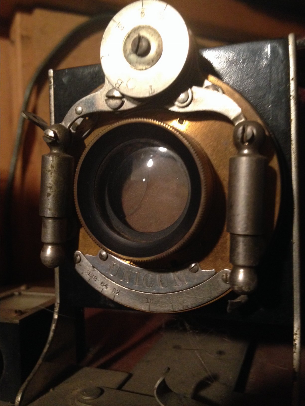

Thank you so very much. I appreciate the info shutterfinger. I recently got this camera that my dad used in his studio when I was a very young child. He passed away 13 years ago and my mom gave me this beautiful camera. It really is a work of art!
I have another camera that I am trying to I.D. but can't seem to find a picture of online. It has a unicum lens F8. Folding camera. Red bellows. leather case outside. It has a black lens mounting plate. In the back the top open and there are metal film plates? Any Ideas what it might be? or where to find markings?

Thanks for the info and links. Lots of great fun information. Appreciate your knowledge
