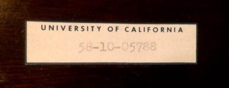

University of California, can out of the UC Berkeley Zoological Laboratory. The interesting thing is that the camera came with two sliding tripod blocks and the are some screws and screw holes that suggest stiffeners between the front and rear standards.
Roger
