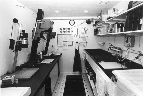

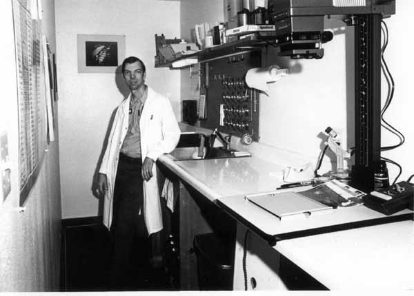

The first pic is me about 20 years ago in my employer's darkroom. This is where I maintained 100's of bank cameras, did all the set up and testing, and processed any film after "incidents". The DR is spartan, but served the purpose. One film, two developers, one paper, etc.

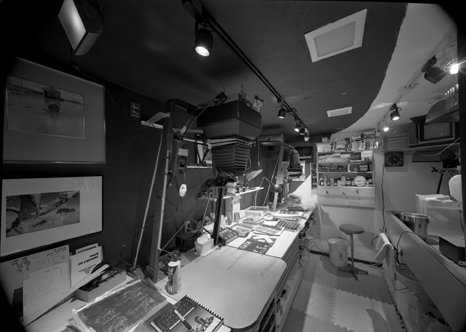

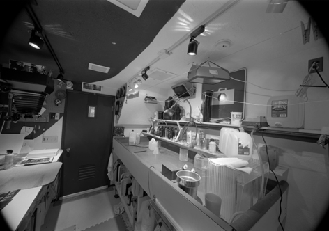

The next two are my current home DR viewed from each end. It's 7 1/2 x 9 feet. Small, but I get 'er done. The 19mm lens makes it look bigger - not to mention slightly distorted. :surprised:
Flanking the D5 are the old B22 and its Chromega B cousin. I could never decide between dicroic and condensor and just kept both. (I bought the Chromega new 30 years ago and the B22 cost $25 about 10 years ago!) One will eventually come down, probably the Chromega B (seems redundant to the D5) :smile:.
The wet side is an 8' Delta 1 sink. I built the stand myself. (Actually, I built the room myself, but that's another story.) At the end of the sink by the door is the print washer. There's a "dorm" refridgerator and a microwave in there under counters. And a lot of stuff accumulated over 35 years of doing this. I've had this DR about 10 years.
It's in a constant state of "improvement". I have a new faucet that I haven't installed yet, for instance. Oh, well, it's a hobby. :tongue:
Hey David, missed this when you first posted...who's the young guy in the first picture? :smile:
Nice looking space, about like mine...but yours is much neater...hmmmmmmm

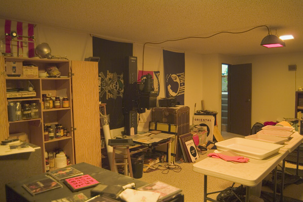

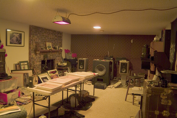

here tiz
It's a darkroom / recroom / all my crap room

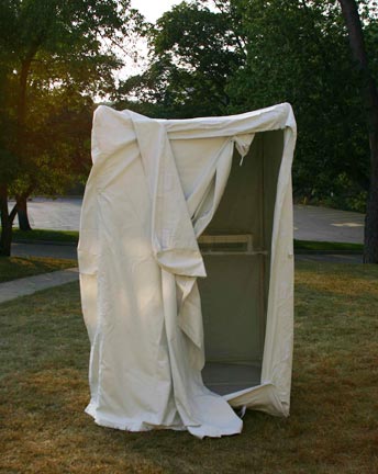

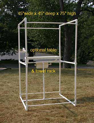

Here's a couple pics of my newly constructed portable darktent for doing wetplate collodion in the field.
The tent frame is constructed of inexpensive pvc pipe and the fabric is lightproof blackout curtain material. Lots of Velcro surrounds the removable inner and outer front doors. I've included an optional shelf scavenged from a cheap modular shelving unit and also have rigged in a paper towel rack. Since these pics were taken, I've also added a removable 12" x 18" red acrylic window in the ceiling. It is very bright inside due to the light tone of the fabric. I can also cover the window with a small piece of the blackout fabric and it becomes a nice darkroom for loading ULF film holders in the field. It also makes a nice big reflector for doing portraits.
The tent measures about 45" wide x 45" deep x 75" high, and eats Harrison changing tents for breakfast. It is roomy and comfortable to stand in. It takes about ten minutes to set-up or tear down. Several of the frame pieces are different diameters and nest inside one another for transport. The disassembled frame fits easily within a Calumet light panel frame bag and the fabric fits a small duffle. For transport, the window (and an 8x10 tray) velcroes to the lightweight shelf.
I used it two days ago for the first time on location and it functioned well. I will probably add a large zipper to the front door to make access a bit easier.

I don't think it would be a problem when I'm printing carbon. Tha lights in the cealing are already yellow bug lights cor carbon already. It might even help when drying tissues. Just too much trouble to move everything to build one, besides I have one in the livingroom and bedroom if I want one.

Just don't try to do wet plates when there's a fire in the fireplace...
Hey, Smieglitz, has it occurred to you that you could probably sell portable darkrooms like that one for several hundred dollars apiece? Not to me -- I don't got that kinda money, and I'm on a first name basis with PVC anyway (right, Poly?) -- but there are lots of ULF photographers who a) find a Harrison too small, and b) seem to have far too much money they're trying to get rid of...

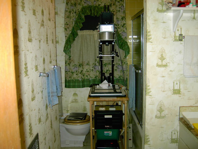

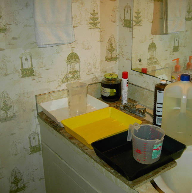

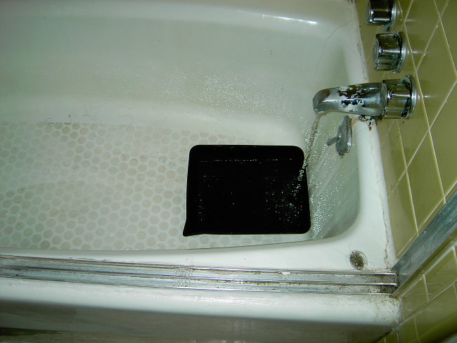

Oh, and what I came here for. I finally managed to remember to take a few pictures of my darkroom when it was set up.
I use the larger bathroom (we have 1 3/4 baths in the house we rent), with a simple slip-in window cover, weatherstrip and matt-board baffling around the door, and a towel to cover the gap under the door. A piece of scrap "engineered lumber", lifted from the dumpster during construction of the house next door, converts one of the twin sinks to counter space for three 8x10 trays, and another tray under the bathtub faucet provides print holding, then in rotation with a second, washing.
The Omega D2V (pictured here with 50 mm f/3.5 El Rodagon installed) sits on a kitchen cart and wheels nicely in and out of the narrow bathroom door, as well as snugly fitting the space between the commode and bathtub. Safelight is via a 50 year old red bulb in a brand new (as of a few weeks ago) reflector clamp fixture attached to one of the shelves I put in to clear bathroom stuff of the counter around the sinks (no medicine cabinet?!); not bright, but adequate most of the time (and, I've recently discovered, bright enough to very lightly fog my RC paper if I have it out for a long time while recutting to smaller sizes, with the light shining directly on the work area so I can read a ruler).
Under the enlarger, on the lower shelves of the cart, you can see my paper safe (3-shelf 8x10, will hold 100 sheets on each shelf -- cost me $10 when a local camera store closed the lab, but the paper inside was thoroughly fogged, panchromatic, or RA-4 type -- turned black in the Dektol). Below that is a snap-lid storage tub the holds negative carriers, lenses on boards or cones, spare cones and boards, etc., and leaves room for trays to stack when stored. Behind the paper safe are my two contact printing frames, set of Kent Printing Masks (about 50 years old, precision cut red construction paper to make neat, even borders on contact prints of various sizes), and storage for the safelight and extension cord.
There are two power strips; one distributes power to the cold light head heater and the other power strip, the second acts as an accessible switch that can handle the current draw of the cold light. Exposure timing is by counting seconds (one-thousand-one, one-thousand-two, etc.), or by stopwatch if longer than about a minute, while hand holding acetate lighting filters under the lens for split filtering. Development timing uses the same stopwatch, actually the stopwatch function of a wrist watch I can no longer wear due to a broken spring pin socket.
My total cash outlay for this conversion, not counting the enlarger and other equipment that will be useful in my next darkroom, was about $20 -- foam core and matt board for the window cover, weatherstrip for the door, and about 1/2 roll of black masking tape used to assemble stuff.
