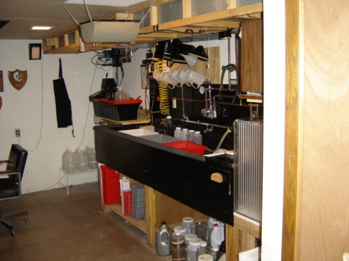

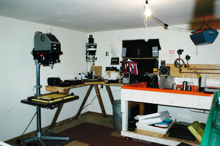

My Darkroom
This is my darkroom as it currently exists. I want to completely redo the wet side to include a larger sink and a permanent wet-print viewing area.
The cabinet the enlarger sits on was built for this room and the six top drawers (four to the left and two to the right of the enlarger) are all light safes that will accommodate up to 16X20 inch paper.
To the right of the sink is a home-built 20X24 print washer.

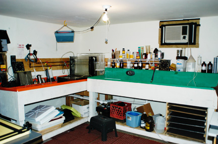

I'm on my fifth darkroom. This time I had to build around the Omega-F. Well worth the extra effort.

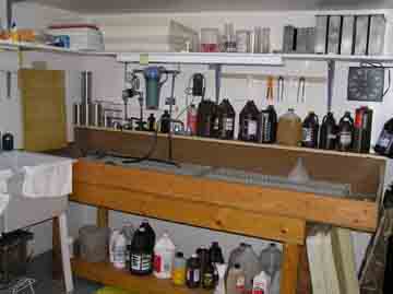

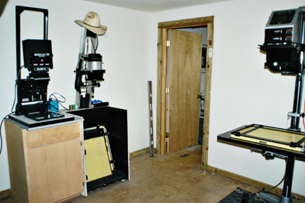

took long enough but here are a few digital attachments that Les McLean did today of my darkroom space. It is not normally this neat.

Oh gee, Lee, is that Les's hat hanging on the D2?
joeyk49
Jan 13, 2004
1,325
New Jersey,
Lee: How many enlarger's can one person use?! Do I count FIVE?!
Or do you have a mad collecting obsession with them...or maybe an enlarger rental service??? I had to find enough room to squeeze my one little Beseler 23C into...you darn near got a parking garage for enlargers....LOL
