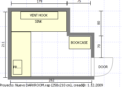

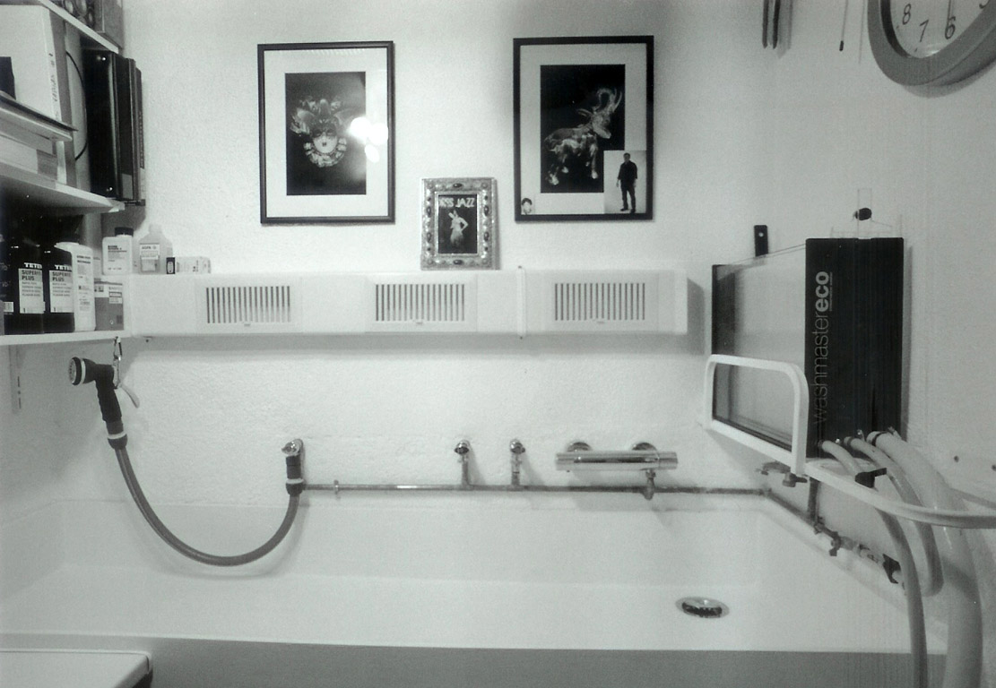

This is my new darkroom, and even though the area is exactly the same than always, I have introduced some improvements. First of all, I have put a wood sink that my brother Saver made for me. It is 1.75 m x 0.65 m x 0.20 m. It has a lot of special resin layers and it has been reinforced with fibber glass. Second, I bought the 12x16 Nova Washmaster-ECO Archival Print Washer and I put it on a metal support above the sink, just at the right hand. Notice that the water do not drain trough the sink, as the hoses go directly to the drain pipe. In third place, I have put a ventilation system. I used a vent that can move more than twenty times per hour the total volume of the darkroom (Just in case, this is the vent I bought: Soler & Palau TD-350/125 SILENT). The air is exhausted trough plastic pipes directly to the backyard. I also bought a 12x12 Doran Heavy Duty Darkroom Light Tight Louvers in Adorama, and I put it at the door.
I keep the rest of the equipment: Meopta Opemus 6 printer, RH Designs Analyser Pro, etc.
Now, I am able to print both RC and Fiber Paper. My Meopta can print as big as12x16, and I can put four trays inside the sink, so I can work with two fixer baths when I make 12x16 baryta base printers.
I am annexing some pictures in order to show you how my new darkroom looks like. They are not very good, but you can see how the sink looks like, the dry side and the wet side, the washer support, the ventilation system, and what things are located just under the sink.
Finally, I want to thank all of you that gave me ideas about how to ventilate my room when I asked for help to the forum, and mainly to my brother Saver, who made the wood sink and help me to put everything in its place.

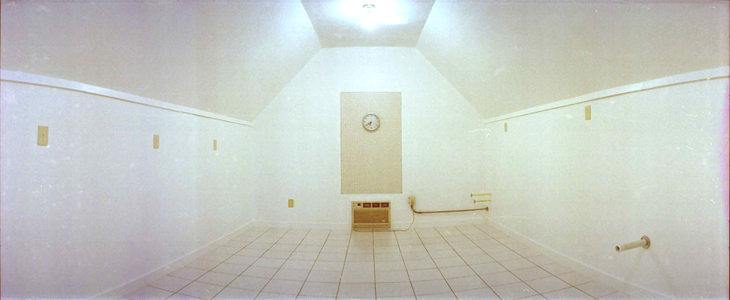

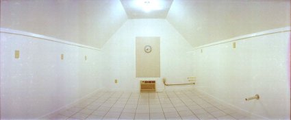

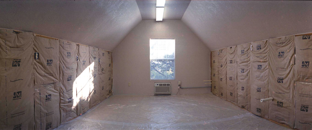

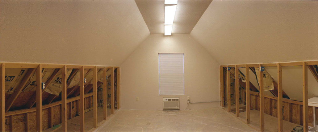

I have finished the construction phase of my new darkroom. I am now starting to install the equipment.
I own a swing-lens panoramic camera. I had never shot color film before with this camera until I decided to do some documentation of the darkroom construction. I had to wait until I finished up the roll and then got it processed. I am just not very practiced at scanning and I am afraid that the results are disappointing. Never mind the color balance from the different lighting. But here they are anyway to show some before and after. My analog printing is much better and that is why I'm building the darkroom! :wink:
All this is being documented in painfully boring detail in the blog in my signature.

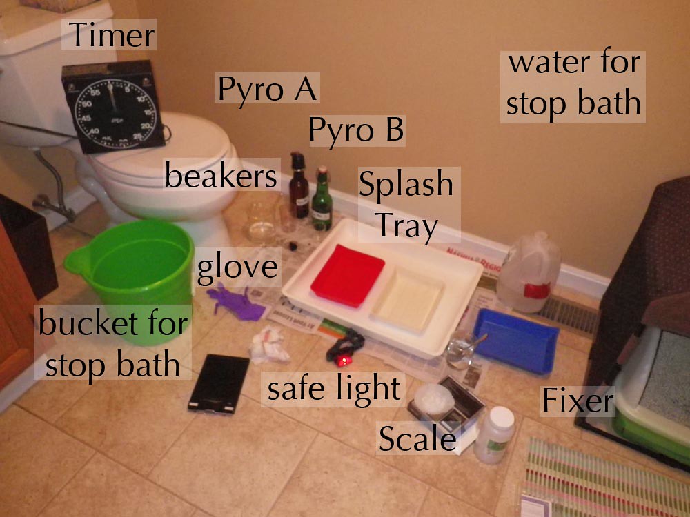

This is my 'darkroom's film/plate developing area. Just out of sight is the emulsion making area, which sometimes is used for doing laundry. Also out of sight is the double trashbag tucked into the window light proofing.
Do I get bonus points for running water AND built in toilet?

Brilliant! This is how I started too. In the family bathroom, many's the time when an irate sibling would pound on the door pleading to use the loo just as print entered the developer. :smile:
Haha :smile: just the cats in my case. We have another bathroom that my parents use when i've holed up

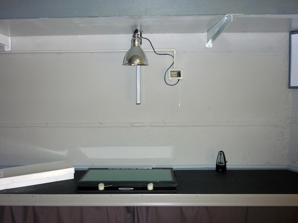

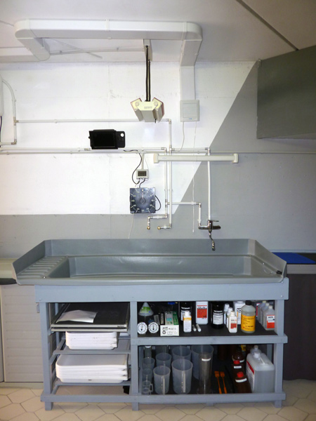

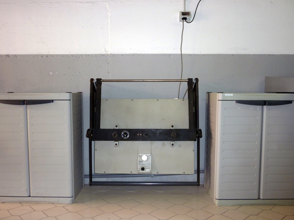

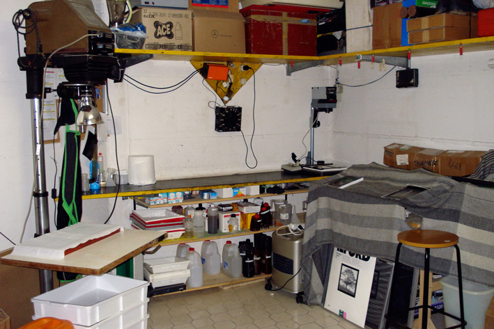

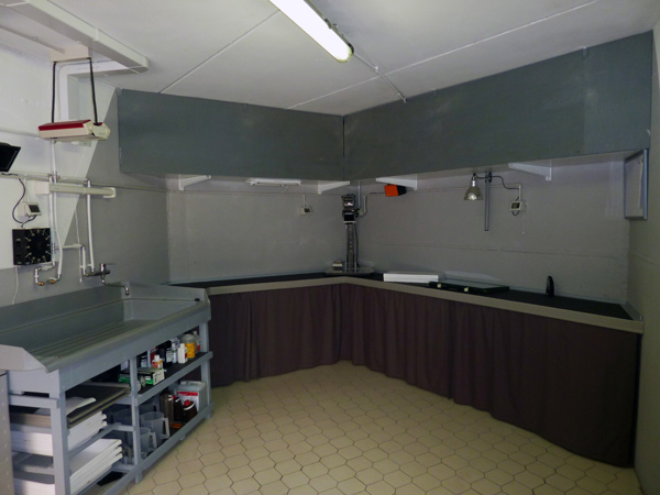

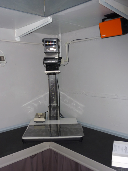

After six-seven months I finished update of my darkroom, in the first photos the darkroom yesterday other photos are the new set up.
The third photos is my contact print exposing with my new Inglis 8x20" contact printer, very useful and well made.
The fifth photos is the wet place, and the sixth photos is my press mounting on the wall to save space, now a my friend has almost finished the mechanism to up the press only by a finger.
I have also an enlarger, a durst m605 colour, sometimes I have to print old negatives, even if now all my work is done by 8x10 and 8x20 and contact prints.
