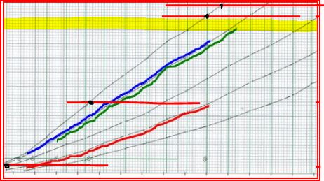

I was surprised how this graphed. Actually looks like you might have developed the film longer than I thought. Did you use D76 straight?
The solid horizontal red lines are your measured densities (I subtracted 0.20 because it "felt" like that might be your Base+Fog... is that a good guess for your density of the totally clear area of film?).
I guess that the curve is steep, so I placed black dots where your actual densities cross this steepest curve. If I'm wrong about which curve, then the dots might belong at the intersection of the red horizontal lines on another curve... Your meter readings would give clues to the horizontal position. The meter readings you gave are a little hard to place, so I didn't draw vertical lines to finish the illustration.
The highlighted yellow is about the highest density you would normally want for Silver Gelatin (darkroom) printing. So your highlights are higher than you want. But your shadows are still too low in density (barely and debatably).

Yes I used D76 straight @ 20 deg C for 9 minutes. Also, I think my developer might be a little stronger than normal due to the fact that the overall volume after mixing was left to 3 litres rather than 3.8 as recommended, I am not sure what happened (maybe some water got evaporated during boiling) although I did use 3 litres to start with and then added 0.8.

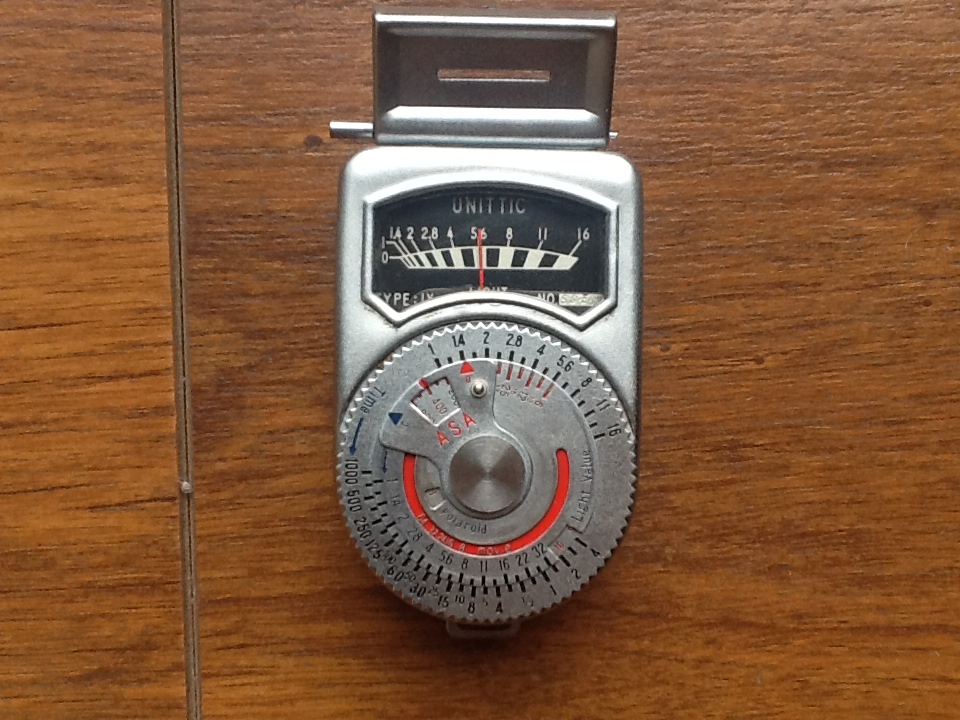

The meter readings I sent are from the following meter and they were positive values with a dash before every value to separate from text:

Also, please have a look at my meter, and teach me how to read it. There are a lot of things on it, such as light value in red etc. The above suggestion is my humble request to an already very patient teacher, however, if you feel that it would not be possible for you then I would totally understand - you have been an outstanding help already.

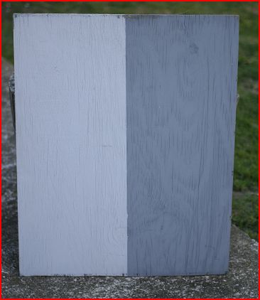

Assignment: Photo test target project.
After reading Minor White's booklet about the Zone System, I created a test target he specified that meters one full f/stop different from medium gray to light gray. You could do the same. Or make a target where your light meter reads more - maybe two or three stops different from darker to lighter gray. (You can't expect to get more than 5 f/stops difference from black to white). I asked the hardware store for a small amount of black pigment to go with the white paint I bought. I made the quart a light gray. Painted half the board. Then added more black pigment, painted, checked, added more black, painted, checked etc. until I had the board so after it dried the meter reads one f/stop difference from side to side...
This is what mine looks like...
Then anytime you feel like it, take one picture of the board. Then finish the roll of film with portraits or any other photography. Just don't waste the whole roll on tests. I very often mix film tests with real photography this way.
The difference between dark and light will show up when you check it with your "Densitometer" and it will tell pretty well what contrast you developed the film to.

Raffay, The specific gray values do not matter. But if you make the lighter tone about the same meter reading as the palm of your hand... Then it will be a nice agreement with "Zone VI" that will make it easier to see things on the graphs.
