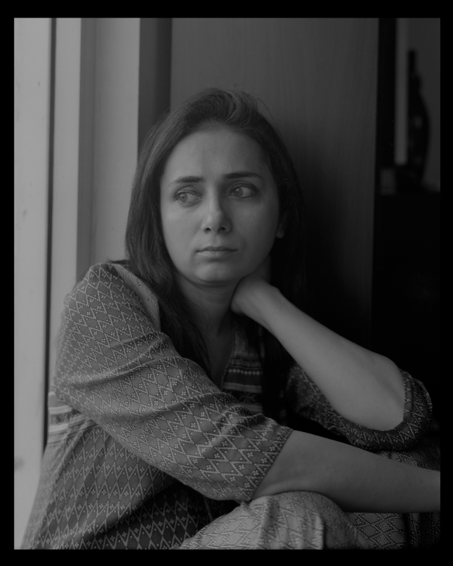

Hello All,
Finally developed in D76, my first time. I liked the results!!
Kodat T-Max 400, tray developed in D76 for 9 mins at 20 deg
Raffay. Congratulations. It always feels good when something works.
If I could make a suggestion, to me it would have been even nicer if the picture had been a bit brighter. Let some more of the gorgeous light in. Maybe open your aperture up a stop, or even two, next time.
Hi Raffay,
Always great to see your photographs!
Did you use D76 straight? Or mixed with water 1 part D76 to 1 part water?
Your earlier negatives were thinner. This looks like you have better quality, maybe even "perfect" according to standards (using the best part of the film for the part of picture that people see - the midtones and above).
Now that you have high quality you can ask yourself this question: Does this meet your preference? If you wish more detail in the shadows (a non-standard quality that I personally like) you might expose the film at EI 320. Or you might develop longer (that's why I ask about straight vs. 1:1 because my personal development time is 1:1 for around 11 to 13 minutes but if you used the developer straight 11 minutes would be too long).

I think, and as you also mention, the quality of the negative is much better one that I have at least not seen before. As far as light, I am not sure if it is scanning, PS or conversion to jpg issue. Lets discuss these one by one below:
1. Scanning: When I scanned I set everything to default in VS and the colour management was neutral, film selected as Kodax 400 and the dev D76 CI .40 I am not sure what CI .40 is. At that setting the picture was was way too bright. Then I selected "None" at the top and Generic and it was good, I scanned it and it came out very nice.
2. After converting to jpg it is turning dull, I had this issue again as well
What are you basic VueScan settings if you scan, that is another reason I want to try 8x10 and do contract printing and do away with this scanning workflow. Please see my post 8x0 on a budget and share some thoughts.

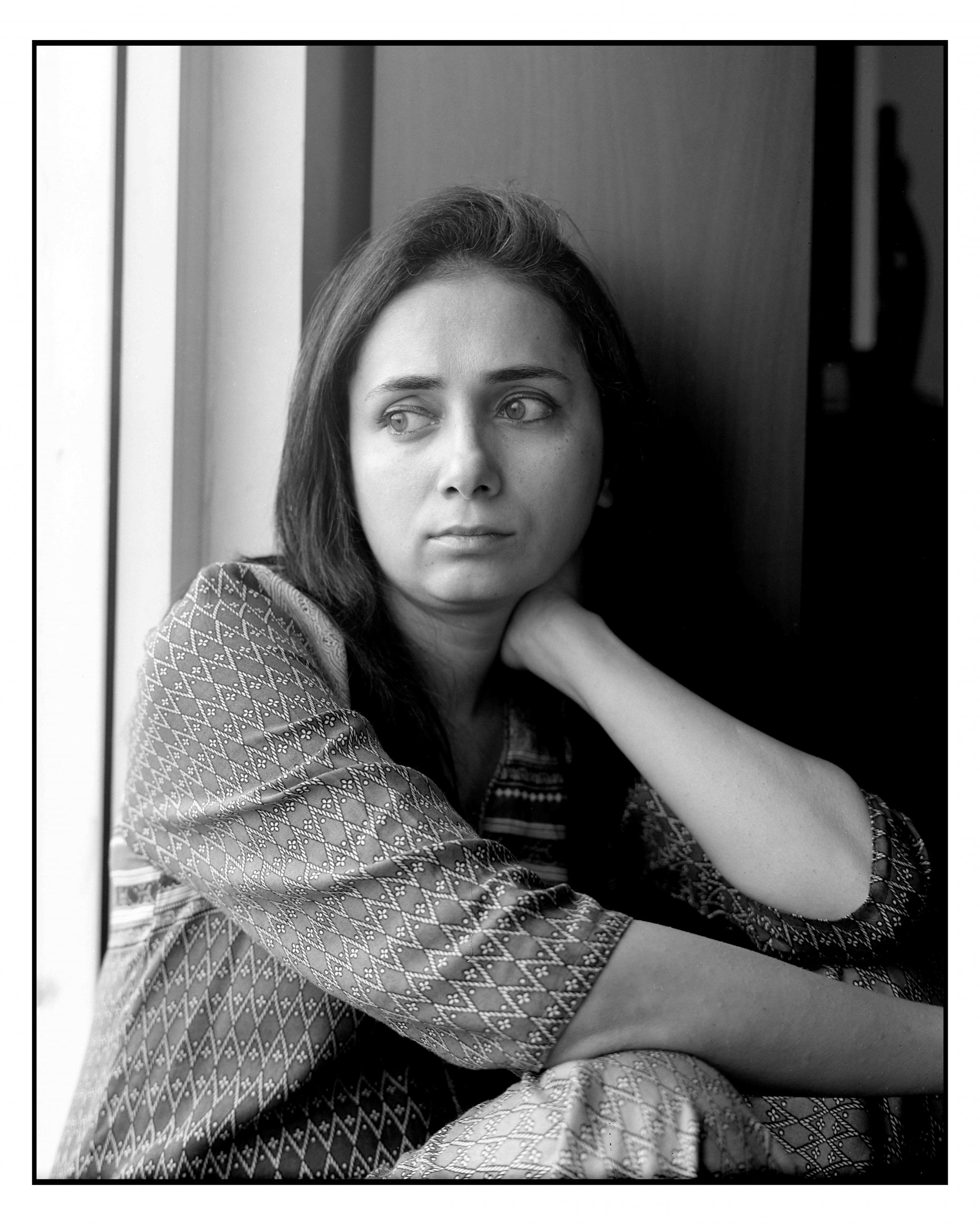

Another try, reviewed all the comments I got in my earlier help with scanning post and I believe this one is a better sample than the previous one.

Whatever you did seemed to make all the difference on my monitor anyway. A very well framed picture to start with and it is much lighter now as well. The natural light is very visible.

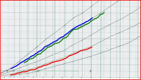

Referring again to the diagram of film curves, your earlier work was on the red line. Now you are at the blue line. You exposed minimally (maybe used 400 speed setting). I notice it in your subject's hair on the dark side away from the window. There is slight hint of detail for some hair can be seen. This is ideal by many standards of excellence.
But the negative doesn't have much more to reveal. You could look at the negative and see that part of the negative is probably really clear. So increasing exposure the next time you take a picture will take you from the blue line to the green line. Then if you wanted to show more detail in the shadow, it would be on the negative.

I am completely lost with these curves, I am sure it is my bad that I am not being able to grasp a simple concept. I have read your earlier post explaining the concept using a mountain trail example but still it is not clear to me how to interpret it. Forgetting the curves for the moment if I try to understand it as a basic concept then I should have metered the left side hair and if I think that the shadows are a zone three and if I want to show some details then I should open the aperture or decrease the shutter speed by one whole stop to bring it to zone IV that will show details on the hair that are away from the window. I am not sure of the exact readings but that might blow the side of the face facing the window. Then when I try to adjust in PS it comes back to the same situation where shadows are dark and the blown highlights don't look blown but has no good feel or details. I am quite sure I am missing some basic point in exposure area, and I really hope that I understand quickly what you are trying to teach me.

Highlights don't get blown out on black and white negative film like they did back in the days of Ansel Adams and the Zone System.
If you take two pictures, normally expose one (blue line) and overepose the other (green line). Develop them both exactly the same as the portrait you started this thread with. Then print (scan) them with the same settings only "change the brightness" to match - without changing the contrast... Then the pictures will be identical... Except the overexposed negative will have detail in the shadows that you can do something with.
p.s. On the graph, 15 divisions is one f/stop.

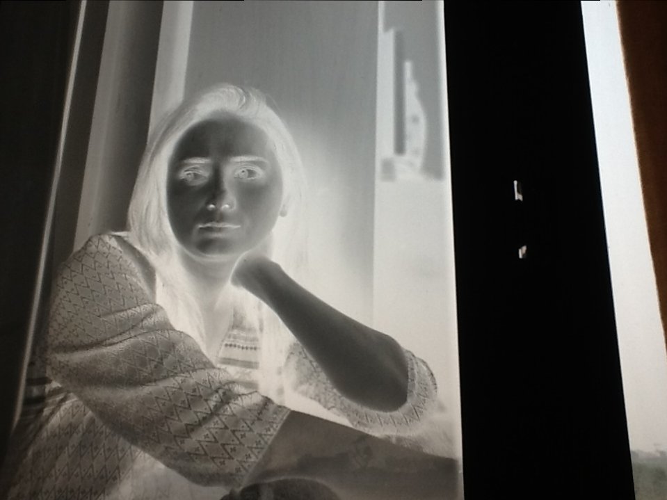

Here is the negative, do you think the shadow areas have some detail or the detail is completely lost? I am not sure why is it coming upside down.
I have an idea that may help get us some numbers...
You use VueScan, which has a preference setting that allows you to read density values from the negative.
Prefs, Enable density display.
Then use the Ctrl key to read out densities.
Let us know some of the density readings and how they relate to your measured light readings. Density readings go right to my graph...
Window frame is 1.40
Brightest side of face 1.30
Dark side of the face 0.70
Darkest area below the left ear 0.26
I have no idea what this all means :smile: but its fun...
