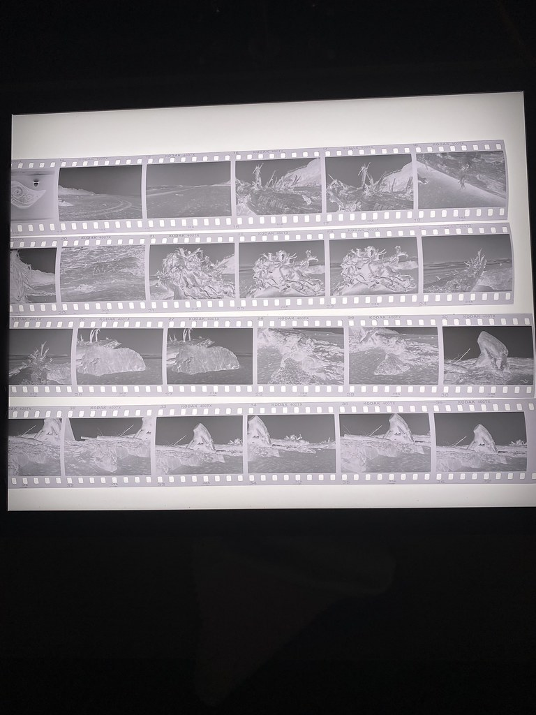

Very nice scan in madnbad in #27 as well but if this was done on the same scanner in the same way as your earlier driftwood logs then it doesn't look any better than those scans to me but this was at 125ml per film in terms of minimum quantities compared to the driftwood logs which were done with 2 rolls at 480ml at 1+3 so about 60ml per roll
Given what you did in 27 compared to #10 what changes if any were made to the scan qualities. It would be interesting to see what the negs look like compared to the driftwood negs on the same I-phone to ensure continuity
Thar might tell us if in a darkroom a print would be as easily printed of the driftwood negs as of the Dambo Troll
Thanks
pentaxuser

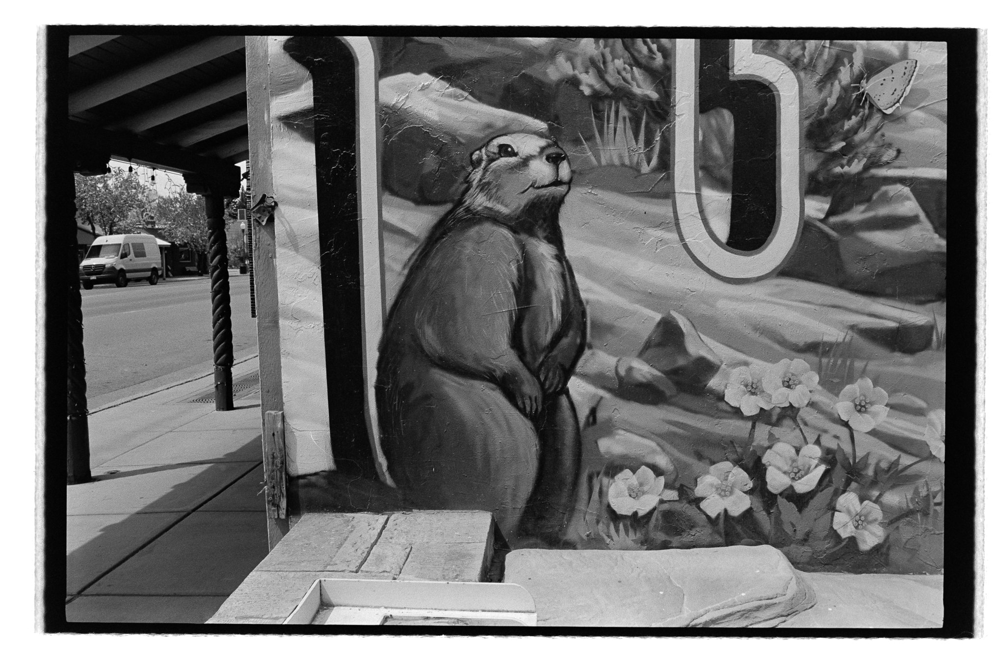

Both were scanned with a Sony A7II using a FE90 2.8 macro, Negative Supply Pro Carrier 135 and a 5X7 Lightsource Pro 95 CRI. Post processing was with RAWPower by Gentlemen Coders. Since these, I've switched to Negative Lab Pro. The driftwood was a 1:3 dilution of Film Photography Project FPP-76, the Dembo troll was in FPP-76 at 1:1.
Just to confuse things, here's a recent one. M4-2, Voigtlander 35 1.4 Nokton Classic SC V2, Tri-X @ ISO 400, Adox XT-3 1:1, same scanning set up, post processing was with Negative Lab Pro, Linear Gamma profile and no other adjustments:
Plaza detail, Gunnison, Colorado:
