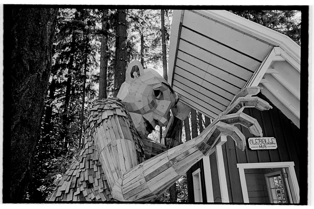

I tried a single roll of the FPP-76 1+1 for 10 minutes at 20c as recomended by the Kodak data sheet. Did two rolls in a single 480ml tank using FPP-76 at 1+1 today but increased the time to 12.5 minutes. I think I'm finding what works for me.
Dambo Troll, Swedish Consol Grounds, Metzger, Oregon
M4-2, Voigtlander 28 2.8 Color Skopar V2, Tri-X @ ISO 200, 022 yellow filter, FPP-76 1+1

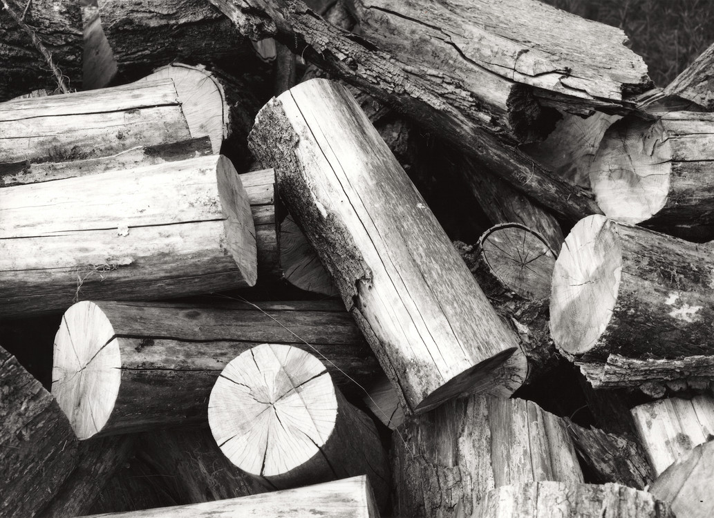

I solve this problem by semistand processing with higher dilution developers. It gets you to full shadow speed and has a noticeable highlight compensation effect. I usually open tank process, though, in 2 liter rubber tanks so I never have to worry about developer capacity or aerial oxidation during the hour that the film is in solution.
Having done this with a wide range of films and developers, I will say that I get better results from non-MQ developers like D-23 and Pyrocat. When I tried highly dilute DK-50, for example, I got contrasty prints without as much highlight compensation as I would have liked. Then again, this may be selection bias. I have done way, way more D-23 and Pyrocat extended development than I have DK-50.
You can actually superdilute D-23, DK-50, and probably, D-76. I've taken D-23 out to 1+9 by adding 0.5g of lye (sodium hydroxide) per liter of developer to keep the alkalinity cranked up. This works really well for larger formats but the grain can get to be obnoxious in 35mm.
Here is 35mm in D-23 1+9+lye. Notice that you get both good shadow detail and controlled highlights even though the sun was just pounding down on the scene. You either like this look or you don't:
By way of comparison, here is a 9x12cm negative processed the same way. In fairness, the image above was shot on Double X, and this one on Fomapan 100, so it should be less grainy inherently. Still, the sharpness is pretty amazing:

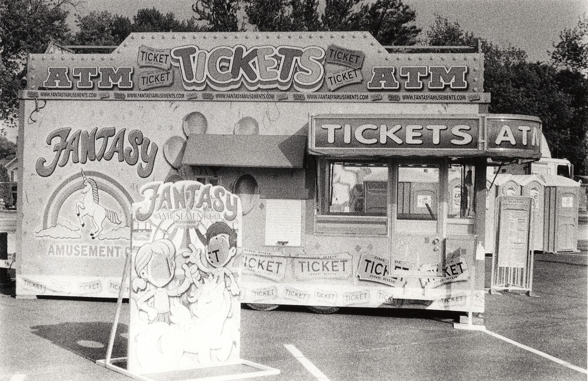

Take a look at the picture of the ticket stand I uploaded in post #37. The light was just blazing on those white foreground surfaces, but the distant trees were in fairly deep shadow. A long, highly dilute development protected both nicely. It also created a lovely mid-tone local contrast.
With conventional dilutions and normal development, I would have had to increase exposure a bunch (reduce EI) and then underdevelop (N-) to hold the shadows and highlights respectively. But that would have collapsed the mid tones into a boring gray. I spent years chasing better negatives using Zone system exposure and development controls and never consistently got what I wanted. It wasn't until I understood better how film works, and how you have to control for shadows, midtones, and highlights properly when developing that I started getting better results. Long, dilute, low agitation schemes were a path to this.
I hasten to point out that this is not something that is appropriate for all subjects. For example, I would not do portraits this way.
