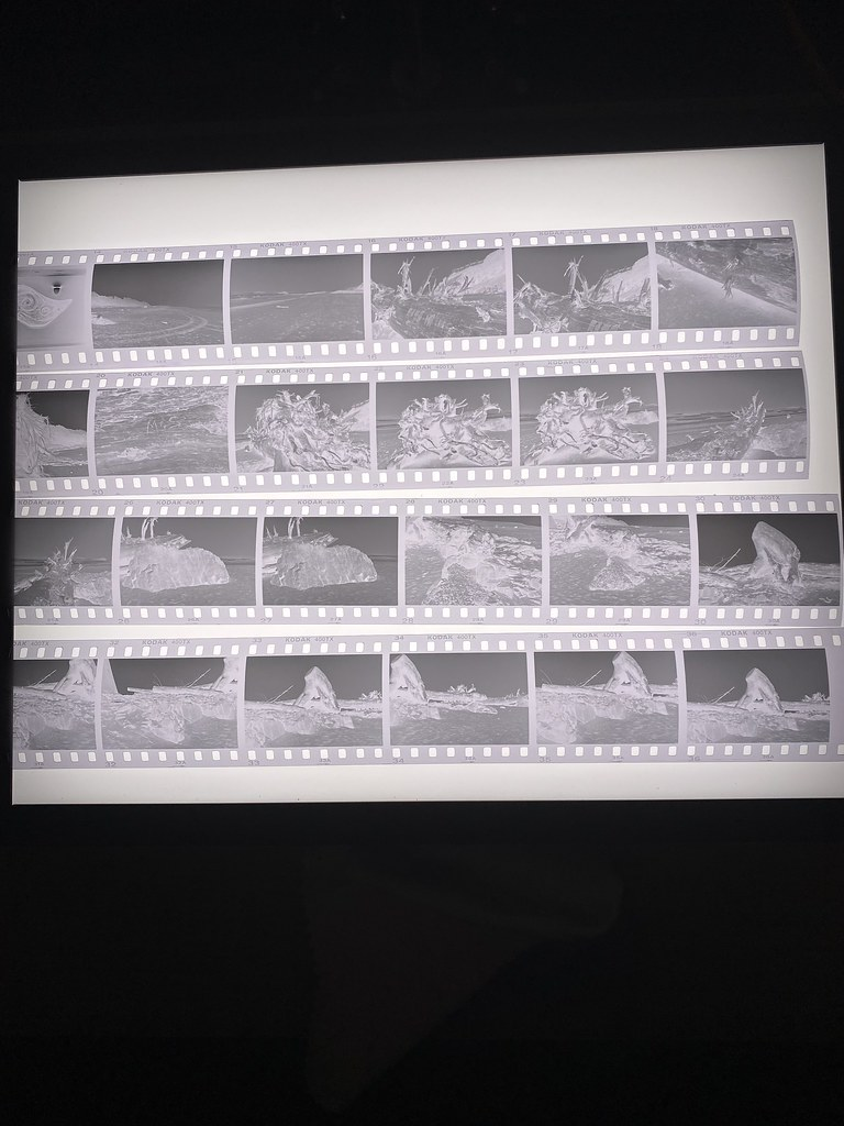

I decided to revive this old thread instead of starting a new one. Having developed Tri-X in Rodinal for the last year, I wanted to try a different developer. I tried Ilfotec HC, didn't like it and gave the bottle away. I've been waiting for Adox XT-3 to become available in the U.S. but that won't be until the end of October. I ordered a couple of one liter packages of the Film Photography Project's D76 clone. I had been reading about how dilution changes the characteristics of D76 and wanted something that would give good sharpness like Rodinal but buffer the grain a bit. I did two rolls yesterday and was impressed with the results. The negatives are easy to scan and offer good tonal range. The grain is apparent, sharpness is better than I expected. Any opinions on this dilution?

Made a one shot batch, 500ml. 125ml of stock developer to 375ml of water. 20 minutes at 20C, agitations every minute. Two 36 exposure rolls in the tank. At this rate, it should be good for 16 rolls per liter. This way, I can use up a liter of stock before making up the next batch. I don't use it fast enough to keep a gallon around but can finish off a liter well before it expires.

125ml of stock developer is less than 1/2 of the stock developer that Kodak recommends for two 135-36 rolls - even with a 10% increase in time. You are likely incorporating some localized developer exhaustion for some of your rolls.

Thanks, Matt. I've been reading through the Kodak data sheets and doing a lot of searching on the web. I never planned to use it full strength and 1+1 was going to be my starting point but when it came time to do the first rolls, I decided to give the 1+3 a try. Here are a few crummy iPhone photos of the negatives. I should have used my wife's 14, it has macro:
My task is to use the stock before it becomes exhausted. Kodak is generous with the storage times but I aiming for three months to finish the liter. I may do the next batch in 1+1 and see how they look. I appreciate your knowledge about Kodak products, thanks again for pointing it out.

Just put a single roll in that 500 ml tank of 1+3 D76 and you will be fine - provided you add 10% to the recommended times.

Following Matt's advice, I went back and read Kodak's data sheet for D76 paying careful attention to the quantities of films each dilution has the ability to develop and life expectancy of stock developer. According to the data sheet, it's safe to do two rolls of 135-36 in 480ml tank using the 1+1 dilution and adding ten percent to the time. Next two rolls, I'll follow the recommendation and hopefully stay with it.

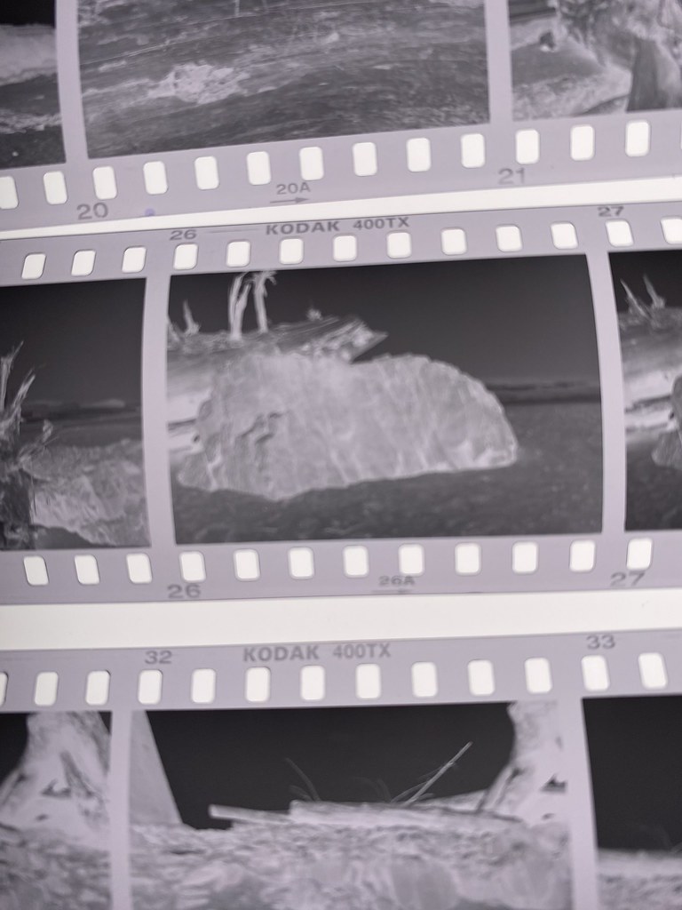

To me, these look like the result of partially exhausted developer:

Maybe for scanning the density range is good.
I've always wondered what the difference is between controlling contrast by limiting time and controlling it by allowing the whole tank of developer to become exhausted. I'm not referring to local exhaustion due to less agitation.

Exhaustion effects tend toward the uneven and "local".
I would say that the negatives I linked to may be easier to "rescue" if you are scanning, but that if you had more density and contrast, you are likely to get better scans.
