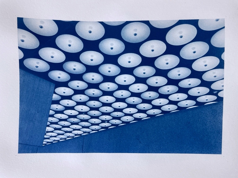

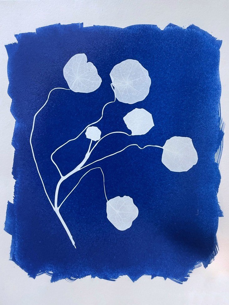

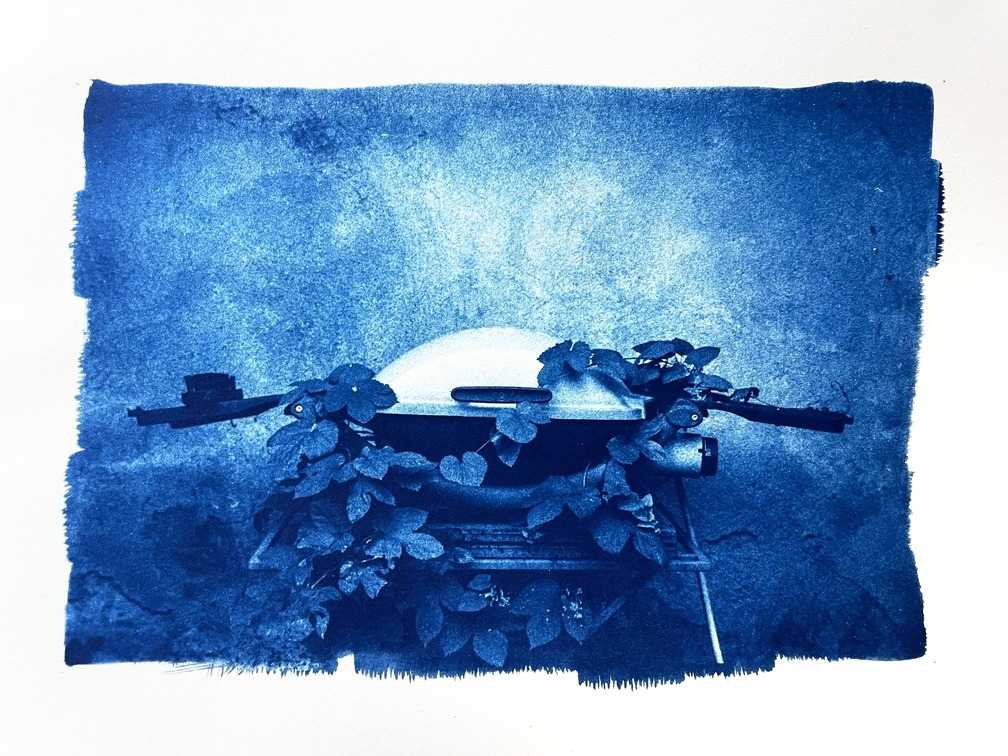

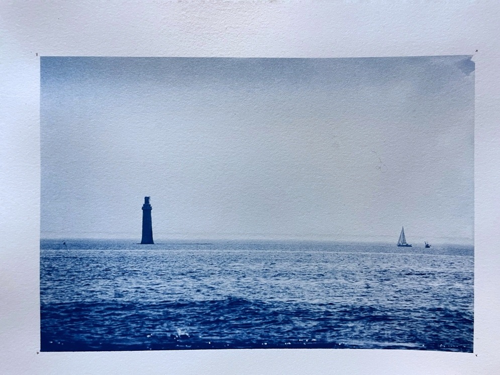

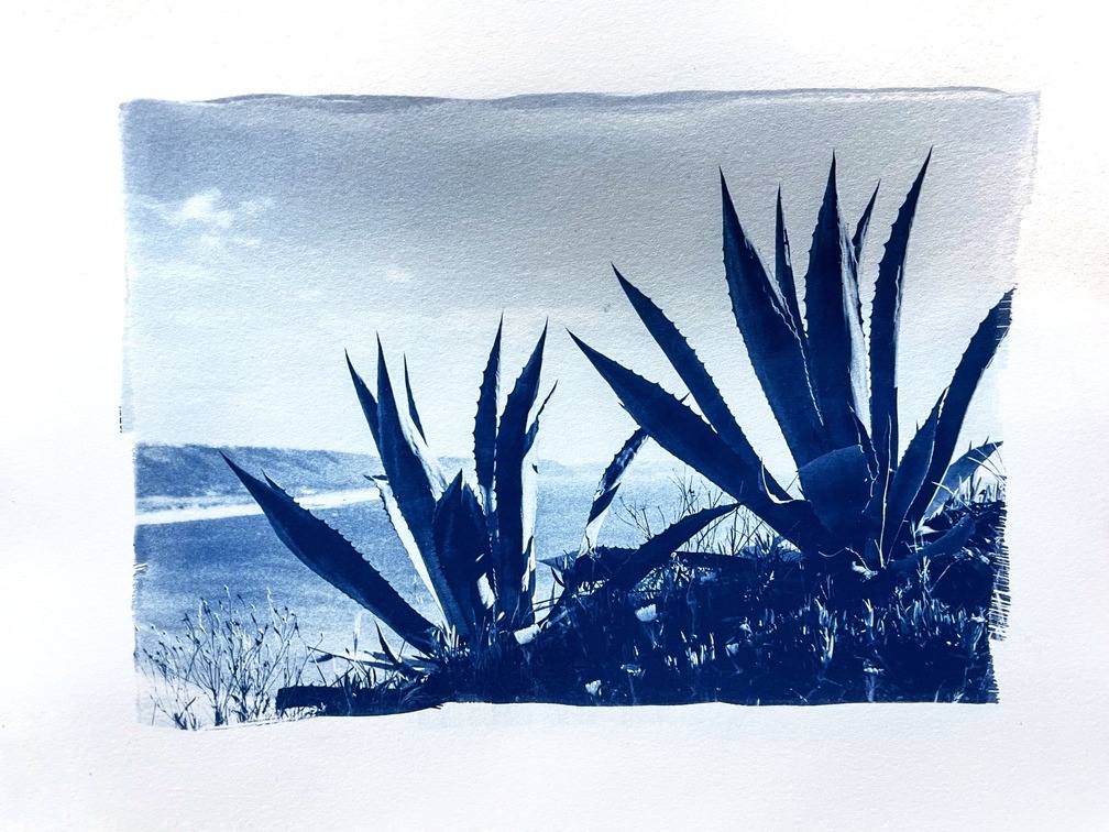

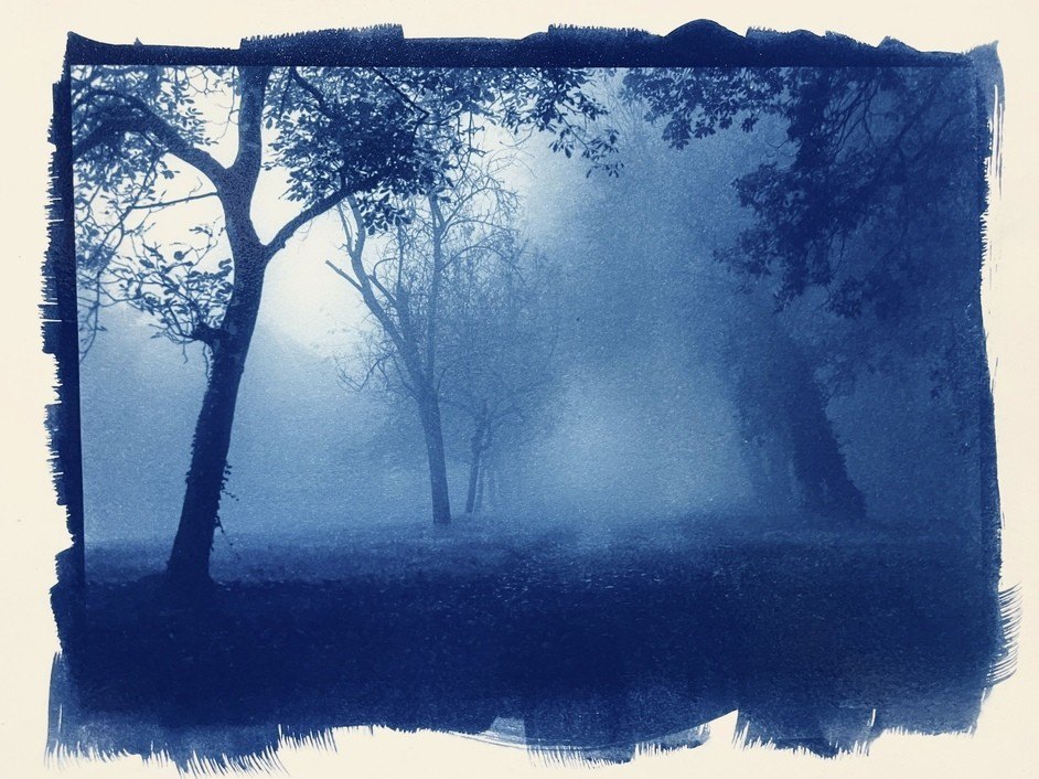

Here are some of the prints the workshop attendees made...
The print with the trees in the mist was made with Mike Ware's Simple Cyanotype, and the exposure lasted 47 minutes!
The photogram of a plant was also made with Mike Ware's Simple Cyanotype and the exposure lasted 24 minutes (because no negative)
All the other prints were made with a classic A + B formula with an exposure time of 18 minutes.
(Note #1 : these are not scans, but pics quickly took with my iPhone, so the white balance for instance is not corrected)
(Note #2 : The pic of the barbecue has a very textured wall behind)
Nice...seems it was worth the wait.
Rest of them are lovely too.
Did you end up changing the distance in the box?
:Niranjan.
nmp
Jan 20, 2005
2,101
Maryland USA
Thanks (these are not my photos, but my chemistry and alt processes practice :smile:
Yes, I roughly halved it.
It's a bigger compliment to the teacher when students do well.
So did lessening the distance make it speedier? 18 minutes is not so bad. it is actually better than what I get for classic chemistry. I am surprised SImple is so much slower - I wonder what Mike Ware's data show.
