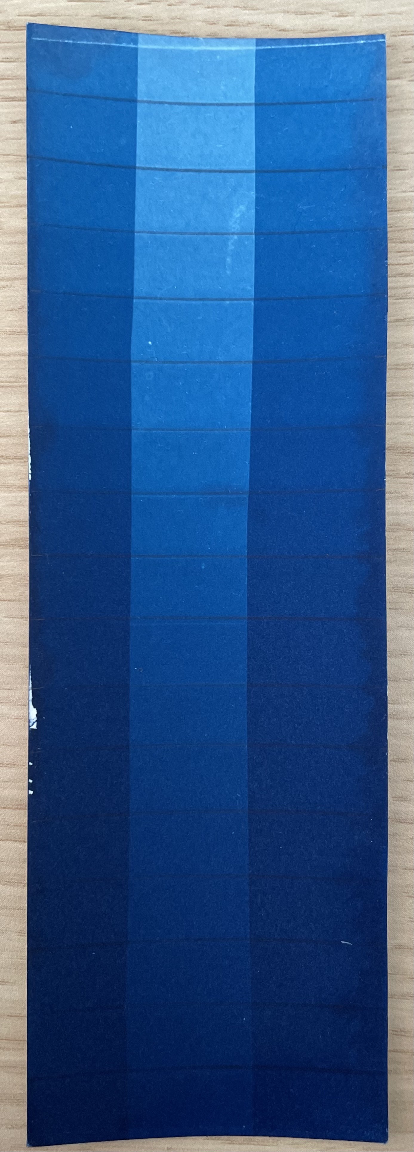

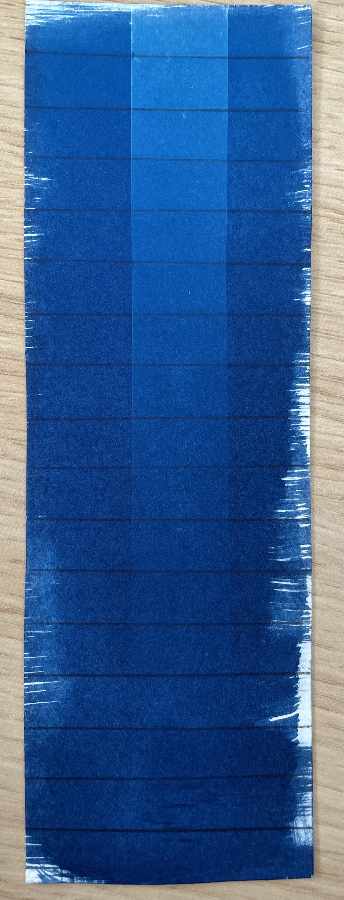

Hello !
I am returning to cyanotypes (after a decade of not doing it), so I am re-calibrating my baseline exposure time by gradually exposing a test strip...
I am testing two formulas:
- the 1842 "original" formula in two bottles A + B
- and Mike Ware's "New Cyanotype" formula of 2019 (see https://www.mikeware.co.uk/mikeware/downloads/SimpleCyan.pdf).
I am very happy with these 2 formulas, especially the Simple Cyanotype in one bottle which gives very dense and smooth blue shadows !
Nevertheless, I am very surprised by the extremely long exposure time to reach the densest blue under a digital negative, with both formulas !
After 1h20 (!!) of exposure under my UV light source (8 UV tubes), I still do not reach the maximum density (the deepest blue)
=> see the attached scans of the test strips, the lighter area in the middle is the one under a transparent OHP film strip. The darkest step has been exposed for 1h20min !
Now, you are going to tell me that it depends on my UV light source, I agree, but all other things being equal (paper, brand of OHP transparency film, exposure unit, distance source<->contact printing frame), my basic exposure time for kallitypes or platinum / palladium prints is around 12 to 15 minutes only... !
My questions are the following:
- Is it normal that cyanotype is so slow? I have the feeling that I will have to expose my cyanotype prints for 2 hours to reach the maximum densities..... !?!
- Moreover the New Cyanotype is supposed to be faster than the "classic" cyanotype, but I don't see any difference? How to explain it ?
Thank you very much in advance for your feedback, advices & tips !

No, but if I look at your test strips, the chemistry isn't very slow. The problem seems to be that your OHP film blocks a lot of UV. What kind of film are you using?
I have the impression you're mixing up New Cyanotype and Simple Cyanotype. They appear to be different things. I don't know about the speed of Simple Cyanotype, but I can confirm that New Cyanotype is much faster than Classic Cyanotype.
I am currently using Novalith NLA4/TPX25 (thickness of 165µ). I also tried Pictorico OHP Ultra Premium TPS100, but it seems to be even worse (even more milky white, but same thickness). I also used to use Pictorico OHP TPU100 for kallitypes and platinotypes, but now it is discontinued. Ten years ago, (with the same UV light source), I was using PermaJet transparent film for cyanotypes iirc.
Sorry, I meant Simple Cyanotype (2019 formula from Mike Ware). I am not using the New Cyanotype (1995 formula from Mike Ware) at all.

I have the impression that the problem comes from the transparent film (or even from the combination of transparent film + specific wavelength of my light source), because on the edges of the test strips where there is no transparent film on top, the maximum blue is reached in about 25 minutes, which seems to me quite (or at least more) normal...
Maybe I should test in full sunlight to see if it's a wavelength problem for these transparent films... The problem is that I'm teaching a cyanotype workshop this weekend with this UV sunlamp :sad:(
New Cyanotype and Simple Cyanotype are not the same thing. I would expect exposure times to be similar between "Classic" and "Simple", since both are based upon ferric ammonium citrate, as opposed to ferric ammonium oxalate in "New".
I don't really understand your step wedges. Maybe all patches are overexposed? Too much exposure will give you weaker blues.
Bronzing occurs, but tends to disappear in properly processed prints. There's no sign of it in these test strips, so I don't think this is the problem.

Just to make sure I understand correctly, what are we looking at here:
- A clear OHP strip and varying the exposure time by using a cardboard
Yes, this is it ^^

- A density-graded OHP strip and a single shot of 80 mins.
:Niranjan.
No ^^
But why are there no light tones in the step wedge then? I think it's overexposed.

In that case, I would tend to concur with the preliminary conclusion that the transparency is the culprit here. If you look at the two strips, the areas w/o transparency seem to be getting their Dmax fairly quickly, particularly the first one where even the first step is fairly close to the rest of them. Generally, if I remember correctly, there is about 20% loss in intensity with these transparencies. There were some measurements in a report somewhere, but I can't find it.
Because the first step is already significantly exposed. That doesn't make anything overexposed. This was apparently a test to determine the exposure needed for dmax. As such it doesn't need light patches.
Besides, there's a distinct gradation from medium to darker patches in the center band, suggesting that there's no solarization-type effect where increased exposure results in decreased density. Nothing in these patches suggests that overexposure is part of the problem.
In that case, I would tend to concur with the preliminary conclusion that the transparency is the culprit here. If you look at the two strips, the area w/o transparency seem to be getting their Dmax fairly quickly, particularly the first one where the first step is fairly close to the rest of them. Generally, if I remember correctly, there is about 20% loss in intensity with these transparencies. There were some measurements in a report somewhere, but I can't find it.
Well we disagree then. To me there are clear signs of overexposure in the CC test (at 1:20h!).
A test with a stouffer wedge or a negative with a full range of tones would give much more information in my opinion.
- This is a test to determine the exposure needed to reach the paper+chemistry dmax under the transparent
- I am not using a density-graded OHP strip and a single shot of 80 mins,
- I am using a clear OHP strip and varying the exposure time by using a cardboard.
- (If you do prefer math :smile: The n-th step received an exposure of En = 5*2n/4 , n in { 0, ..., 16 }. Consequently the first step received 5 minutes of exposure. And the last (n=16) 1h20.
I thought I would see signs of solarization, but apparently not.
But anyway, my problem is not a problem of over-exposure. But, of course, 1h20 is way too long for practicing cyanotypes.
Based on what visual clue(s)? Not trolling, but genuinely curious, as I just don't see it!
Immediately after exposure and before processing you should definitely see solarization or bronzing in the form of a grey, low density image. This will disappear upon further processing and consequently drying; I think treatment with peroxide might help too.
If you don't get any bronzing/solarization, you're either giving insufficient exposure (unlikely) or there's something weird with your chemistry and/or paper that inhibits Prussian blue formation. I'm getting a feeling we might have to start looking in that direction.
Do you see the increased graininess and slight loss of color with more exposure? That looks like an overexposed CC print to me.
Just because density is increasing doesn't necessarily mean more exposure is better. Maybe 5h will give slightly more density?
This test seems like a rabbit hole. Why not try to make a good print instead. Then if you're not happy with the maximum density when you print, maybe the paper you are using is the problem, or how you develop etc.
