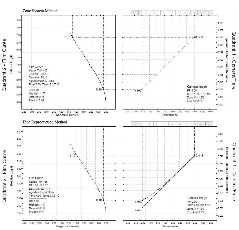

Let's approach the problem from a different direction. The aim negative density ranges for the example are 1.05 for the tone reproduction approach and 1.25 for the Zone System but that's not the only way to define a negative. There's the film's Contrast Index. To determine what each method considers the aim Contrast Index only requires information about what they considered to be the normal scene luminance range and to plug the aim negative density value and the scene luminance range into the equation for slope - Rise / Run or Negative Density Range / Scene Luminance Range.
For the ZS, it's 7 stops or a luminance range of 2.10. The slope, or film gradient, or equivalent Contrast Index would be 1.25 rise / 2.10 run.
1.25 / 2.10 = 0.595
For Tone Reproduction, the average luminance range is 2.20 which makes the equation:
1.05/2.20 = 0.477
Except Tone Reproduction factors in flare because it actually uses the scene's illuminance range at the film plane. When you develop the film, you are generally developing it for a stop shorter range than would be indicated by the scene's luminance range.
I don't want to confuse anybody, but the average flare is generally considered to be from one stop (0.30) to 1 1/3 stops (0.40). One stop is generally used in the standard model for film speed, but when calculating the scene's illuminance range it is generally either 0.34 or 0.40. Kodak has been using 0.40 for at least the last 30 years, so the equation for slope, gradient, approx CI would be:
1.05 / 2.20 - 0.40 = 0.583
The film gradients for the two methods are almost identical. Which means that whatever the scene's luminance range is the resulting negative density range will be the same for the two methods even though they have different negative density ranges for their aim. If you want to factor in the 1.20 negative density range from the AA quote provided by Chuck, you get:
1.20 / 2.1 = 0.571
Which is just on the other side of 0.58 or practically identical gradients which would yield almost identical results. I've attached two graphs from a tone reproduction program I'm currently writing illustrating how this works except that I've simplified the variables slightly. Instead of using a 2.20 scene luminance range for the Tone Reproduction example, I used a 2.10 luminance range and a one stop flare factor which has the same results as using 2.20 - 0.40. The "HR" value under the "Camera Image" heading represents the scene's illuminance range at the film plane: 2.10 for the non-flare, ZS model and 1.79 (rounding problem) for the Tone Reproduction, one stop flare model.
So, the problem turned out to be two valid but different methods of evaluating information. Technically, both factor in flare, but only with the Tone Reproduction is it apparent.
Even though the testing of the negative for the ZS method is in camera, the conditions produce little to no flare (yes it's a myth that testing with one's camera equipment incorporates shooting conditions), so the test is "comparable" to contacting. The aim negative density range from the testing isn't what the resulting negative density range will be in actually use. The reason why this is missed by so many people was described earlier by ic-racer. It's hard to read the pictorial negative so most people don't and just assume the range is the 1.25 that they tested for instead of the 1.25 range for a seven stop luminance range minus the 1 1/3 stop flare.
(BTW, notice how the flare example has the flare curve at 0.10 and the non-flare curve falling below it? Think ZS speed testing vs ISO and factoring in flare to the evaluation and not.)
What I don't like about the situation between the two methods is that even though the two methods are comparable, I don't think this Adams knew he was using a non-flare situation and automatically factoring in flare. This creates confusion and leads to misinterpretation as to how the photographic process works. Proper testing is only possible when you are aware of all the variables involved. How can you resolve problems without having all the facts necessary for critical analysis?
By approaching the problem from a couple of different directions and obtaining the same answer gives me confidence that I found the correct explanation to the dilemma.
