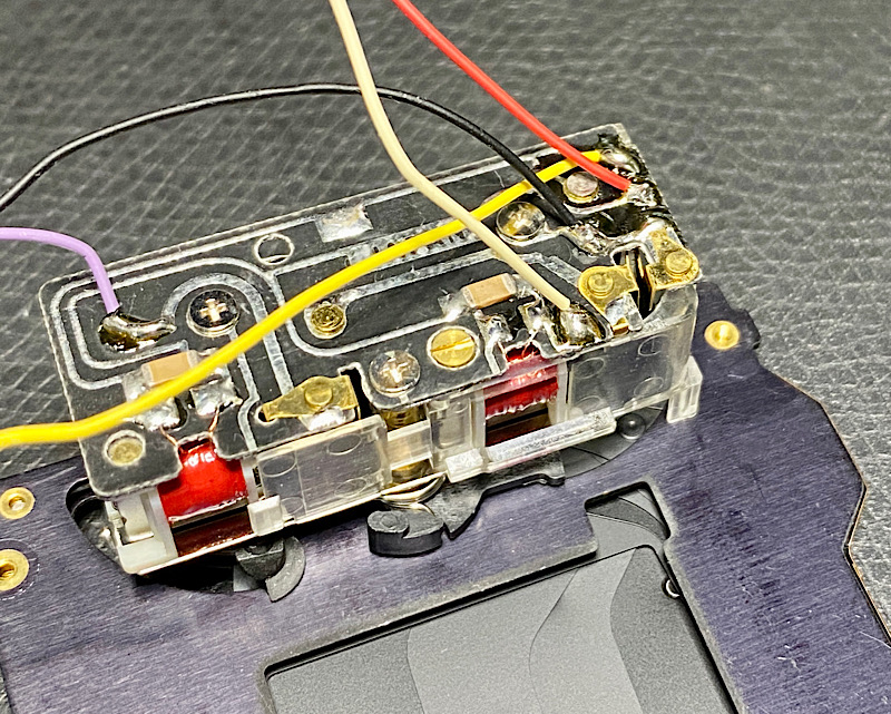

The experimental board has various terminals and components, such as these two switches, which I connected to the shutter via cables. This allows me to trigger the two curtains separately.
Adjusting the two locking wheels against the spring force requires full concentration. It's done in clicks to count.
When I had both curtains almost synchronized, I slipped with the screwdriver and made several clicks instead of one. So I had to start over. You can't turn the wheel counterclockwise. And if you release the lock to try it anyway, the spring will move faster.
To count the clicks - each click further tensions the spring - you need a reference point for the start.
For this, the lower end of the spring must rest against a pin against which it is tensioned. Here for the opening curtain C1.
To better observe the spring end on the pin for C2, I removed the protective cover for the two magnets. It's just clipped in place.
Here you can see the spring end and pin for C2, the closing curtain.

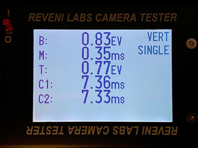

For an initial measurement, I turned both wheels 30 clicks further and determined the curtain travel times on the camera tester. I then estimated the corrections for both curtains in clicks and worked my way up to the target time of 7.2 milliseconds.
With two volts, the magnets hold their armatures reliably.
Connection to the shutter board.
Measuring the curtain travel times on the camera tester.
With this nice result, I finished the settings. This means I'm almost at the target time of 7.2 milliseconds.

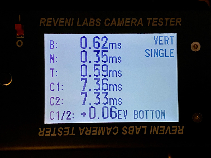

The images show the measured result for 1/2000 second, the fastest shutter speed on the 7000 AF.
Both curtains (C1, C2) move at almost the same speed; you can also see how the three sensors on the camera tester are exposed for different lengths.
The center sensor is the shortest, while those above and below are almost the same length, which results from the acceleration and deceleration of the two curtains. Nevertheless, a uniform exposure is achieved, as the EV value indicates.
After completing the assembly, I tested the 1/2000 second again and almost hit the bull's eye with a difference of only 0.02 milliseconds (or 20 microseconds) in the curtain runtime 🙃

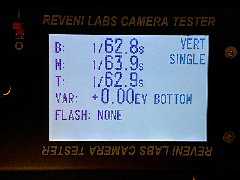

1/500 s
1/60 s
This allowed me to improve the shutter from +1 EV deviation at +1/2000 second to +0.04 EV as the best value.

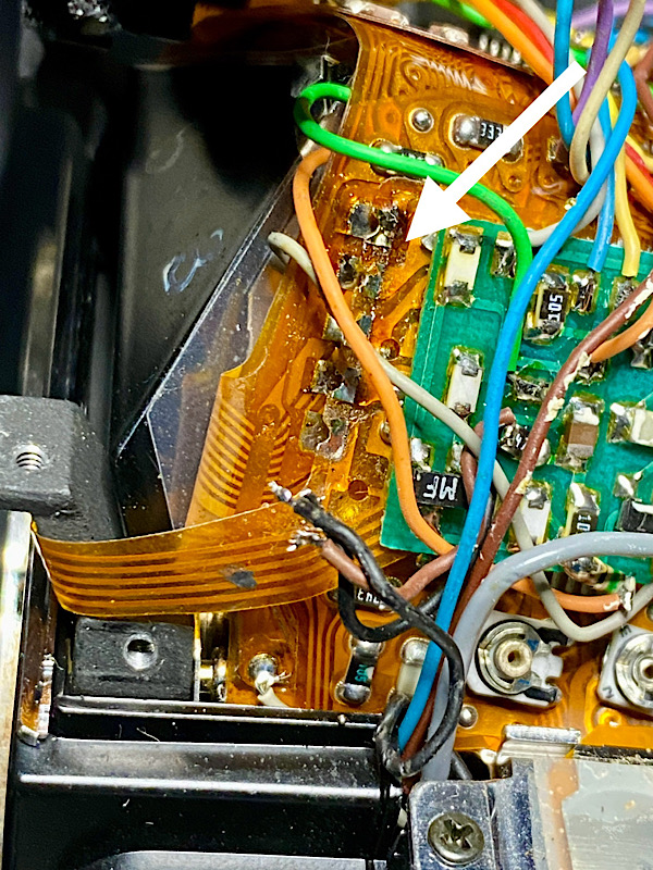

When I removed the top cover to attach an adhesive strip to the circuit board, the same error occurred again. Partial camera failure.
So I went back to troubleshooting, re-soldered the circuit board connection, and checked it. Then it worked again until I put the top cover back on. The LCD display was flickering, which meant there was a loose connection.
I finally found the problem when I pulled the smaller soldered circuit board (white arrow in the picture) out from under another one.
A 100 ohm SMD resistor had detached from the circuit board with one lead; it was only visible under high magnification.
That explained the problem. When pressure was applied through the top cover, the connection became unstable.
I scraped off some of the circuit board seal and re-soldered one end of the resistor.
That fixed it.
