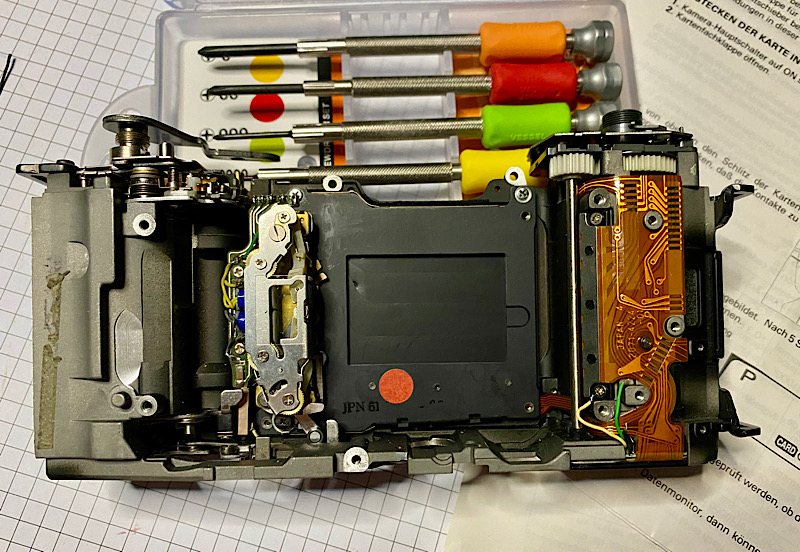

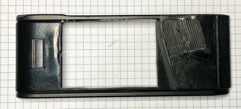

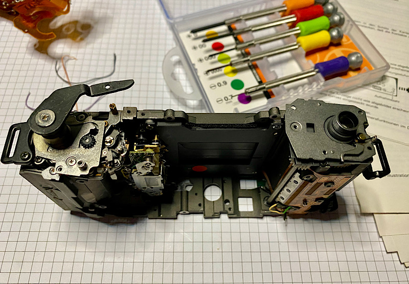

I am currently working on the Minolta 9000 AF shutter, which has problems with a rotting damper that is sticking the blades together.
An attempt to clean it from the outside while it was removed was unsuccessful; the shortest times of 1/4000 to 1/1000 s are not formed or are not formed correctly. So I am going to disassemble the shutter and cleaning it.
I assume that the sticking is hindering the movement of both curtains, but that the mechanics and electronic control of the two solenoids by the camera are OK.
I am wondering how I can test the shutter while it is removed or still mounted in the housing to measure the running speed of the two curtains.
The camera cannot control the shutter when it is disassembled or the shutter is removed.
Anyway it is possible to release the shutter mechanically if it is built into the housing, as can be seen in the pictures. But both curtains are probably triggered at the same time and the shutter tester does not see a slot that it can measure and evaluate.
Otherwise, my only option is to reassemble the camera after each cleaning cycle to test it, which is not possible.
Any hints?

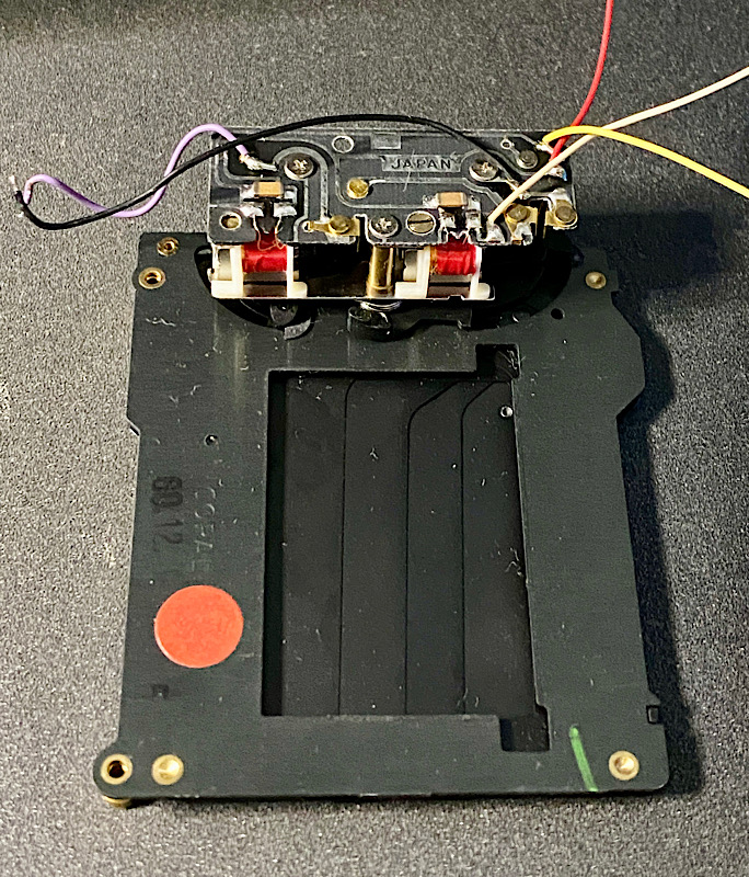

I should be able to set the curtain speeds, but how can I test the settings if the removed shutter is not electronically controlled by the camera?
What is possible without the mirror box is to tension the shutter using the winding lever, release it manually and release the winding lock for the next cycle.
But when the shutter is released, both curtains obviously move at the same time and therefore I cannot measure the speed of each curtain with the tester.
I have to remove the shutter from the 9000 AF again to see more.

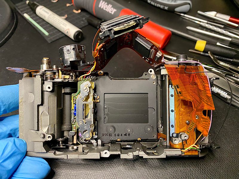

Here is my report on disassembling and cleaning the Copal shutter of a Minolta 9000 AF (1/4000 s shortest shutter time).
I have installed the shutter, cocking and releasing work, nothing is suspicious. So I'll take a chance and put the 9000 back together, then I'll see if it was successful.

But this is the solution, since I can trigger both curtains separately.
To do this, I need to connect the removed shutter to the sensor and trigger the curtains one after the other.
Then I turn the adjustment wheels for the springs to adjust them.
I'll try that.

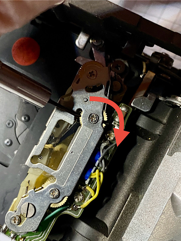

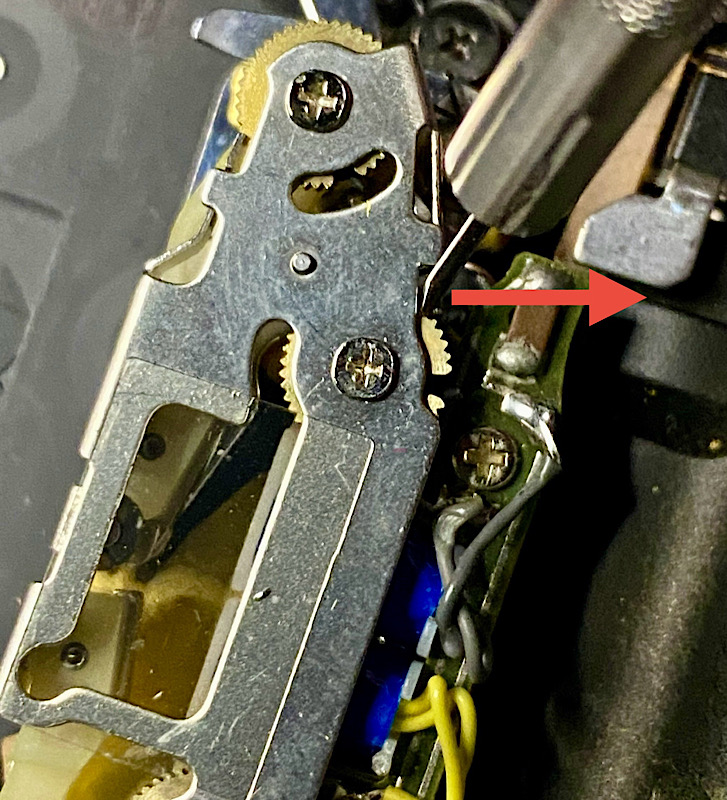

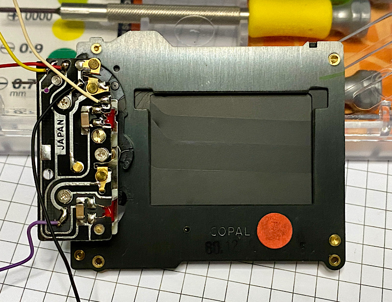

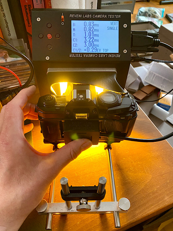

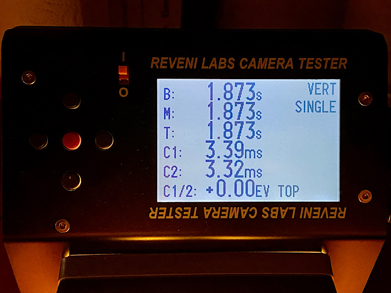

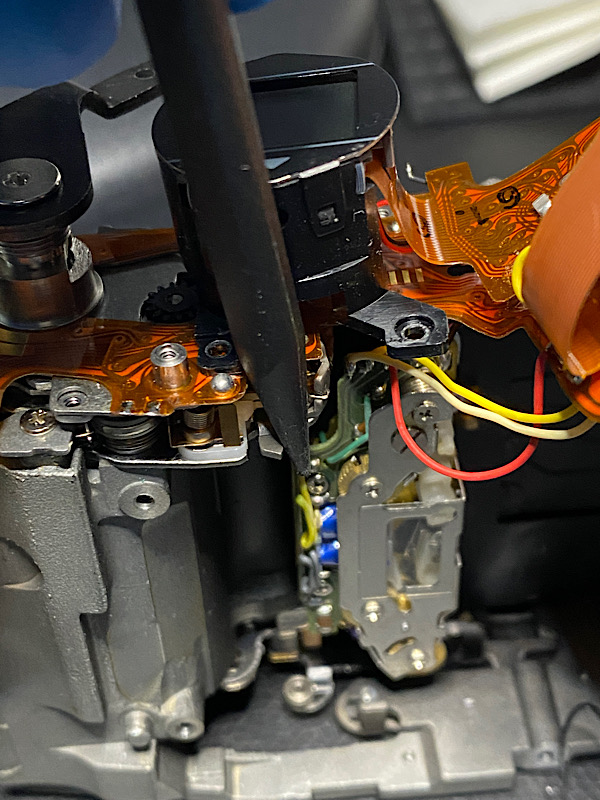

Adjusting the curtain speeds of the Copal S shutter on the Minolta 9000 AF

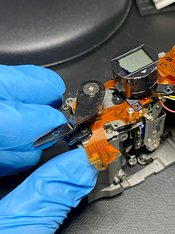

I managed to adjust the curtain speeds on my decommissioned Copal S shutter of a Minolta 9000 AF very precisely. 🙃

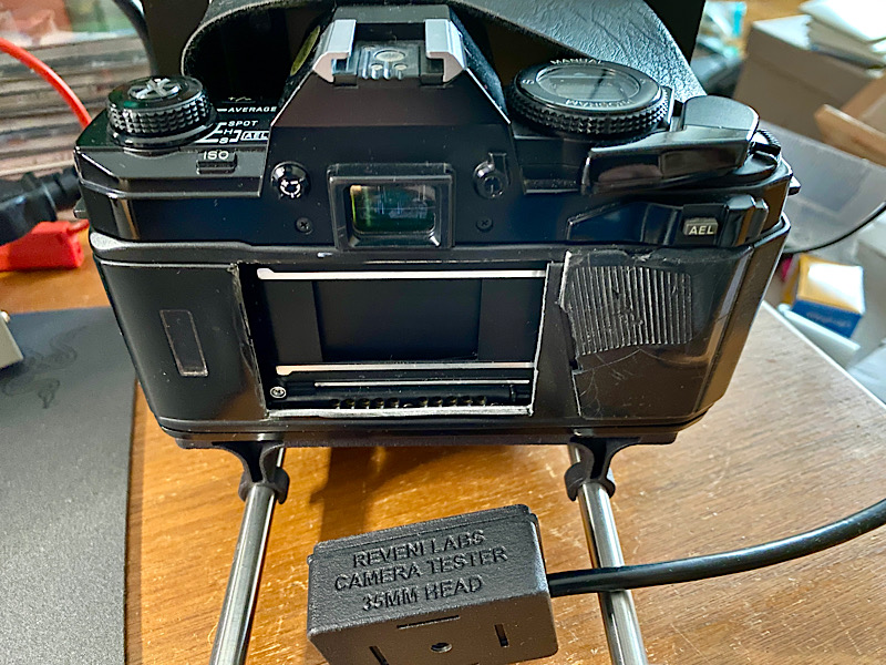

For testing, the shutter is inserted into the back of a 9000 AF, which is now used exclusively for this purpose.

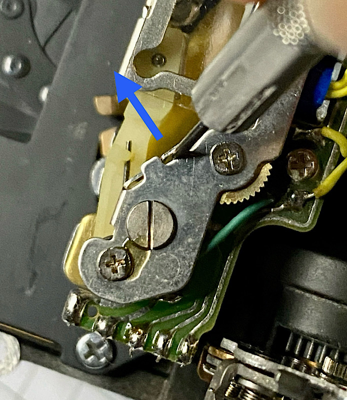

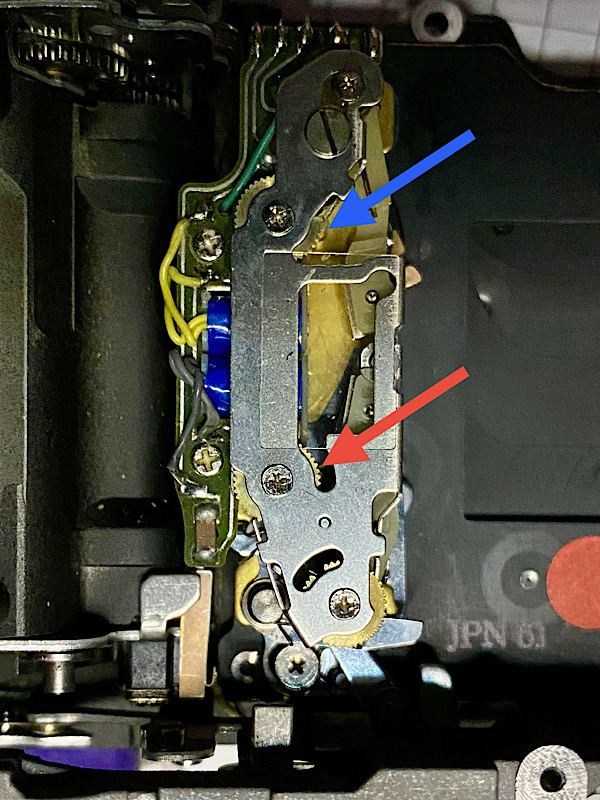

The speed of the opening curtain (C1) is adjusted using the lower adjustment wheel (red arrow).
The speed of the closing curtain (C2) is set on the upper adjustment wheel (blue arrow).

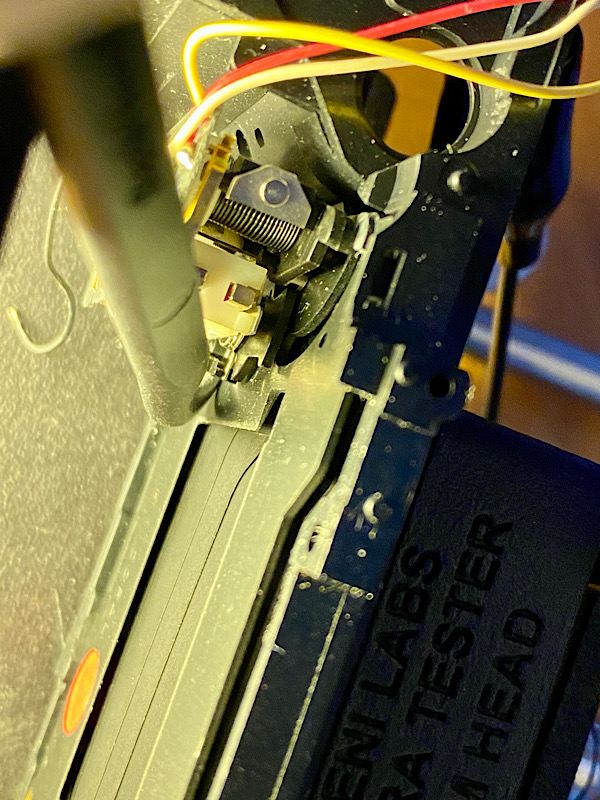

Lifting the two tabs releases the spring tension on the curtains. This means the curtains no longer roll down; they are reset.
Now the adjustment wheels can be turned clockwise against the spring tension. The lock clicks, indicating the position. I turn each wheel approximately 15 clicks.

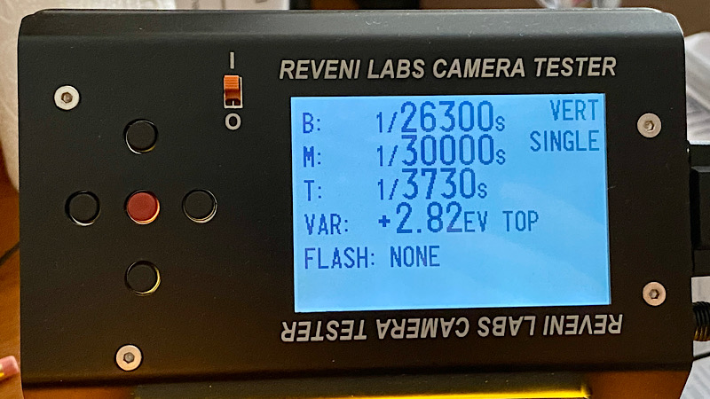

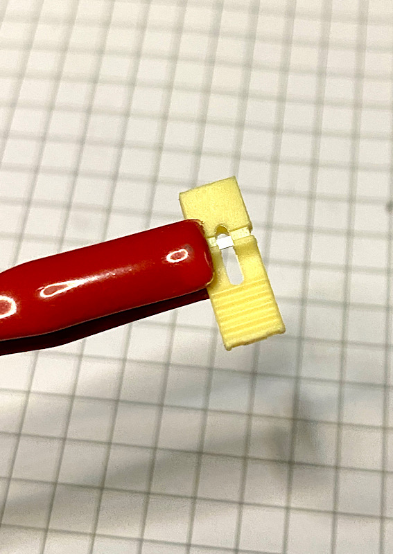

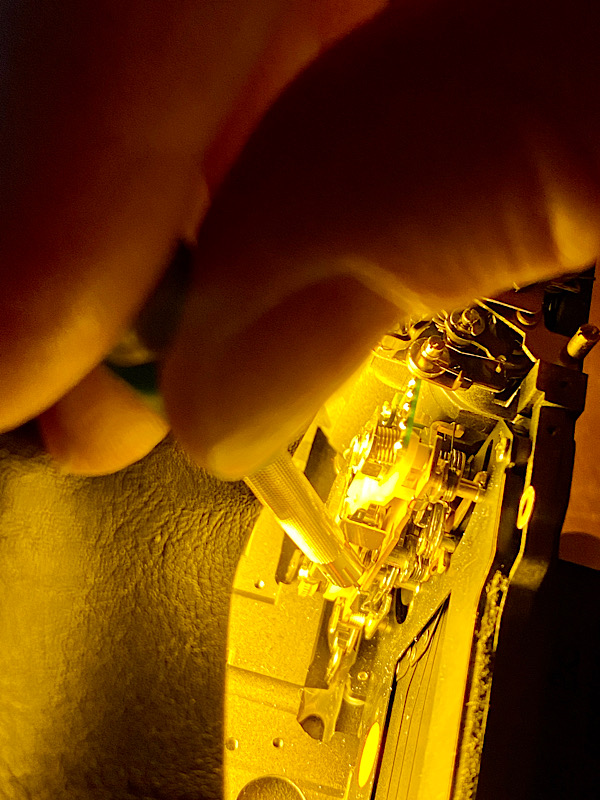

On the camera tester, I first manually trigger C1, then C2. This is done with a screwdriver, which must not be placed in the tester's light path to avoid affecting the measurement result.
My target speed per curtain was 3.40 milliseconds. That's almost there. Perhaps C1 needed just another click to make it faster.
This sets the curtains mechanically.
The camera's job is to trigger them electronically using the two shutter magnets at the correct speed.
Now I just need to determine the target speed for the curtains. I know it for the Minolta 7000 AF.
If I can't find anything about it in the service manual for the 9000 AF, I'll use that and the preset speeds displayed by the camera tester as a guide.

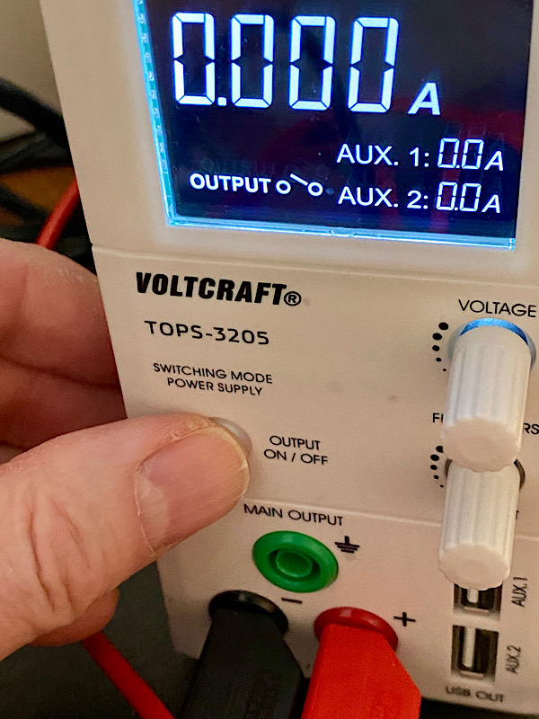

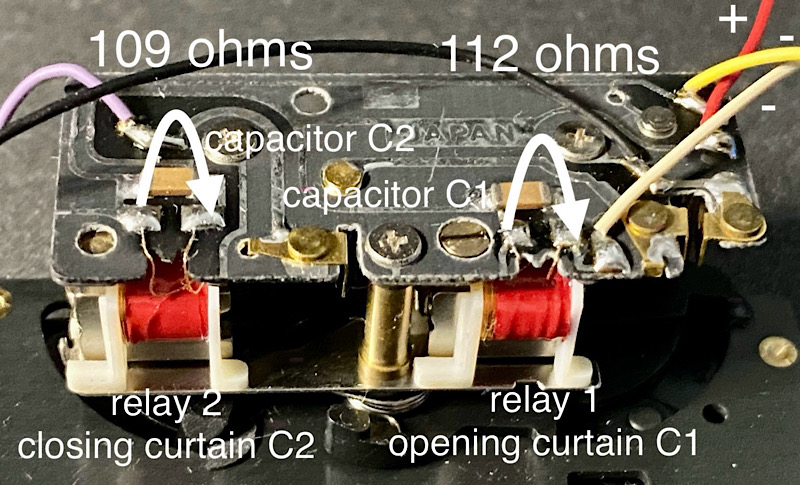

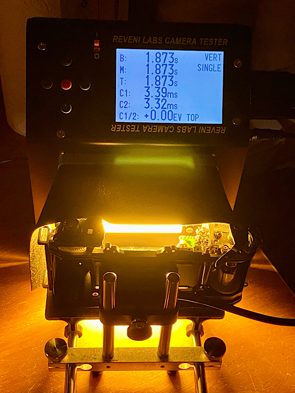

Adjusting the curtain speeds of the Copal S shutter on the Minolta 7000 AF

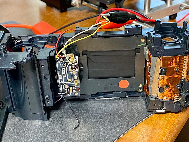

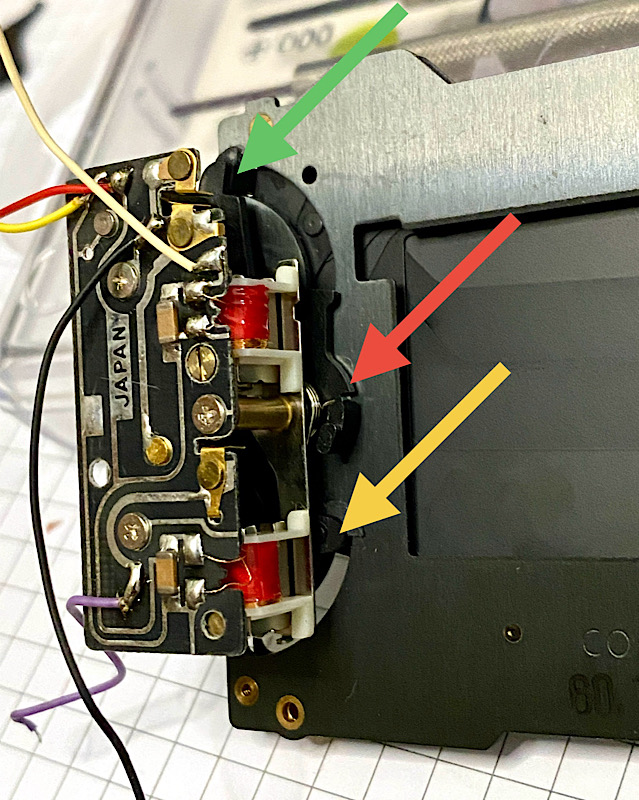

To determine the curtain speeds on the camera tester, the shutter must be connected to a voltage source.
This supplies the two shutter solenoids with power, allowing them to hold their armatures by becoming magnetic.
  • Green arrow: Lever of opening curtain (C1)
  • Red arrow: Lever that is pulled upwards and tensions both curtains.
  • Yellow arrow: Lever of closing curtain (C2)

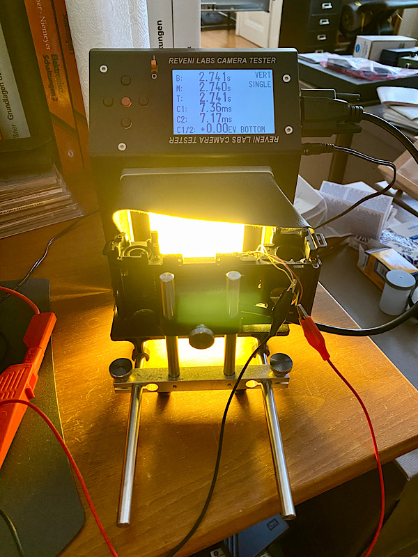

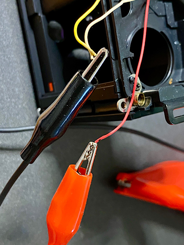

For testing, the shutter is inserted into the back of a Minolta 7000 AF, which now serves only this purpose. If necessary, the shutter can be secured with adhesive tape.
Screwing it on is not possible, as the shutter is secured on two axes with circlips.

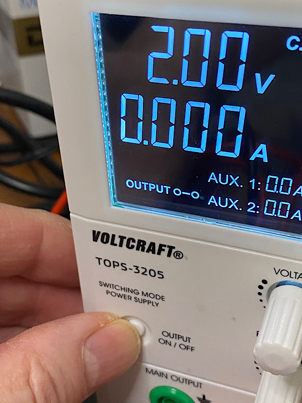

Connection to my laboratory power supply.
A two-volt supply voltage is applied. The solenoids are now activated and magnetic.
Insert into the camera tester.

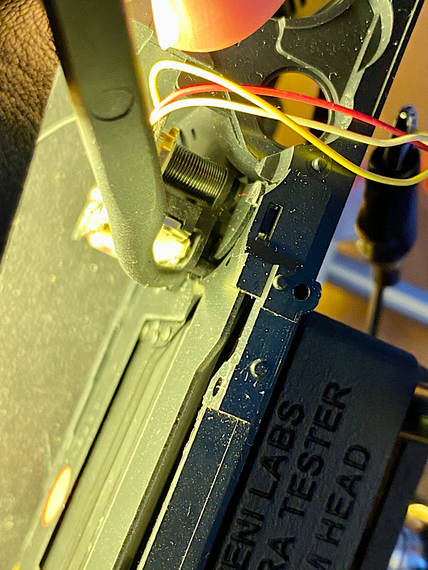

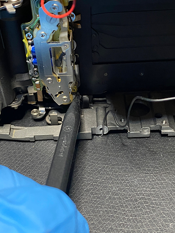

Tension the two curtains by pulling their lever up with a hook.

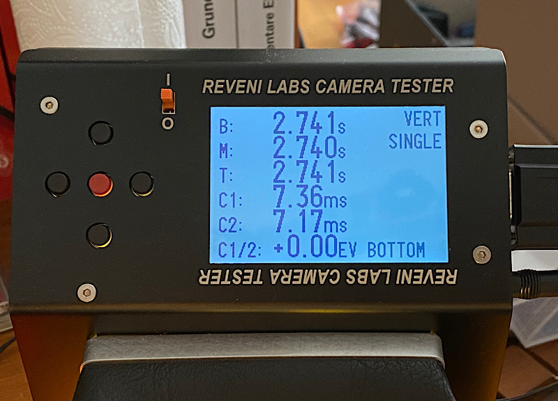

Triggering the opening curtain (C1) by pulling the lever up against the magnetic force of its solenoid.
The closing curtain (C2) is triggered by interrupting the supply voltage. The associated solenoid loses its magnetic force and releases its armature.
The target time for both curtains is 7.2 milliseconds (SPT Journal). Therefore, C1 is too slow and needs to be adjusted.

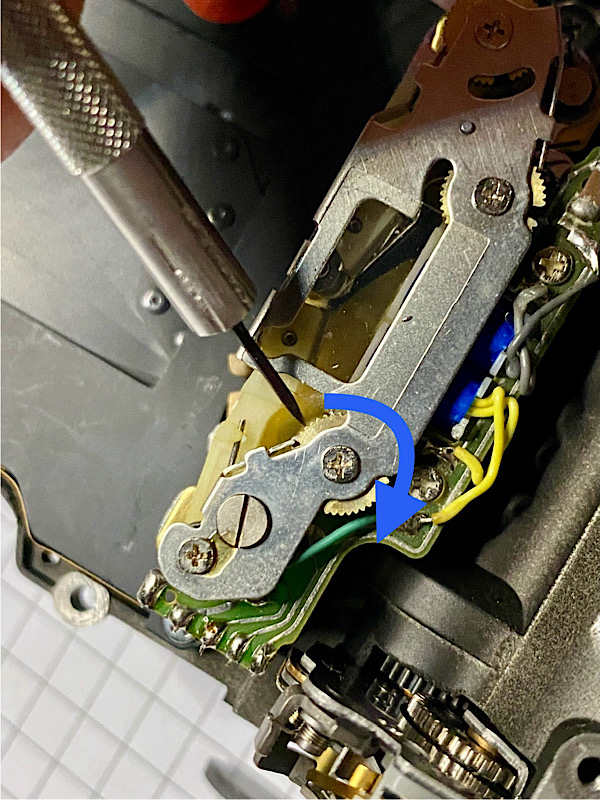

Adjusting the curtains
Reset both curtains by pushing the locking pawl upwards. The springs will lose their tension.
Adjust the spring force by turning the adjustment wheel clockwise. A click indicates the position.
Then test and correct if necessary.

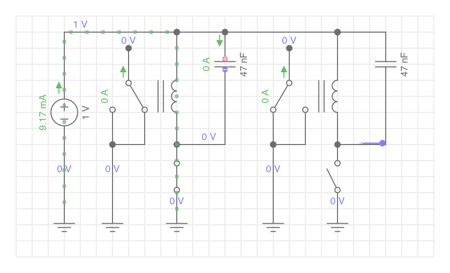

Note
If a coil (part of the solenoid) has built up a magnetic field through applied voltage and this voltage is interrupted, the magnetic field collapses. Its energy is released through a high voltage spike with reversed polarity.
To prevent this voltage spike from damaging the circuit, circuit protection measures are implemented.
I assume this has already been done on the circuit board of the shutter.
I also assume that manually disconnecting the magnetized solenoid is safe for testing purposes.
Minolta 7000 AF: Electronic release of the curtains when the shutter is removed
In order to avoid having to manually trigger the opening curtain C1 against magnetic force and thereby getting into the beam path of the camera tester, I looked into how this could be done with two switches.
The shutter of the Minolta 7000 AF removed.
I measured the resistance of the two coils on the relays with an ohmmeter; it's approximately the same (109 ohms and 112 ohms).
Two capacitors (C1, C2) of 47 picofarads (?) each are connected in parallel with the coils (not to be confused with the curtains C1, C2). Their function isn't clear to me (I assume they are capacitors).
The red wire supplies both relays with 1 V input voltage. The yellow and white wires are the negative terminals.
Circuit simulation for setting up a test circuit
The input voltage is applied to both coils, the armatures are attracted by the resulting electromagnetic force, and both curtains are tensioned.
The two capacitors are charged.
C1, the opening curtain, is triggered. This occurs via a switch that interrupts the power supply to the coil of relay 1. The magnetic field collapses, and the relay releases the armature.
A short delay is caused by capacitor C1 which discharges through the coil and supplies it with voltage for a short time.
The same process occurs with C2, the closing curtain. Here, too, a switch releases the armature.
Both curtains are triggered, C2 closes the film window.
My test rig is again set up using the back of a 7000 AF, into which I insert the shutter to be tested.
The shutter terminals are connected via a breadboard with two switches, and the lab power supply provides the input voltage.
This makes testing the shutter not only trouble-free but also more convenient.

Minolta 9000 AF: Making a back door with an opening for the camera tester
In order to be able to check all exposure times of the Minolta 9000 AF with the camera tester, I made a back door with an opening.
For this purpose, I had the original back door for the 9000 AF from my spare parts inventory with the worst condition of the plastic handle.
I made the opening in the back door using the Dremel and a thin metal cutting disc. I smoothed the edges with a diamond file and sandpaper.
This back door as before activates a switch on the frame counter, which causes the camera to advance from 1/4000 s to the remaining exposure times.
With the back open, the 9000 AF always releases at 1/4000 s and aperture 22. This combination ensures that the film leader is not exposed when advancing to frame #1.
This saves me from having to install a temporary solution to permanently activate the switch.
The sensor can be placed directly on the film window.
Now the exposure times can be tested one after the other.
