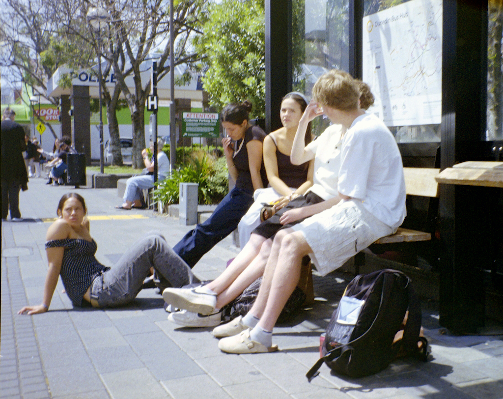

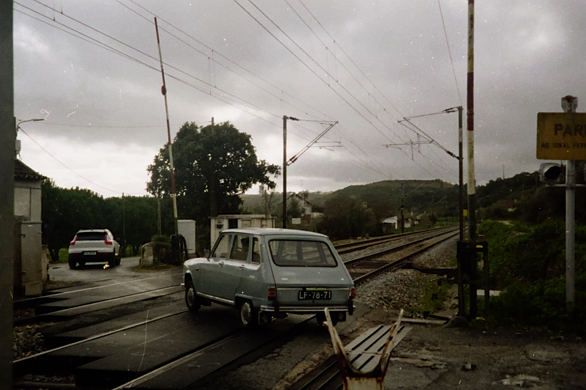

Because both the cat and the bus stop were from the same roll of film with the same camera I suspected the Gamma adjustment stage was the problem. These attachments are from more tests using an earlier method with my venerable G5 Mac and PS Creative Suite (CS), the original version. I would be interested to see how it comes out under scrutiny.
The picture is very blue. Something is wrong with your colour management.
When I look at it closely with the colour picker it does have a tendency to blue/cyan. This is the complimentary to the orange mask so I suspect the gamma correction stage is where the problem lies. I have posted another version done on PS which looks better.

I'm using a fairly generic HP LCD here, but it's calibrated. I don't doubt your Mac shows colors just fine - at least well enough to see the kinds of casts we're dealing with here.
What constitutes a strong or a slight cast is of course also subjective, and it's well-known that sensitivity to color varies greatly between people. Then there's the aspect of practice and experience. The more time people spend with this, the more sensitive they tend to become to color casts. What may look like a minor issue to one person can be a massive problem to another. I readily acknowledge I'm on the latter part of the spectrum; I respond quite strongly to color to begin with and spending a lot of time optimizing it in prints & scans makes me all the more focused on it (which isn't to say I always get it right!)
Your adjusted version is better, although it still doesn't look completely natural. Color balancing is a bit of an art and perhaps part magic; in all brutal honesty, operations like "auto levels" etc. really don't cut it in practice. It may give an acceptable quick preview of what's on the image, but it won't be optimal. Trying to fix things once these kinds of auto-adjustments have been done is often a lot more work (and sometimes even impossible) than just starting over with the raw capture of the negative and then adjusting the curves manually as I suggested in my post #14.
Because both the cat and the bus stop were from the same roll of film with the same camera I suspected the Gamma adjustment stage was the problem. These attachments are from more tests using an earlier method with my venerable G5 Mac and PS Creative Suite (CS), the original version. I would be interested to see how it comes out under scrutiny.View attachment 414621

In my (limited) experience with converting color negative film to positive, the fact that "both the cat and the bus stop were from the same roll of film with the same camera" is of little significance. It seems to me like whatever adjustments were required for one frame may not necessarily give the same results with the next frame, expecially when the lighting and exposure are different from frame to frame.

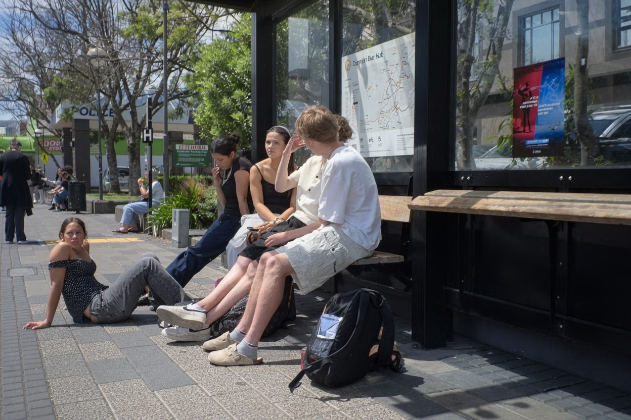

On my calibrated iMac monitor, this version of the bus stop photo looks much better. The blue tint in the deep shadows is now mostly gone, but I think there may be still be some lingering blue cast in the midtones...? I would expect the paving "stones" (more likely concrete?) to be less blue and more gray?

Thanks to everyone with your informative replies. I took the advice of simply colour balancing manually. I have found a hack in Photoshop that works remarkably well. After inverting I create a new curves adjustment layer, I then go to "Auto Options" and choose "enhance per channel contrast" and make sure the "snap neutral midtowns" is checked. Minimal colour balancing and contrast adjustment is then needed.
