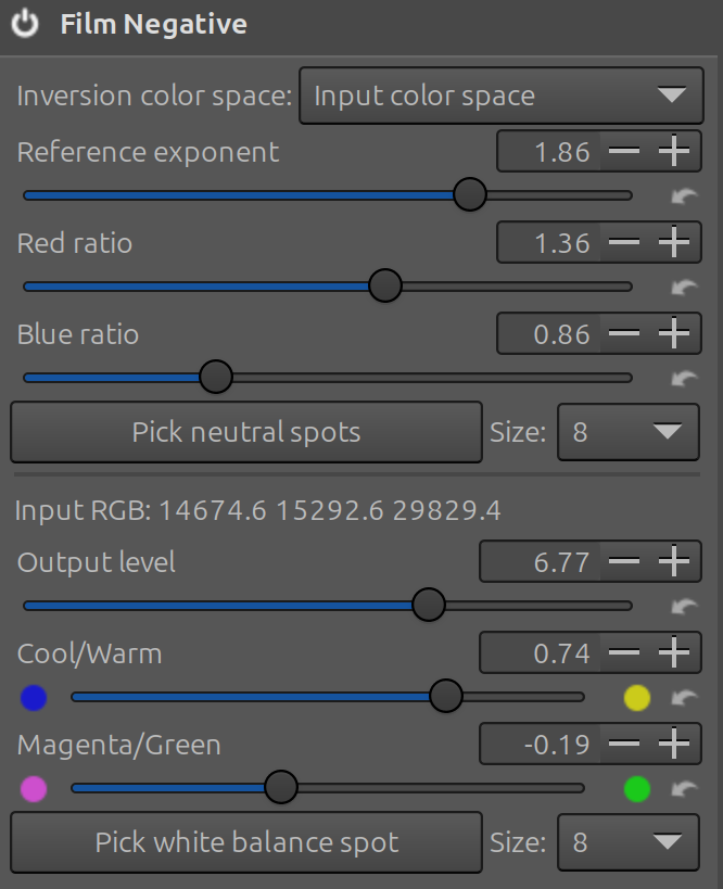

For particularly difficult color negatives, I've lately been making use of RawTherapee's "Film Negative" feature - it's quite powerful at making the necessary adjustments once you play around and get the hang of it. It even works with nonwhite light sources.

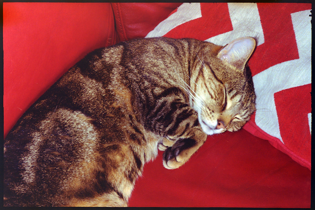

I have tried all sorts of approaches but my favourite nowadays using Affinity Photo is as follows:
1. Scan the neg with some of the margin visible - I copy with a digital Sony A3000.
2. Open in Affinity and crop if needed but again with some film margin.
3. In Levels adjust gamma slider so that the film marging just retains a hint of colour - thr whole thing will go pretty light.
4. Apply Auto Levels.
5. Invert
6. Make any fine tuning adjustments.
I have been getting very good results this way. A couple attached - Kodak Colorplus 200 with Panasonic Mini&Zoom compact.

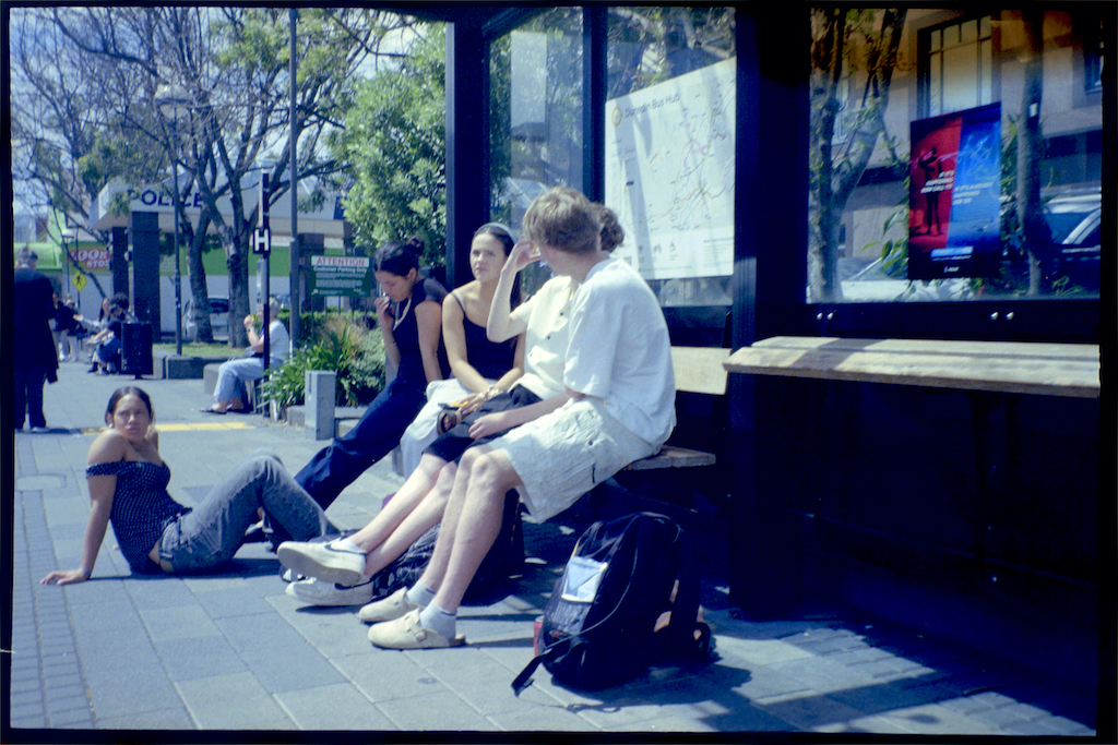

The one of the cat looks really nice--and rather natural; the second one is way too blue for some reason.

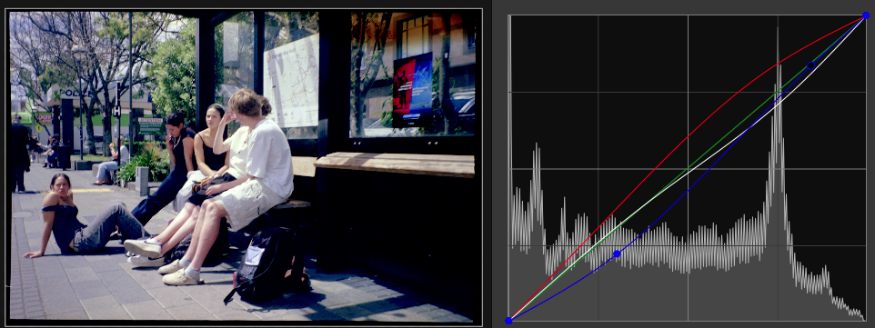

Yes, it has a severe cyan and blue cast. The historgram is also not smooth, suggesting that color corrections were done in 8-bit space; I'd do this in 16 bit and only convert to 8 bit jpeg at the end of the chain to avoid posterization, especially if the decision is made later on to apply e.g. local burning & dodging.
The bus stop pic doesn't look to have a blue cast on my set up, if anything a little yellow. Must be monitors I think though I did apply some corrections to colour/density. The cat is exactly as it came out of the camera and inverted as described with nothing further applied. It is a flash shot which probably makes for more consistency.
Apropos nothing, the thumbnail looks more blue than the full size on my 2013 Macbook Pro.
Sorry, but I am another person who sees the bus stop photo as being too blue, especially in the shadows and darker tones. The whites and light tones are much less blue. When was the last time you calibrated your screen?
