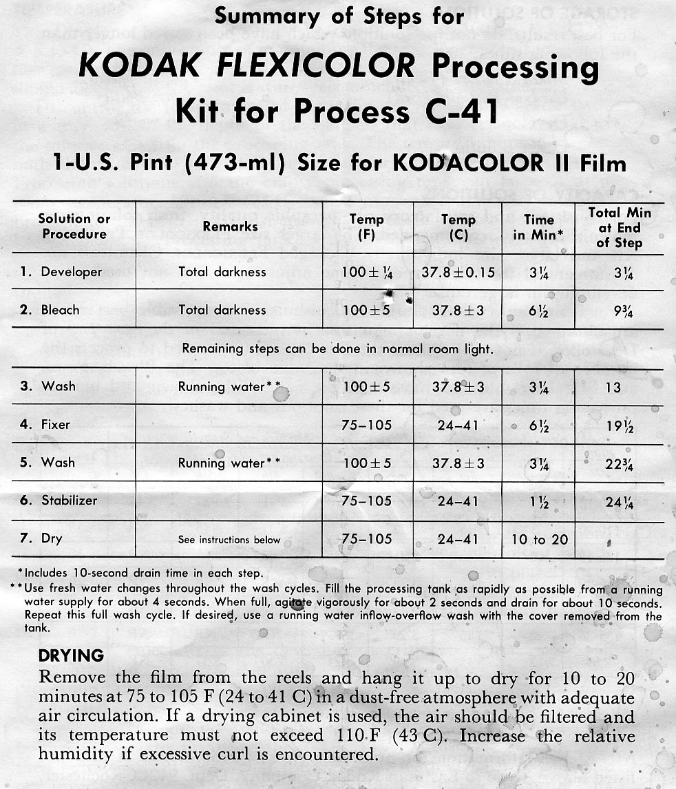

Here is the C41 process I use. I sometimes use a 2% stop after the CD and before the bleach. It depends on film/solution volume and thus pour time.
E6 requirements for pH range are the same as for C41, as the dyes formed are of the same classes of chemicals.
I run the final wash until the water runs clear and leaves no stain in the final rinse.
PE
