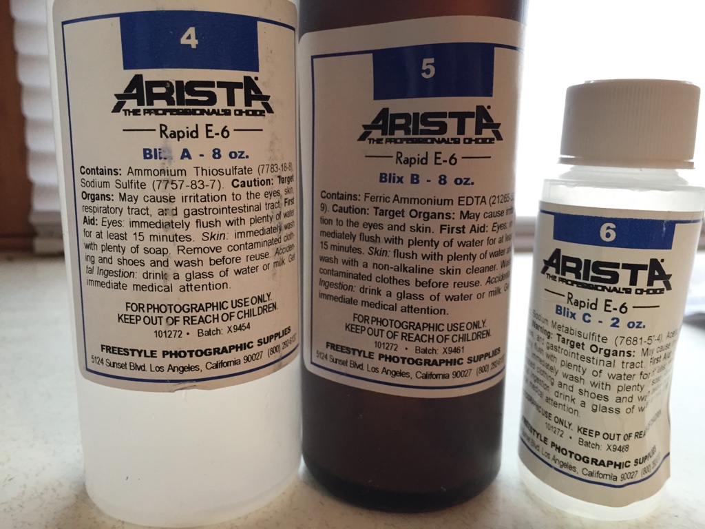

The instructions for the Arista E-6 kit have 3 parts for the blix, ammonium thiosulfate, tetraacetic acid EDTA, and acetic acid. None of these have "ferriic" in them. Can I make bleach with this? I assume the ammonium thiosulfate is the fixer. Is the middle one the bleach? What is the acetic acid for?
This kit does not include a separate stabilizer or rinse. The instructions include a final wash with water. Is there anything in the blix that acts as the stabilizer?
Thanks,
Rob
Rob, this blix must contain "Ferric" ion or it will not bleach the film. If one part is blood red, that contains the Ferric part and it is unlisted for some reason.
As for the stabilzer / final rinse, the kit is incomplete.
PE
IIRC, EDTA is ethylene diamine tetraacetic acid. So there is some redundancy in "tetraacetic acid EDTA". In the blix ingredients I have seen it is usually listed as Ferric Ammonium EDTA.

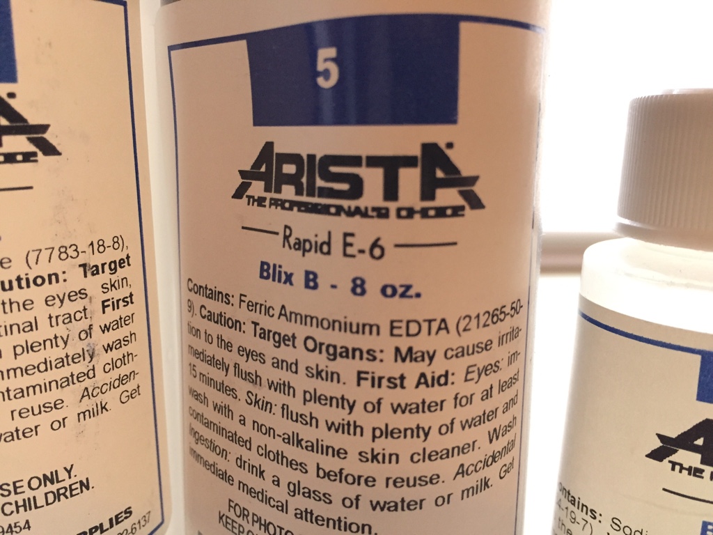

Rob, this Arista BLIX part B is described as containing (Ethylenedinitrillo) tetraacetic acid, to which the commonly used abbreviation EDTA is appended. My impression is that the instructions mention only the compounds that have to be listed in the MSDS anyway, and Ammonium Ferric EDTA seems to be harmless enough to avoid being mentioned in many MSDS. If this image is an indication, then my bets are that the Ammonium Ferric EDTA component is indeed contained in blix part B.
I would therefore use the following instructions to convert this Arista E-6 kit into a bleach&fixer kit:
  1. Dissolve 50 - 100 g of either Ammonium or Potassium Bromide in 600ml water.
  2. Add 250ml of blix part B to this mix
  3. Fill up with water to make 1l
  4. Then use blix part C instead of Acetic Acid for pH adjustment as described in my article in section 4.2
  5. Ditch blix part A (or use it diluted 1:4 for B&W work) and use a neutral fixer like TF-5 or Tetenal Superfix Odorless.

The bottles of the Arista E-6 kit do tell a bit more information than the Safety Notes on the back panel of the instruction sheet:
Micah in NC
