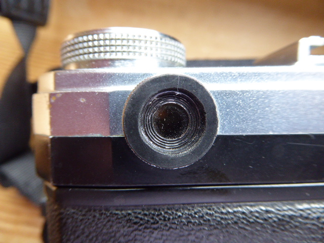

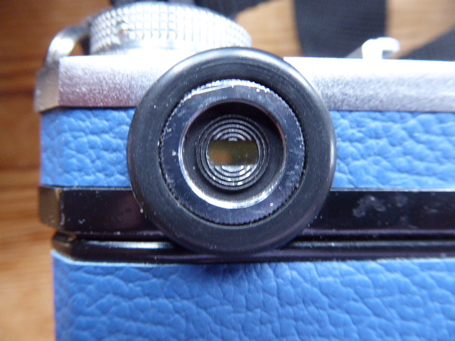

From your second photo, I get 0.25 mm pitch. You can't count the first turn, the thread is covered by the collar,l and your marker line is a little off on the second, but from the first fully visible thread land to the third, is exactly 0.50 mm.
That would make sense with metric measurements being divided in halves and quarters rather than thirds.
Today, correctly, metrics should be in integer tenths or hundredths of the listed unit -- but they aren't always, because metric thread standards were established before SI practices were. For instance, standard pitch for M5 is 0.8, but for M8 it's 1.25. And for threads in things like helicoids, camera parts (and gun screws, for that matter) standard pitches go out the window.
Hopefully the threads that I cut will be close enough as my lathe is strictly Imperial. 0.5mm converts to 50.8 tpi and the closest I can get is 52 tpi. If we were working with metal to metal I wouldn't even attempt it, but with plastic to metal over such a short distance, I think it should work ok.
By my count, at 0.25mm pitch, it should be awfully close to 102 tpi. Probably close enough that if there's a little slop in the fit, it'll be find over 3-4 turns.

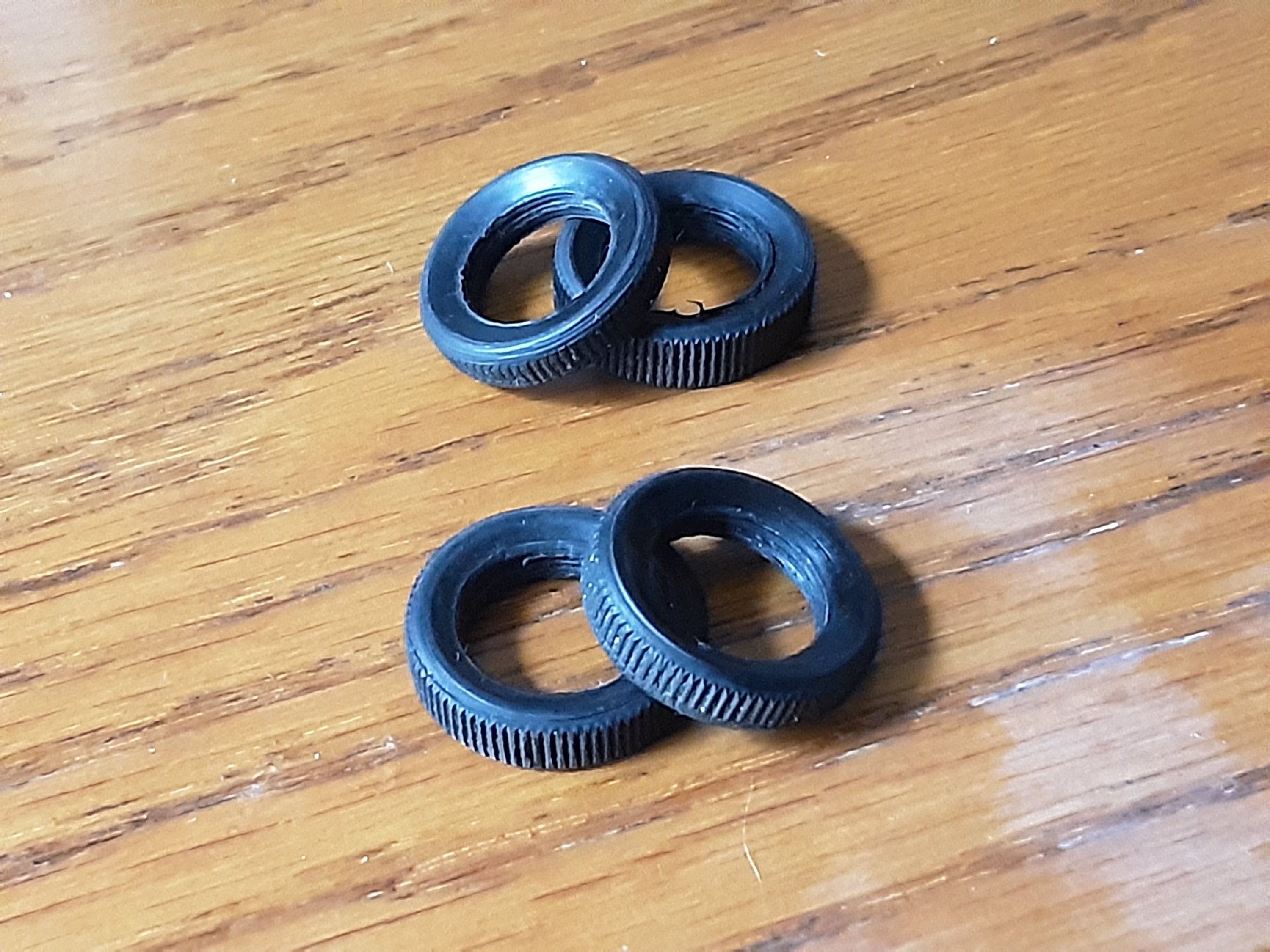

I had a little time today so I fired up the ' ol lathe and this is what popped out. They're not perfect, but hopefully they'll be functional. I used the dimensions that Patrick posted but I don't have a Contax to do a test fit, so who knows. What I would like to propose is sending 2 of them to @Michel Hardy-Vallée and 2 to @Patrick Robert James. If you gents would try them and give me your critiques, then I'll make any adjustments and be ready for the onslaught of orders.

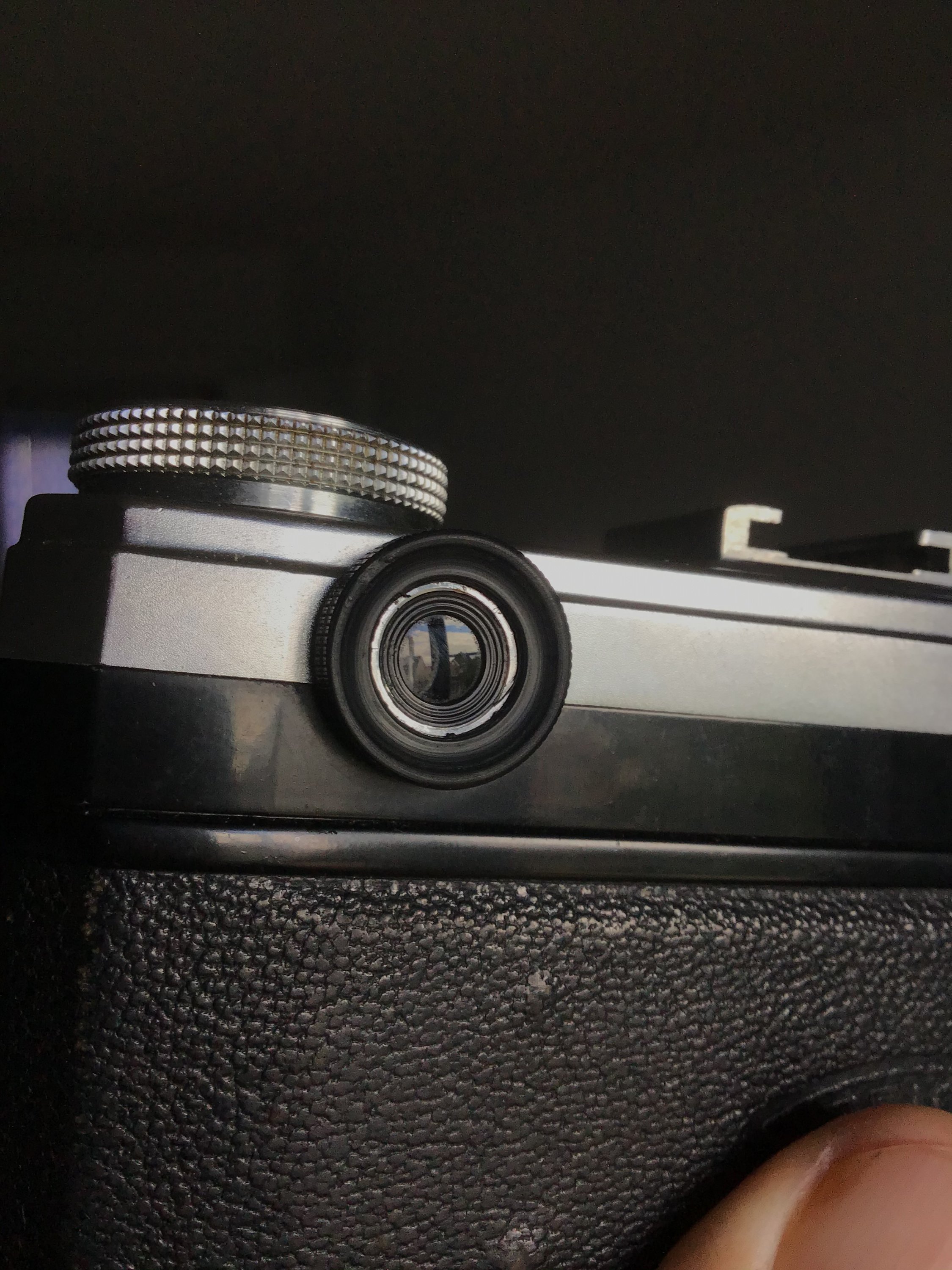

Alright, so the two rings you machined arrived today. They are almost a perfect fit: the outside diameter is good and looks good on the eyepiece, but the inside diameter seems to be a little too big. I can get the threads to mate, but they only do so by the tips, so the ring doesn't stay on for long. It can be screwed in, so I think the pitch you used is fine, but it takes only a light push to drop the ring from the eyepiece.
Is there anything specific you would like me to measure or to photograph to help you out with the adjustments? I think we're pretty close.
Michel, if you could measure the OD of the threads on your camera and the ID on the pieces that I sent you, I can compare your numbers to what I measured and I should be able to get it dialed in.
Doing my very best with Vernier calipers, I end up with 1,00 cm for the Contax, and 0,95-0,96 for the two eyepieces. I think we could shave off another 0,05 cm.
Sorry for the delay, been a busy week. I agree, 0.05 sounds about right, I'll try to get to it this week.

Finally had some time to work on eyepieces again. Michel, I'll get a couple in the mail to you this week.
@btaylor , if you'll PM me your address I'll send one or two your way.

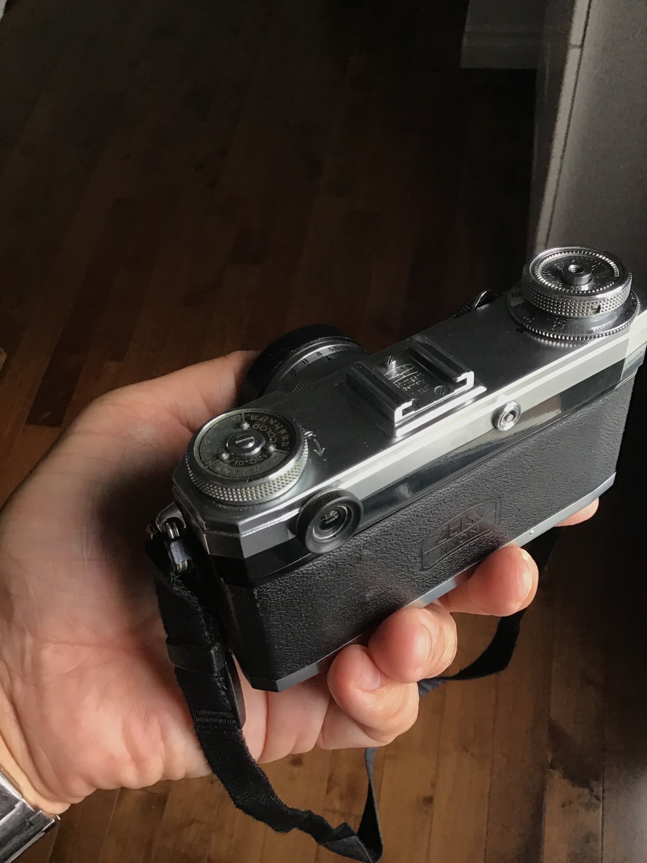

Michel, I'm glad that it worked out. I have to say, that is a very good looking Contax, not sure my part is up to the same standard.
