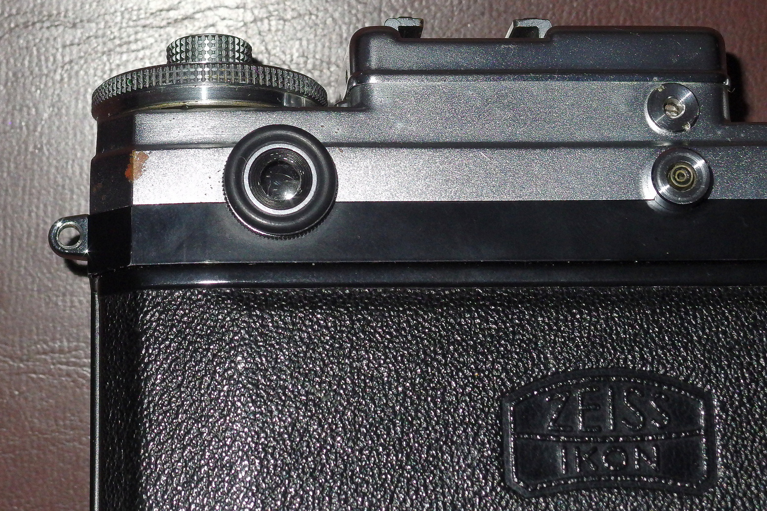

My IIIa has a little plastic piece that is threaded on.

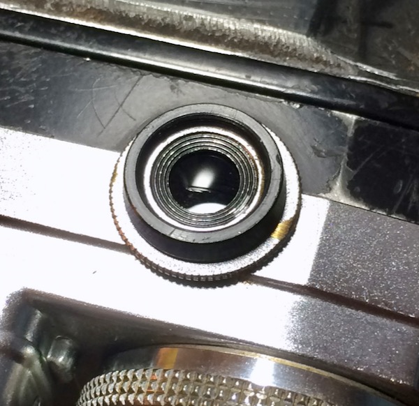

Here is the image of the plastic piece Michel.
If you want to make a replica, I got out my handy Fowler digital calipers and the diameter of the male thread measures 9.89mm repeatedly. It is a .5mm pitch. The male thread extends 1.5mm from the body. The plastic piece is about 3mm deep, so deeper than it needs to be. I think 2mm depth would be more than enough. I'd make it thicker too so it doesn't crack if it takes a bump.
I am glad you asked me to photograph it Michel because when I got it out the plastic piece was loose so I could have lost it. I guess not all good deeds go punished.....

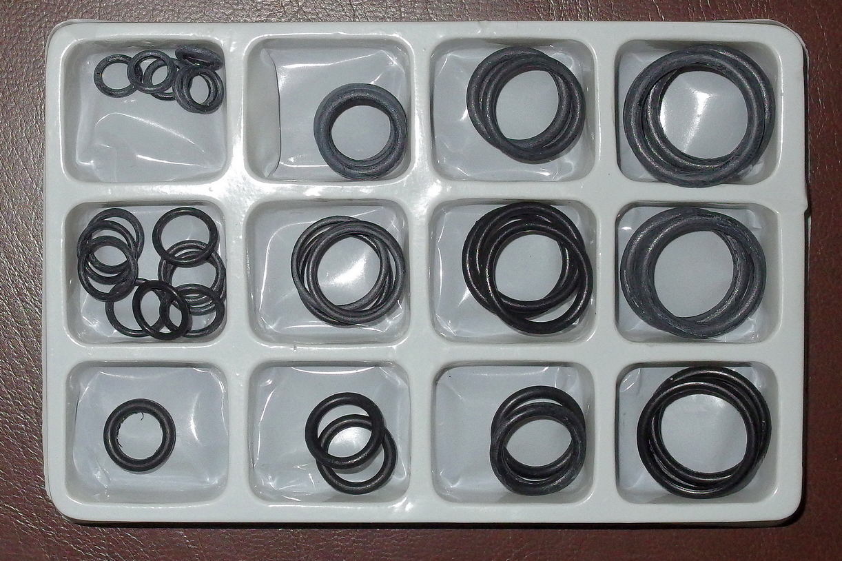

Simple cheap solution.
Pack of rubber O rings from $2 shop.
Select best fit (from this pack, lower left) and attach with rubber cement.

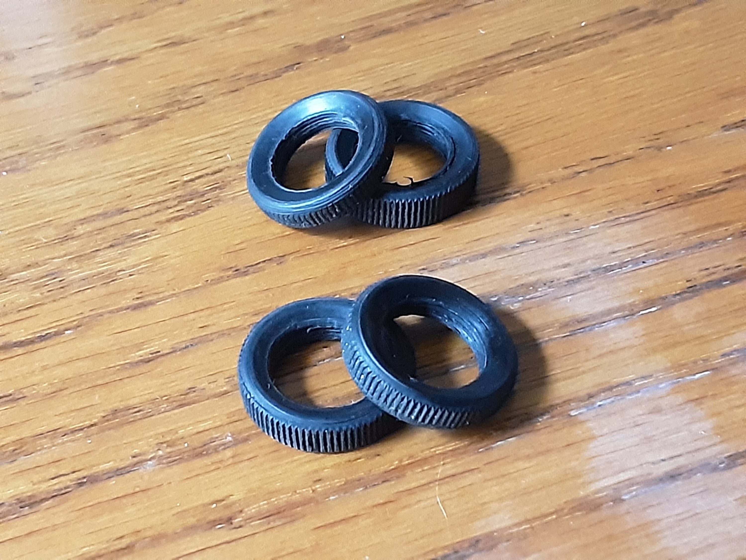

I had a little time today so I fired up the ' ol lathe and this is what popped out. They're not perfect, but hopefully they'll be functional. I used the dimensions that Patrick posted but I don't have a Contax to do a test fit, so who knows. What I would like to propose is sending 2 of them to @Michel Hardy-Vallée and 2 to @Patrick Robert James. If you gents would try them and give me your critiques, then I'll make any adjustments and be ready for the onslaught of orders.

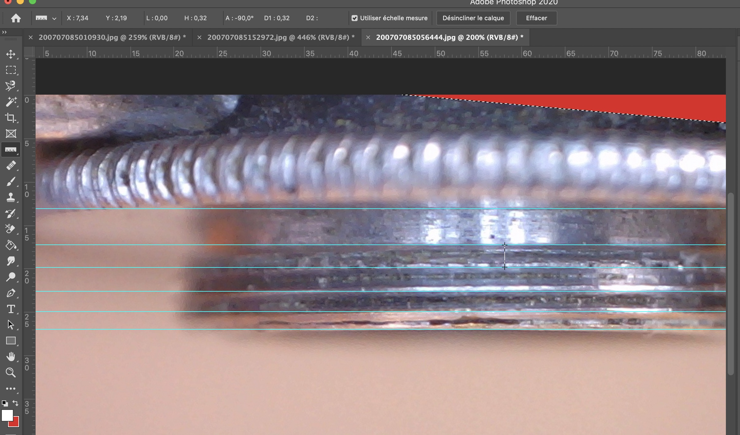

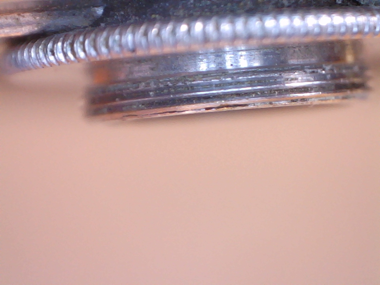

Hey, you've been quick! I'll PM you my address. Meanwhile, here's what I did: using my USB microscope, a scale, and the Analyse tool in PS, I measured visually the thread pitch. I have something like 0,3 mm between each thread; the whole threaded area is 1,25 mm. The entire eyepiece is 1,75mm thick.
