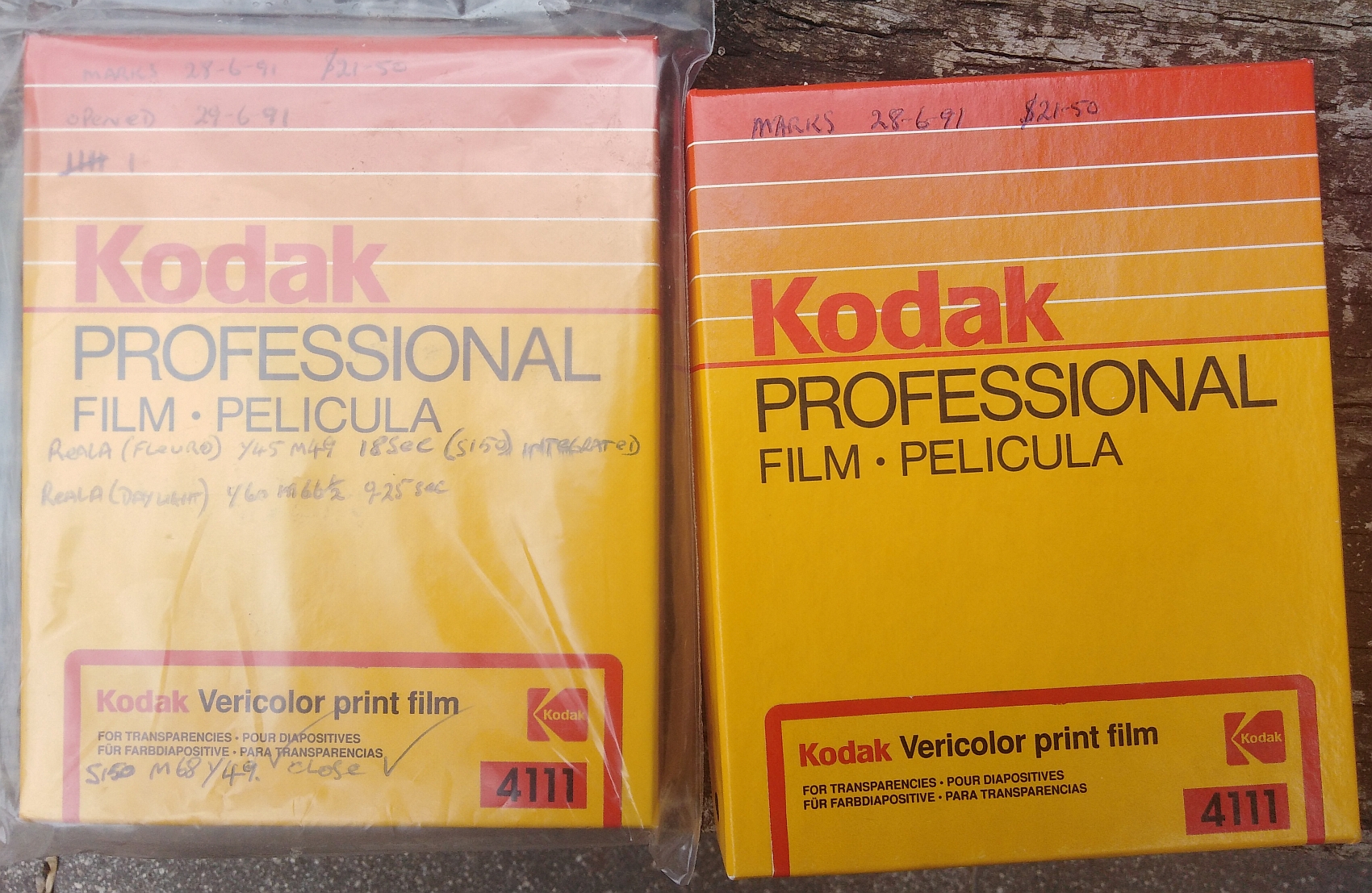

Attached is a picture of the last of my stock of kodak Color Print Film 4111.
This is a colour negative film designed to be developed in the C41 process. Essentially it is designed to take a (usually) contact exposure from a colour negative film and give you a colour slide, or transparency.
My professional use of this was in my work in an industrial colour lab where we made colour slides from colour negative film. Usually this was for advertising purposes where the colour balance was impossible to work out, or was impossible to correct for. This meant that colour negative film was exposed, the film developed, usually a colour contact sheet(s) was/were made. Then the chosen frames were enlarged, or contact printed onto C41 colour negative film to make colour transparencies for the advertising executives or art director to choose.
My personal use was to make myself able to supply a picture library with difficult lighting situation stock pictures. My method was to use 135 cameras, always tripod mounted, using very sharp lenses, like a 55mm Micro Nikkor to record industrial machinery under interesting light conditions. From the ensuing contact sheets, I would enlarge the colour negative film onto Kodak Color Print Film, then develop it to produce a colour corrected, or at the least a very nice coloured scene, 4x5" transparency.
I did this for around 5 years before they found out I was supplying them film images that originated from 35mm colour negative camera work. It was around this time that this kind of work was drying up as electronic photography started taking over and colour correction from an electronic file was their preferred method.
For the very best colour possible, I started using Fuji Reala 4 layer colour negative film the week it became available in Australia. The colour accuracy of this film combined with Kodak Print Film, was something to behold.
As you can see from the attached image, I bought my last lot in 1991. The demand for this product basically dropped off of a cliff around the end of 1991.
You can see my enlarger settings on the open box in the plastic bag.
$21.50 AUD? 25 sheets?
In still photography, the term color print film means usually the same as color negative. In motion picture, this term is seldom used when talking about camera negatives. Instead, print films are clear base slow ISO negative stocks for making prints from negatives. Most of the post production and projection is nowadays digital, but this is true in still photography too, where scanning is more popular than analog printing.
You wish.
Nope, it is for 10 sheets. I had to go to the darkroom to check. Expiry date is 3/1992.
I've had these last two boxes in my refrigerator for the last 32 years; would you believe? 😊
You wish.

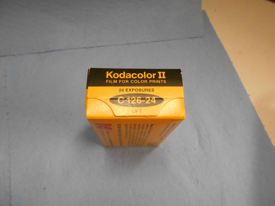

It doesn't help that a lot of C-41 process film today is marked "Film for Color Prints" -- (i'm looking at you, Fuji!)

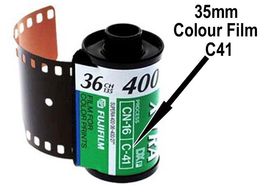

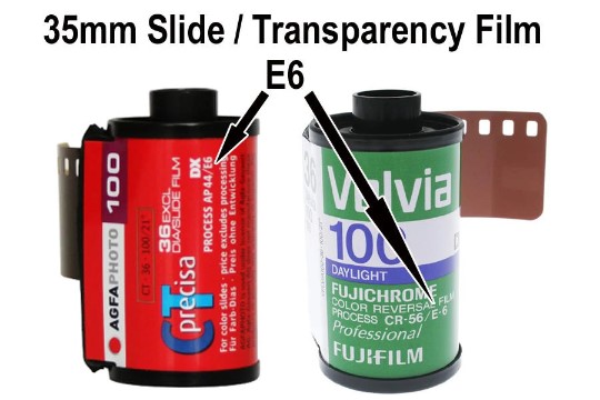

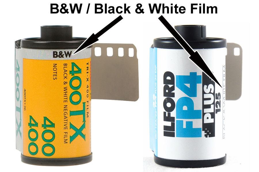

All films, on the cassette label, state what process it needs to be developed. The most common types are C41 for colour negative/prints, E6 for slides/transparency and B&W for traditional black & white.
When we were training a new person in the lab to sort film types, we used these images as a guide.
For colour prints/ film for colour prints, is I think self-explanatory (to me anyway)

With slide/transparency (E6) films the label usually said, colour reversal film or colour slide/transparency film, depending on the brand.
Kodachrome was the only one, AFAIK, that had for colour slides on the label.
