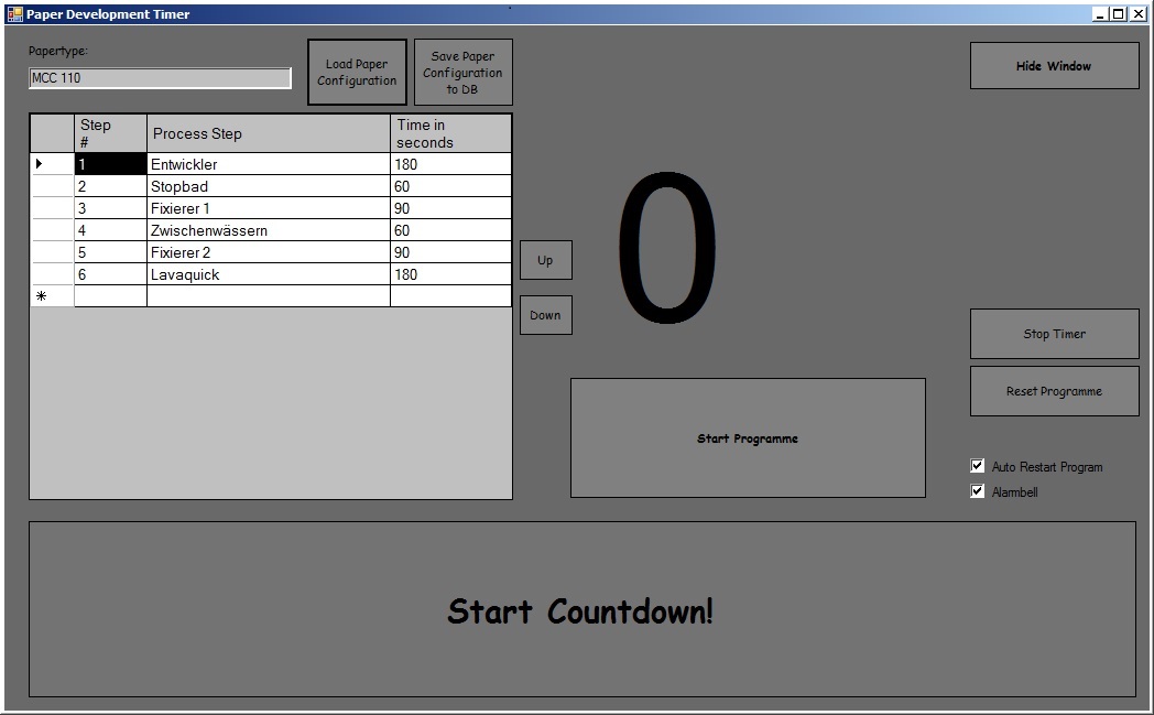

As I wanted to learn how to code anyway, I’ve started to develop a little C# program. Below you can see what the program can do at the moment.
The hardware to switch the enlarger on and off had to be really simple. So I chose this one:
http://www.robot-electronics.co.uk/htm/usb_rly02tech.htm
As this board has 2 relays, it can switch off the safelight while the enlarger is turned on and vice versa. All I had to do, was to screw in 3 wires from a double extension lead. That was great, as I have no idea how to solder.
So here’s what the software can do until now:

During paper development:
- A Countdown, (that also runs in the background) with alarm function to indicate that the paper has to change the station
- The sequence and times can be configured freely
- Possibility to store sequenceds and times for various paper types in the backend database

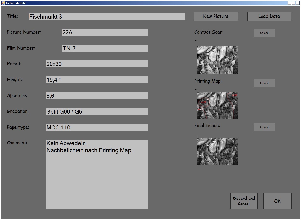

To keep documentation:
- All data for a picture can be stored in the backend database (MS SQL Express). With that data, the printing program sequence is stored as well.
- Possibility to store scans of the contact sheet, the printing map and the final picture in the database
