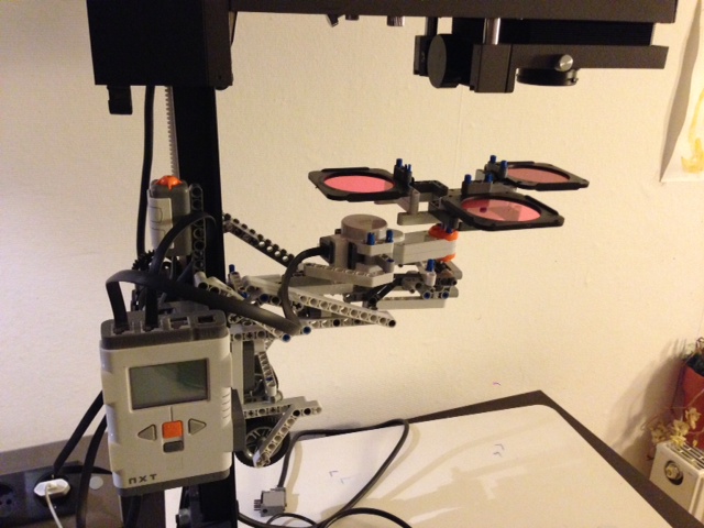

After a while, the living FPUs got bored with their task, so they helped me in creating an automated version using Lego mindstorms. See attached Pictures. :wink:
While this was a "just for fun project" to entertain my kids, I was surprised how well it integrated with the software program and the splitgrade approach. I was not just using filters for hard and soft contrast, which got automatically selected during the final print exposure sequence. Even better was the red filter, which automatically got moved out of the way after the pre-countdown is done and the exposure starts. This helps positioning the hands for dodging before the start. I thought that the vibrations introduced by the motordrive for the filters to the enlarger column would be more of a problem than they really were. Anyhow, that was just a PoC and it was fun building it. I think if I was going to incorporate such functionality productively, I’d rather use LEDs in green, blue/UV and red to get the same thing achieved.
