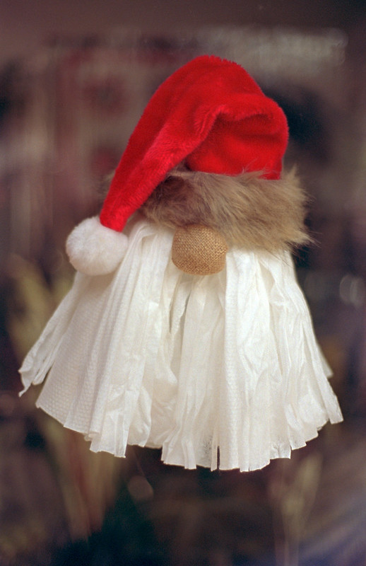

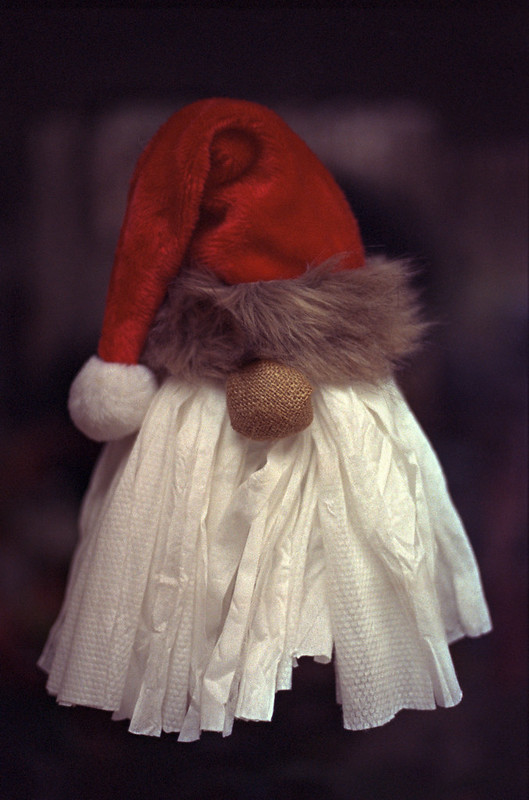

Those who have read the thread about a solvent for blix sediment will know I have been tempted back into C-41 development with the promise of speed and ease at room temperature. To be thorough, I have developed colour negative film at 39ºC/102ºF, at 20ºC/68ºF undiluted and diluted 1+5. These comparisons are full strength at 20ºC and full strength at 39ºC. The purple cast and lack of greens in the room temperature version is obvious. These images are the room temp. versions corrected as best as I could manage, but the 39º versions are uncorrected - just as they came out. There may be some exposure variation, as the room temp film was exposed in an F6 and the 39º film in an OM-2n. I need some variety, not being an absolute automaton. I also noticed my current presskit includes times for continuous rotary processors at various temperatures. I think my Rondinax qualifies and will try 90ºF/32ºC next for 8 minutes in both CD and blix. I can get my solutions to that temp in ten minutes, not the 90 minutes it takes for 39ºC (damn Newton's Law of Cooling!)
Room temp:
39ºC
There are more, and I'll add just a few. Clearly, the colours are far better at 39ºC. Eventually, I'll see if they comply just as well at 32ºC and 8/8 minutes instead of 3.5/6.5 minutes.

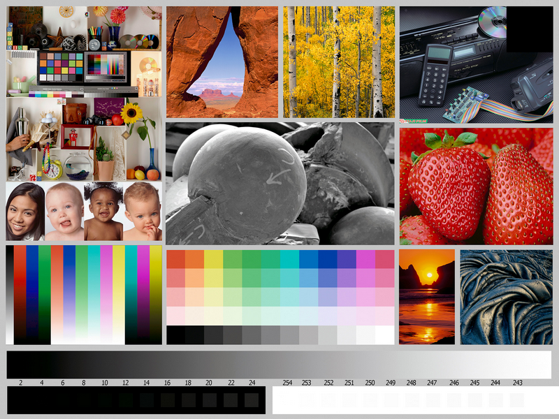

You need a better test subject!
Clearly this is a test subject for digital, but it gives the idea:

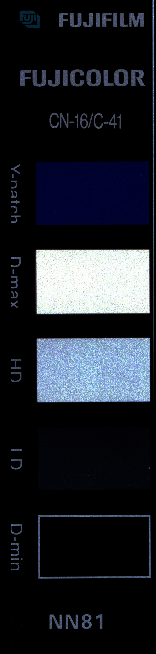

This is a test I did yesterday with an ECN2 developer that I made with my own hands.
39 degrees Celsius - 3:30 minutes,

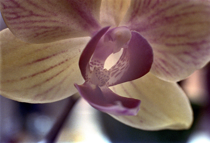

I don't take photos of colour charts. Maybe Matt likes orchids?
20ºC
39ºC
