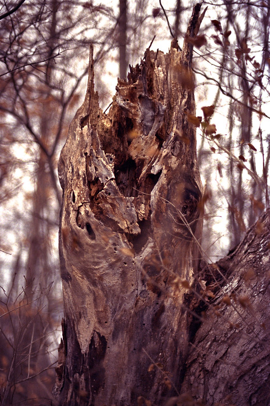

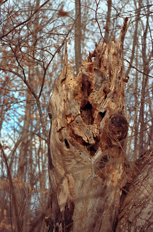

Here's another pair of photos that are not [The Scottish play] colour charts. You can likely guess by now which is room temp and which is 39º/102º:
Even without objective colour charts, it's pretty obvious that there is a consistent purple cast to the room temperature process, which is to be expected according to PE. I guess all I am saying in this thread is 'don't do this unless you want funny colours'.
