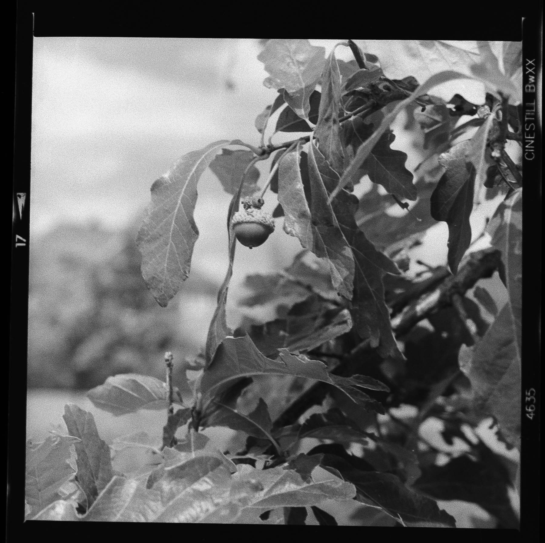

I shot and processed two rolls today. Pretty sunny and clear day, so I wasn't worried about exposure, and stuck to a sunny-rule. I used the film with no filter, and with an orange (3x) filter.
I mixed a fresh batch of D-96 following Kodak's recipe, and processed 6 mins at 21C.
Looks nice and sharp as it's drying, but the thing that strikes me the most is the base. Either it's very grey, or it's a bit foggy, because it's denser than the 35mm Double-X, and denser than the usual 120 base. Might not make a difference in the end (cf. Berenice Abbott: "fog? what fog? just print through it!").
