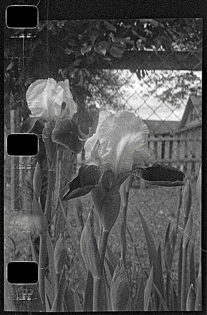

This was shot on 16mm Double-X and developed in Pyrocat-MC for 15 minutes. I used the times for Pyrocat + Tri-X @ 200 on the massive dev chart as a starting point.
It came out pretty grainy but that's no issue for 120.
