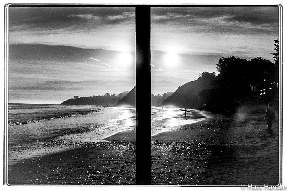

Olympus PenFT, 40mm 1.4, Efke 25 expired 2000, DF96
The Efke 25 expired 21 years ago. I shot it at 25, had no idea how it was stored, and looking at the results should have should it at 12 or 6. C'est la vie!
In this case, the exposure works tho, really nice set and cool use of the Pen's funky format.
Thanks, but it really only works because my digicam scan was able to capture what info was there. Ideally it would have had a stop or two more light (which is what I had intended) and would have been a much cleaner image.
My fault for forgetting I had that 'throw away' roll of film in there. Shame cuz it was a long drive! I'll definitely be going back. This time with fresh film!

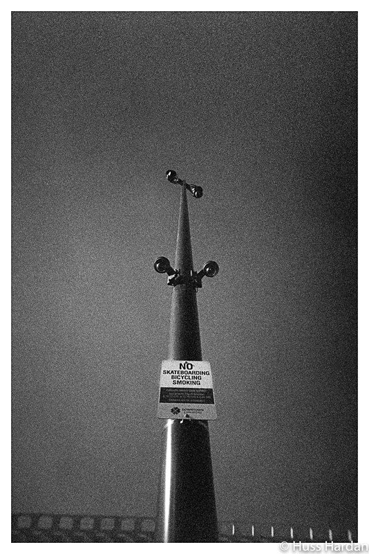

Nikon N75, 28-80 4/5.6G, Tri-X, DF96 Monobath
This is the first time I tried the constant agitation method of developing with DF96. Temp was 80.
The reason for this was that I was developing two rolls of film and that required 650ml of solution.
Unfortunately there was only 600ml left as I was on my 22nd roll from the bottle! (A mix of 24 and 36 exp rolls).
So I went with the constant agitation to make sure that there would be sufficient developer coverage.
Interestingly using this method with TriX resulted in finer grain and a slight increase in sharpness compared to my usual 70 and intermittent agitation method!
Great results, continuous agitation ended up being my fav method for DF96 too, Rotary in a Lab-Box.
I havent used any other tanks since I got the L-B in the fall. DF96-D76-RO9.
Beautiful. I will try it. The grain on your sky is excellent and the range of tones on the sky and the arching edge of the roof (?) is wonderful.
