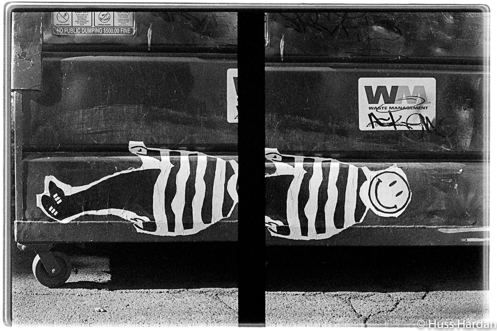

I began posting here in the color section because I had intended to learn how to develop by going straight to C41. Ultimately I ended up going with B&W and DF96 just to get a taste. These images are from my first attempt, which took place Saturday. I'm pretty happy with the results, although I'm sure those with a critical eye will find issues. I figure I'll get better as I go, may try some other methods and chemicals. Anyway, like I said, I'm happy for a first attempt, and I honestly don't know how it could've been easier.

What film and how did you digitize? Nice images.

Thanks.
Kodak T-Max 100. Digitized with a Panasonic G9 and 25mm lens w/extension tube on a copy stand. Negative was in a holder made for a flatbed scanner, light is an LED lightboard. Converted and processed in Darktable.
