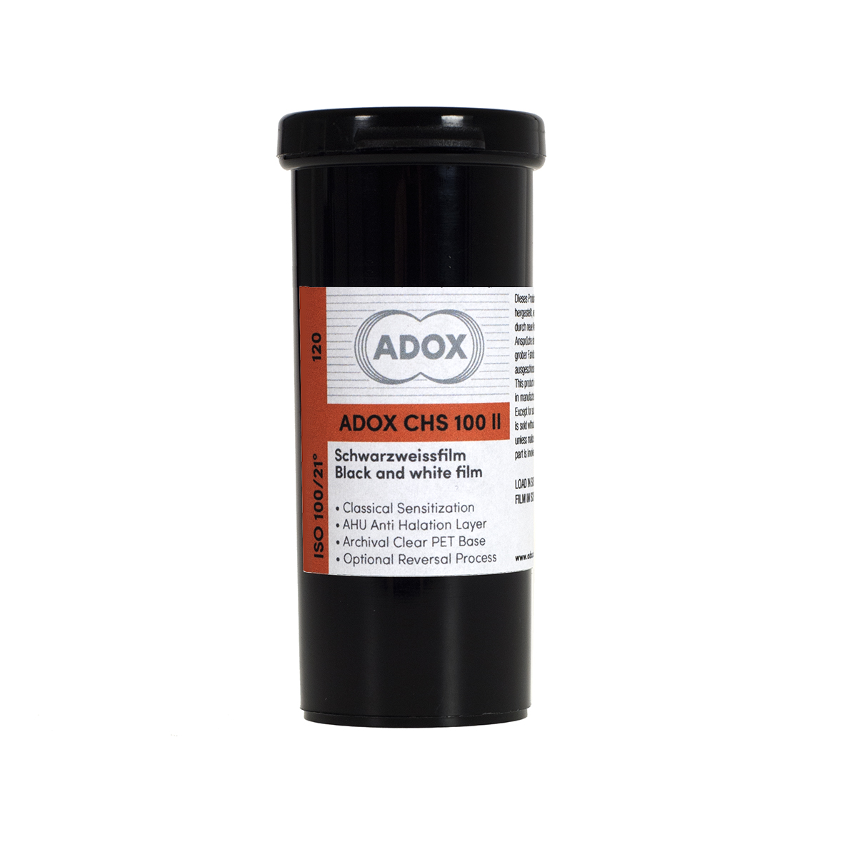

Just in time for the holliday season: CHS 100 type II is now available in 120 as well.
Europeans can shop directly: http://www.fotoimpex.de/shopen/films/adox-chs-100-ii-120-medium-format-film.html
We introduced CHS 100 type II as a follow up to our beloved CHS 100 type I which Fotokemika took from us in 2012.
We have tried to match CHS 100 II as closely as possible to the old film featuring:
a rock solid classic emulsion system which has been out there for decades
a sensitization close the one of the old CHS 100
a single layer emulsion
the same base material including the option of reversal processing
an optimized backside coating to fully prevent light piping if the film is loaded in subdued light
a special anti halation layer between the emulsion and base for enhanced sharpness
a full set of formats from 35mm to ULF including 120
a state of the art cascade coating avoiding all problems associated with older CHS100 Type I productions
The new film is manufactured in Germany and thus upgraded to our professional line.
* Certain tips which we have published in combination with the older type I film like using only ion-exchanged water or prewatering the film before the devlopment are still a good thing to do but because of the more modern coating and hardening of the emulsion not required anymore.
Product page: http://www.adox.de/Photo/adox-films-2/adox-chs-100-type-ii/
