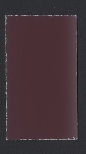

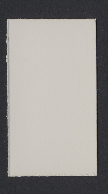

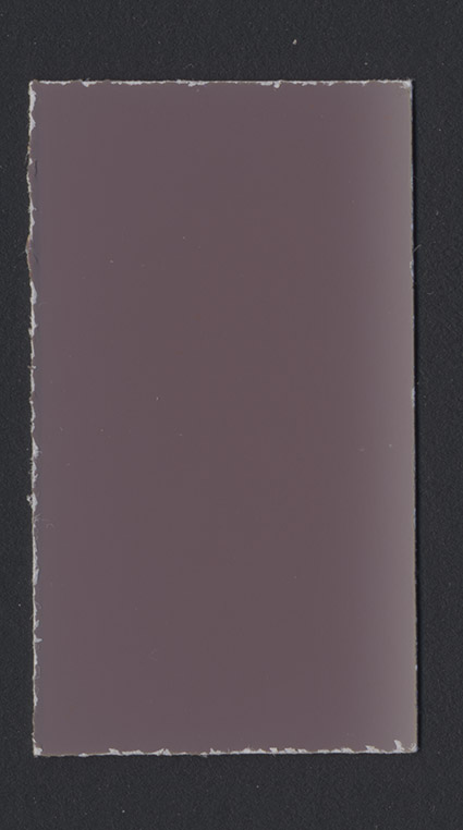

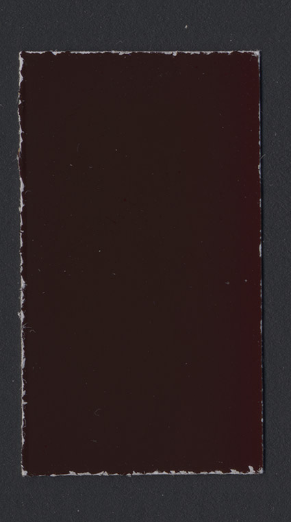

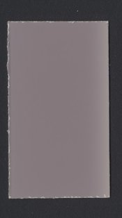

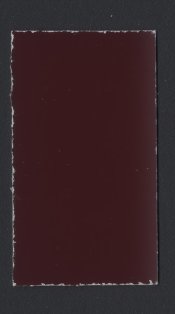

Once I tried to see what the base paper measures in the scanner so I can compare with processed paper. So I put a piece of the POP in the scanner. To my surprise, it started getting exposed right away from the very first (preview) scan. So I set it for continuous scans to see how far it can go. In about 30 minutes it seemed to be nearly fully exposed. Here are some of the scans:
2018-04-28-0003.jpg 2018-04-28-0005.jpg 2018-04-28-0007.jpg 2018-04-28-0010.jpg 2018-04-28-0015.jpg 2018-04-28-0019.jpg 2018-04-28-0020.jpg
The scanner was Epson 3200. The scans are very roughly 0, 2, 4, 7, 10, 15, 30 minutes of total scan time.
View attachment 215113 View attachment 215114 View attachment 215115 View attachment 215116 View attachment 215117 View attachment 215118 View attachment 215119
