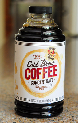

I found the Trader Joe's cold brewed coffee containers are perfect for metal developing tanks. When completely full they hold exactly enough to fill an empty tank (4 - 35mm reels). When you put 4 empty reels the water level is flush with the top so the bottle holds just enough that as long as its up to the neck, you get full reel coverage. ( They hold just a smidge under a liter)
This is the same container:
http://www.freundcontainer.com/32oz-clear-pet-stepped-bottles/p/36232-B/
For some reason Trader Joe's stopped selling the coffee with lids that have the P/E foam liners...stupid! Anyway, I was able to find lids at different companies:
http://www.freundcontainer.com/white-polypropylene-flat-plastic-caps-f217-foam-lined/p/X38-400/
or
http://www.bottlestore.com/caps-and...bbed-side-matte-top-plastic-ct-cap-f217.html?
The lids are 38-400 sized and also fit Datainer Gallon sized containers. The lid is large enough for a funnel to sit stable and the bottle shape is good for pouring into the developing tanks.
I just bought a bag of 100 of the lids for $19 shipped. My 8 Datainer's lids had warped and had no seals so this was a decent deal. The Freund sore has three colors but charges $13 shipping.
