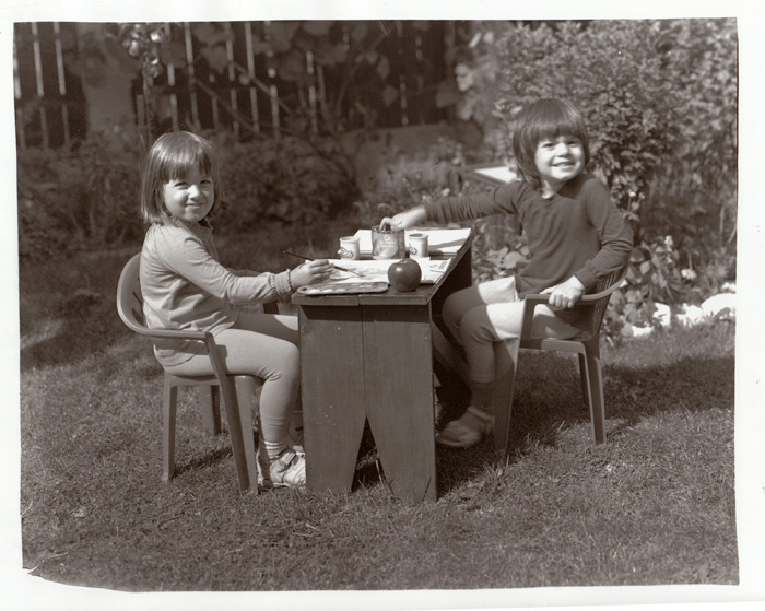

Here's my first 8x10", made from a more contrasty negative.
I used some cheap black watercolor (not the pigments I bought yesterday - those will have to wait until I get more dichromate). It was indeed much easier to mix than the powdered lampblack, and this time the surface has dried smooth, with no bumps.
This is one of my first negatives developed by inspection. At that time I was still experimenting with DBI and hadn't yet learned how the image should look under the green light when it's finished. I developed all sheets until I could see the image nice and clear on the back of the film, by which time they were already strongly overdeveloped. This was a good thing, though, because they now make beautiful vandyke prints. :D

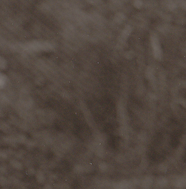

The trouble with liquid pigments is that you don't know what's in them. I think this watercolor had some traces of oil, because I got some streaks (see the attached crop). Besides, the overly warm tone doesn't quite appeal to me.

Vlad, those streaks, because they are so regular in size and direction, look like what I call "stress lines" -- created when removing the the temporary support during development. The more force one needs to use to separate the temp support from the final support, the stronger these lines get. The "stress lines" are ridges of unexposed gelatin that will disappear once development in the hot water is complete. If there is any hint of them on the print when one stops the development, they'll get slightly darker when the print dries. I always get these lines and use them to tell me when development is complete!
I of course could easily be wrong, but that is what the image looks like to me.

I assumed those lines were caused by the pigment because of what Sandy King says in his article:
"14. The final image contains streaks.
Cause: In the home manufacture of tissue one will find that certain pigments, most notably some varieties of lampblack, can cause slight streaking on the face of the tissue. This apparently results from a small residue of oil in the pigment. If this problem occurs, eliminate the guilty pigment. The problem can also result from inadequate dispersion of the pigments within the gelatin solution.
I developed until the water that dripped off the print when I lifted it out of the tray was perfectly clean, with no trace of pigment. Maybe I should have developed longer. Next time, if I see any streaks I'll prolong the development.

Streaking -- I believe Sandy is referring more to an oil-slick looking type of streaking, rather than the more regular pattern on your print.

Vaughn, you were right. They were indeed stress marks. I reimmersed the print in hot water and left it face down for half an hour, then let it dry overnight. All streaks are gone.
