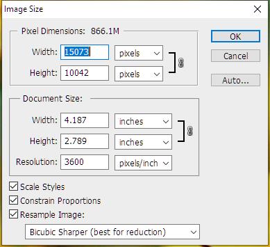

But, I do have one last question:
After I scan a negative at 1600 ppi and then pull it up into PS. When I go to "image size" it asks me to plug in the resolution. Is that where I would plug in 1600? When I do so, it makes the file go from 80MB to 3GB
Here you have me confused. Why is PS asking for the resolution?
A screen shot of the image resize box as it first appears. The butterfly photo in post 16's main file is the image the values are for.

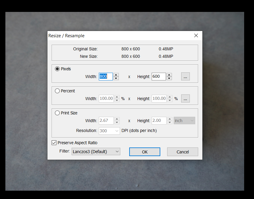

No wonder I like using FastStone Image Viewer :D
Photoshop's Image Size dialog isn't *that* bad. You just select the units you want to work in for the image Width and Height, then set the resolution you want. Typically if you're prepping for print, regardless of image size, you set the units to inches, then check Resample and set the resolution you're going to print at, then set how large you want the image to be in inches. PS resamples it to the correct number of pixels needed to print at the resolution you put in. If you just want to resize the image, then you leave Width and Height in the Pixels unit, check resample, don't change the resolution box and simply put in the new pixels dimensions for the width and height. PS will resample it to the new dimensions.
MattKing
Apr 24, 2005
54,717
Delta, BC Canada
Res Ipsa Loquitur
:D:angel:
Actually, the Photoshop Resizer is one of many things in that program that show that Photoshop is/was essentially a commercial graphics program that people have re-purposed as a Photography tool.
FastStone is a lot more prosaic.
And its resizing tool is one of its strengths.
And it is small and quick and requires very little computer overhead.
And it is available free/by donation.
No Mac or Linux version though.
