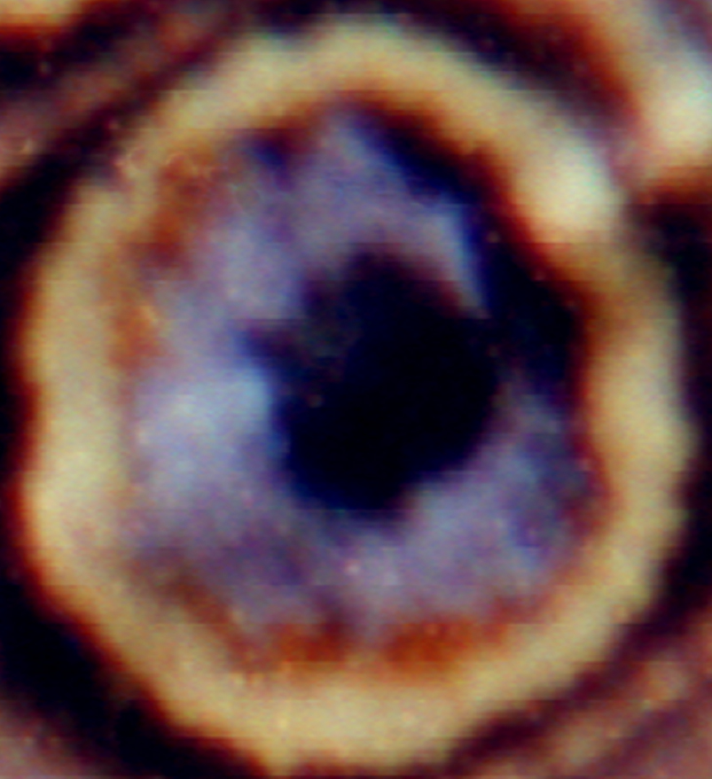

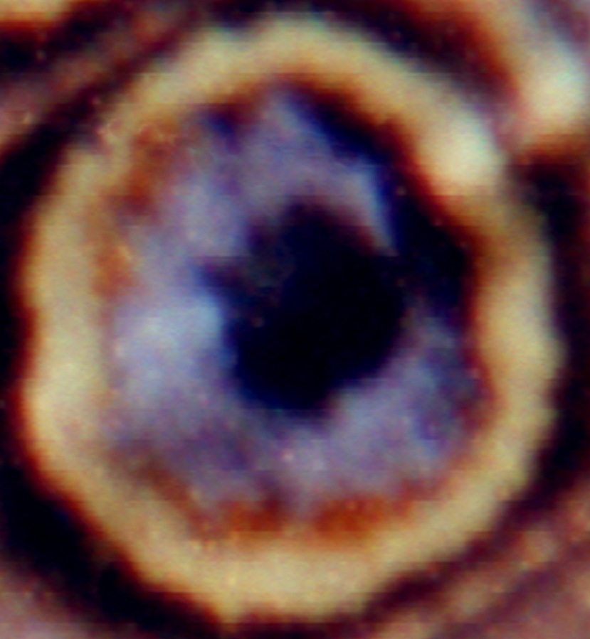

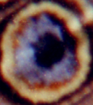

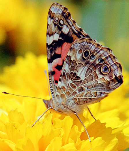

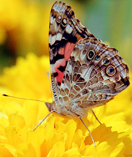

I recently took a photo I made with a D300, saved as camera raw, converted to 16 bit Tiff, then upsized it to 4x in CS5 in steps as shown in post 3 and it retained all the detail just as sharp as the original file while the jump from original to 4x produced soft edges.
The same will hold true for scanned film as its how the software works.
Photo 1 is a 1/3 frame crop from a full frame Kodak color film (don't remember which one) scanned at 3600 dpi, 16 bit RGB; a 866mb file. It was reduced in CS5.1 to fit this fourm in resolution steps 3600>2400>1200>600>300>150 dpi then 16 bit to 8 bit, image 4.187 inch x 2.789 inch print size.
Photo 2 is photo 1 original file scaled to 10 inch wide with constrain proportions selected in steps 4.187>6>8>10 inch, butterfly cropped, resulting file resolution reduced as photo 1, final image size 2.98 inch x 3.487.
Photo 3 is photo 1 original file size scaled to 10 inch wide without steps, cropped as photo 2, reduced in resolution in steps as photo 1.
Download then zoom in 60% to 100% to see the fine detail difference of the scaling.
Photo Crop 1 is the original file at 100%, changed to 8 bit then saved as jpeg max; crop 2 is photo 2 scaling at 100% changed to 8 bit and saved as jpeg; crop 3 is photo 3 scaling changed to 8 bit and saved as jpeg.
