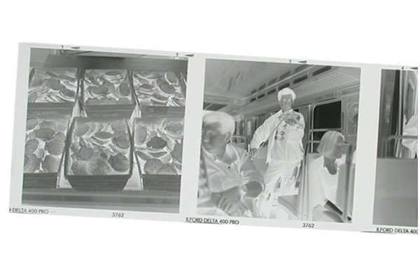

Are they on the emulsion side or the base (shiny) side of the negative?
Also, it might help if you could post an image of the film strip, something like this:
(not my image)
