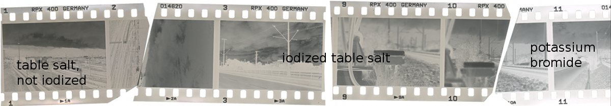

I tested 100 ISO film (fomapan 100) with and without iodized salt and could see a clear difference in fog level between the two. I prefer less so I use salt, but that didn't mean that the fog couldn't be print through.

So iodized table salt will work instead of KBr, with less smell
Not as good as Kbr. Here a test from Reinhold (imagesfrugales) :

If that is caffenol, then salt help minimizing the stain (vitamin C does too)
which is different than fog
But you need 20g/L, compared to 12g/L for iodised salt (0.0025 % iodate) and 1.2 g/L for Kbr.
With salt you will get dichroic fog, less with iodised salt and not with Kbr. Here the reference.
