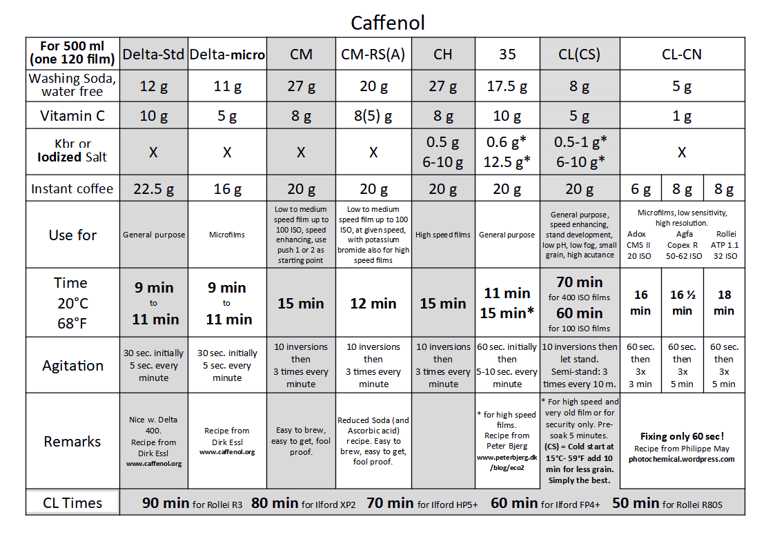

Here some more recipes :
That chart is very handy, I'll have to print it and laminate it. Looking like Delta Standard is a good starting point for my inversion tank developing.
