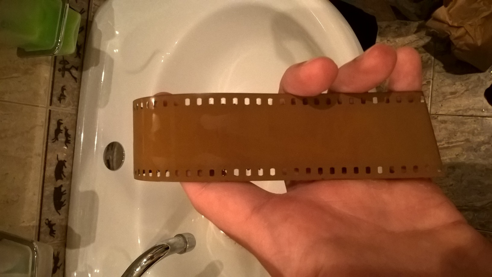

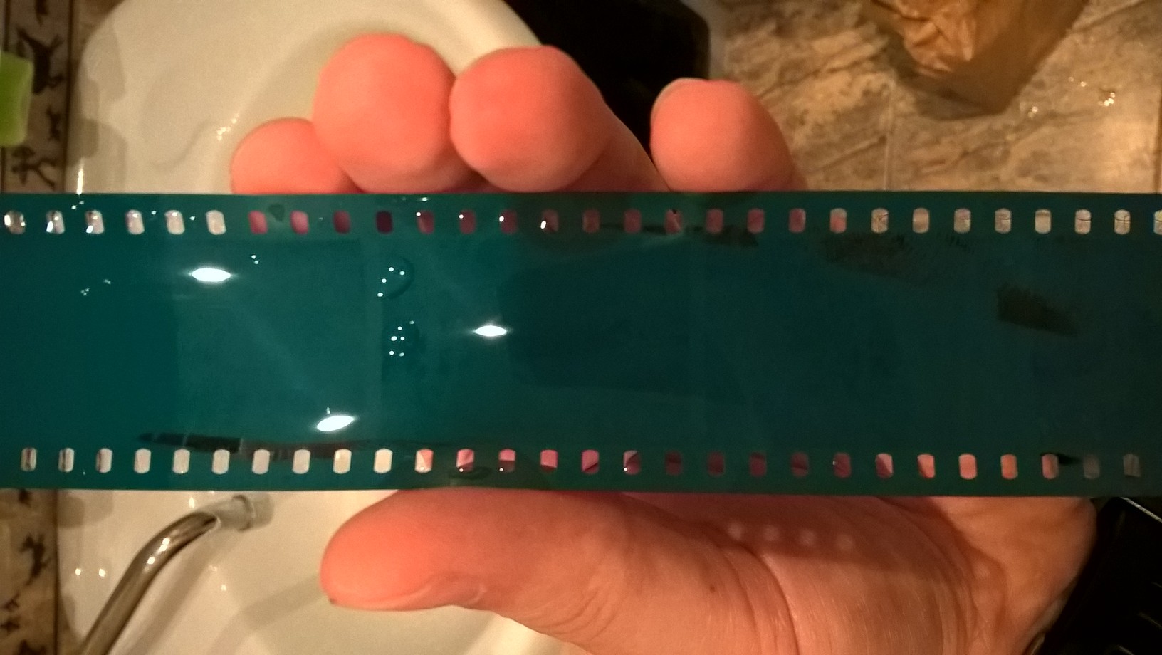

From January with Yours advice's I was manage to develop more film with different degree of success. Now I got something entirely new. My negative came out green, like emerald green, and extremely dense. Am I right to assume that this is because the developer is dead? As always, thanks.

This looks a bit like film that wasn't bleached.

Hi, your film example looks to me like it has not been processed.
At first I was going to say that it's not fixed, and to get it into fixer pronto! But... there is no sign of any image on the emulsion side (tan); this suggests that either your developer is dead, or the film was not exposed. Additionally, the fixer seems to have been skipped, or is also bad.
To check the chemicals, dip a bit of unprocessed film in the fixer - it should "clear" in several minutes. To check the developer, dip a bit of unprocessed film (you can clip a bit of leader from 35mm film) into the developer for several minutes. Do this in the light. If it doesn't darken, then the developer is dead.
Mr Bill
Aug 22, 2006
1,483
It would look that way only with total fog or red safelight fog.
Maybe, but what would be the explanation for each side of the film having a different color? (The photos in post 36 seem to show a shiny "greenish-cyan" side and a duller tan-colored side.) When I look at Dmax (processed) film, held in the same manner as the OP's sample, both sides appear similar - dark.
It should be simple for the OP to determine if it's red-light fog vs unfixed film - simply look at a bright light through the film. If the lamp can be clearly seen through the film, then this indicates normal dye formation (even though possibly fogged). Otherwise, it's not adequately fixed.

Bill, either condition would show the cyan layer and the yellow. We cannot say at this point which, fog or contamination, has caused the problem.
