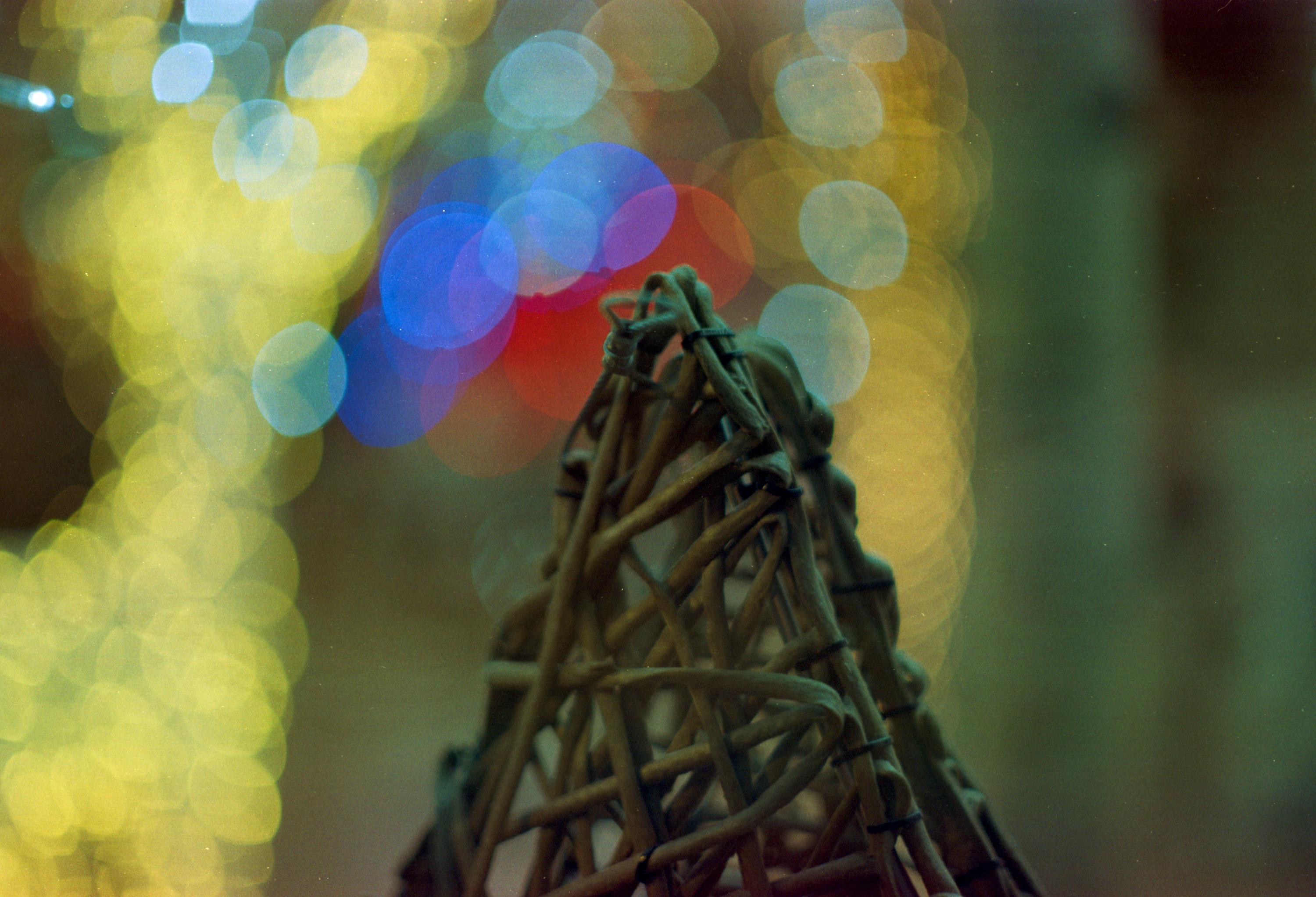

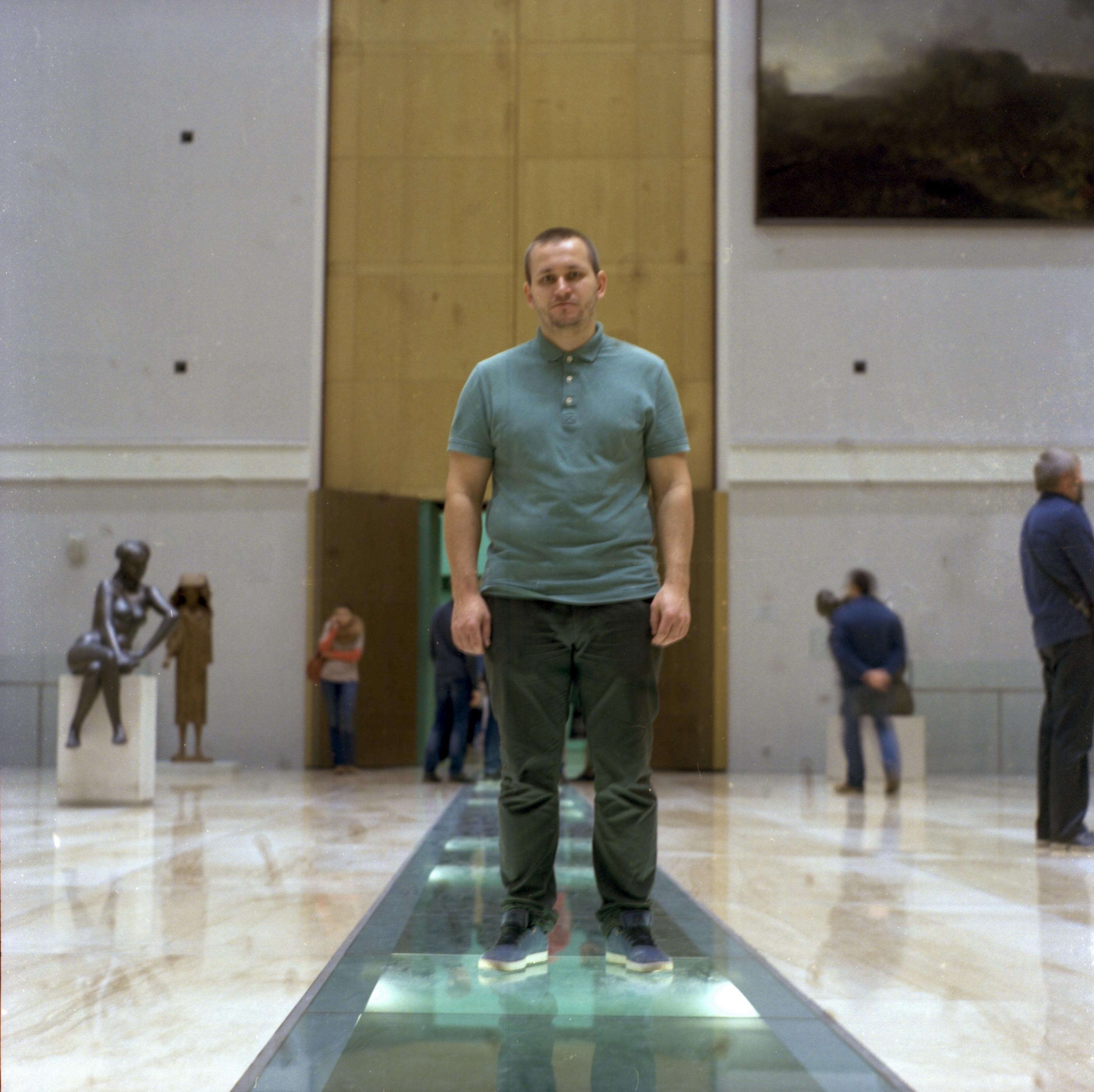

Hello all!
Started experimenting with diy development of color film. But I clearly am doing something wrong.
1) I'm using Jobo CPE processor
2) 270ml of solution (I use original Fuji NQ1-RS), BUT no developer starter
3) 38C and 3.15 min constant rotation in Jobo
4) Stop
5) DIY bleach for 8 min
and so on ...
I got purple cast close to film sprockets and overall strange colors
WHat am I doing wrong ?
attachment.php
attachment.php
Thanks.

You do not need the starter. Perhaps you should use stop bath after the color developer to avoid chemical crossover. Ask PE.

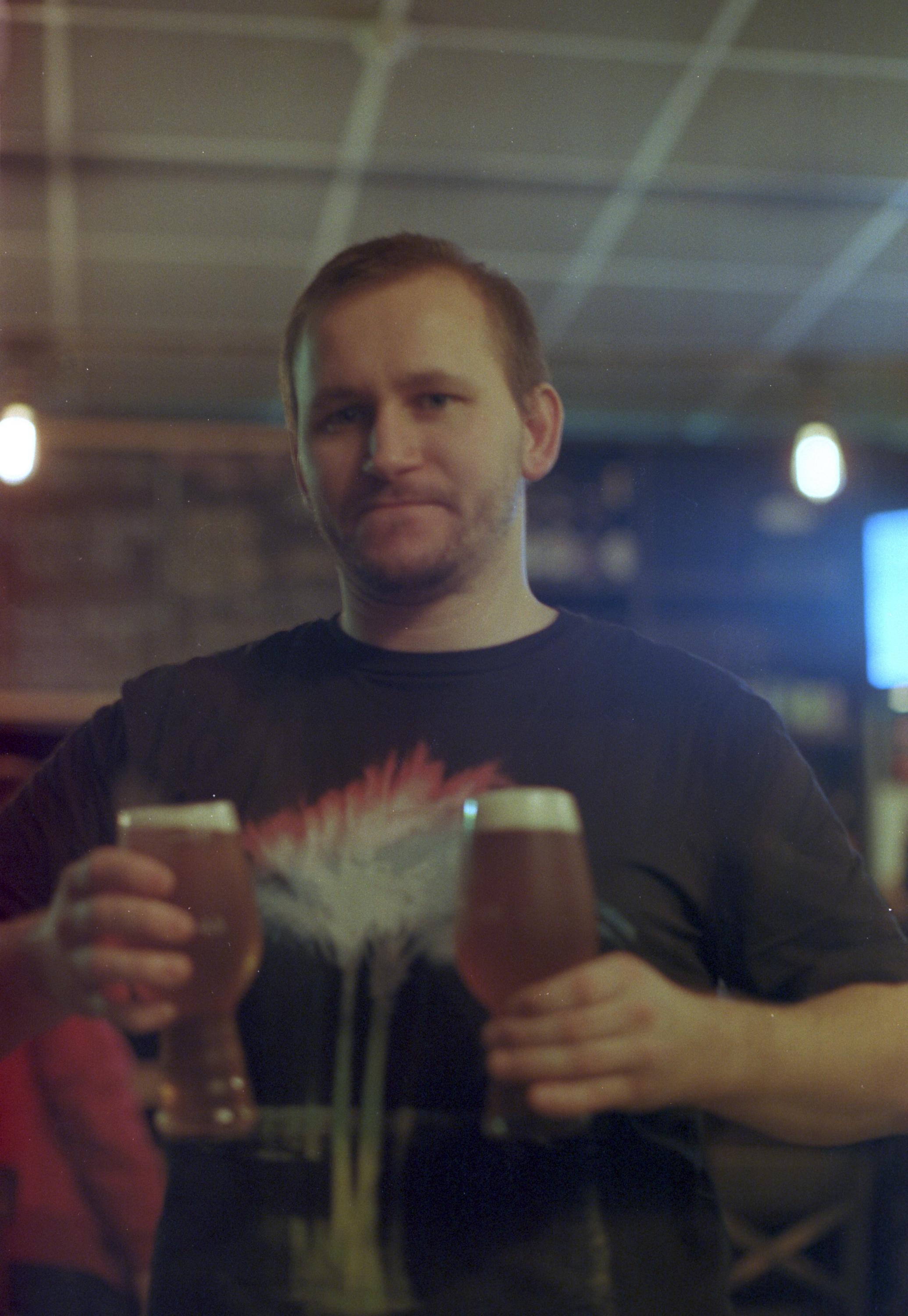

The first shot is difficult to judge, but the shot of the guy with the beer looks as if it might be a tad underexposed (and perhaps not helped by flat lighting?)?
If it is a C41 developer (not replenisher), then you do not use starter. If it is Replenisher, then you must use a starter. This is for C41!
As for the samples, it is impossible to say without more scans and perhaps a picture of the film strip itself.
PE
PE

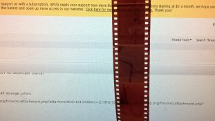

Thanks everyone for the answers.
Added two more photos. One clearly has purple cast on top, second is negative
Maybe it is my monitor but I don't see any purple cast. As for the photos, looks like fluorescent lighting. If so, this is the problem. Fluorescent lights have a discontinuous spectrum as opposed to tungsten or day light. That can cause a cast.
PE
That's because it's Magenta :smile:
I'm having difficulty seeing a purple cast as well, but I think I see something in the photo of the gentleman in the green sweatshirt - on the walls around the pictures and to the left of the window. I also see a green cast at the bottom of the photo (at the corners, most obvious on the right).
I know nothing of these things, and haven't done color yet, but it seems similar to other examples where it was determined to be uneven development due to a water "stop" instead of an acidic stop bath - though the OP stated stop was used.
But magenta is not a color!
Purple/magenta: yes it's definitely there. Why is it close to sprockets? It's most noticeable in the dark shadows, it's like my black color became magenta.

Done more development. Looks like You were wright. A proper stop made everything better concerning purple/magenta cast. But now I've got a problem with grain. My negatives come out with base color very similar to the one I've got in the lab, but the image itself is very dark. I doubt it is overexposed, since I've made exposures with different cameras, and after development they all look the same.
So as I told before I've used replenisher + 20 ml of exhausted developer (as starter) for 280ml total in Jobo CPE for 3.15min at 38C. Can the grain and dark color be the result of overdevelopment?
Thanks.

Grain depends on the film and exposure. Fast film gives more grain and more exposure gives more density and more grain.
PE
