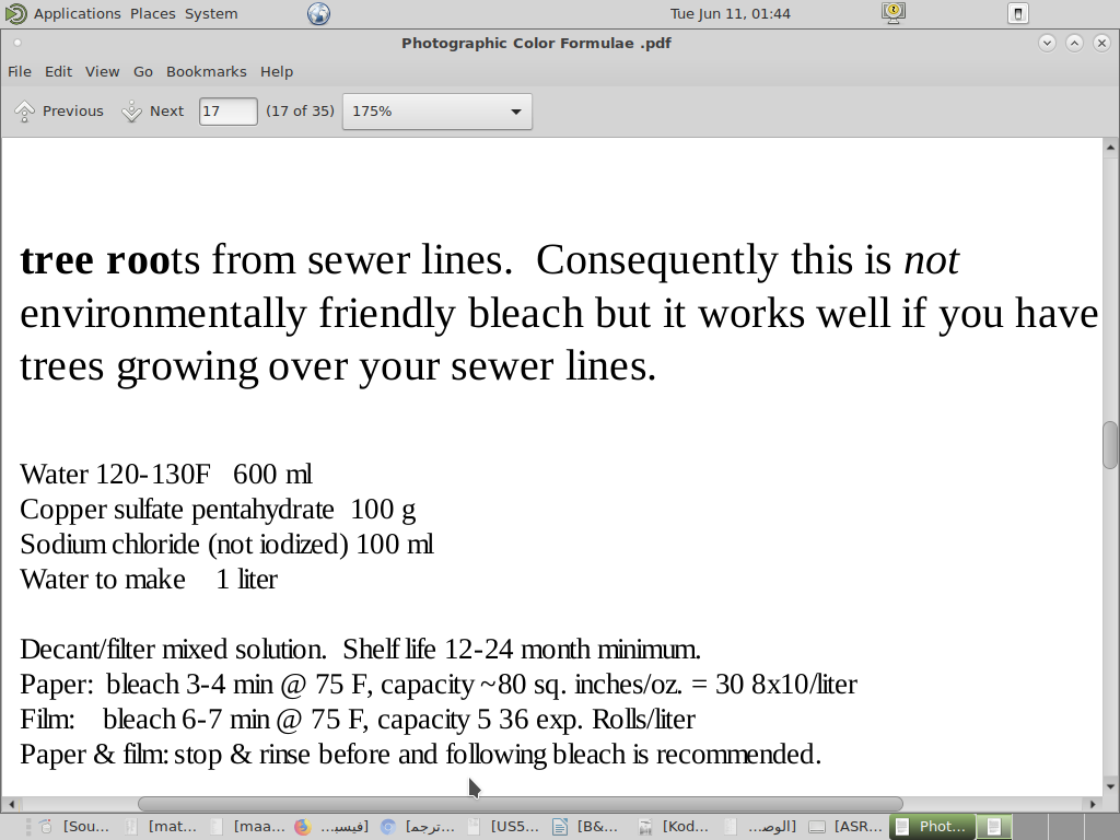

Is this bleach still effective today if it is used?
What is meant by (not iodized)
Sodium chloride is available in powder form. How do I convert it to a liquid (not iodized)
Tab Water 120-130F 600 ml
Copper sulfate pentahydrate ..............100 g
Sodium chloride (not iodized) ..........100 ml
Water to make 1 liter
bleach 7:15 min @ 75 F
stop film & rinse before and following bleach is recommended
This is a bleach which likely works, but one that was not formulated for C-41 process. It may be too strong and may kill some ancient C-41 emulsions, but most modern color negative films will likely be properly bleached by it.
About the "Sodium chloride (not iodized) .... 100ml": most likely that's a printing error and 100 g of that compound are meant. Normal table salt you buy for food&cooking contains some intentionally added iodide in order to prevent some ailments coming from insufficient iodide in our nutrition. If you use iodited table salt for making this bleach, you will form Silver Chloride and some amount of Silver Iodide. In black&white processing this may be an issue (that's why the formula wants non-iodized Sodium Chloride), whereas for your C-41 bleach it really doesn't matter.
PS: lots of C-41 home brewers use a very simple bleach made from Potassium Ferricyanide and Potassium Bromide, both of which used in amounts of 10-30 g/l. C-41 film is not rated for this bleach either, but since so many home brewers use it anyway with no ill effect, there's a very high likelihood it will work for you, too. The Copper Sulfate bleach, on the other hand, hasn't been used by many so far, so you may be on your own with this one. The ingredients for Ferricyanide bleach should be much easier to get than those for Ammonium Ferric EDTA or Ammonium Ferric PDTA type bleaches.

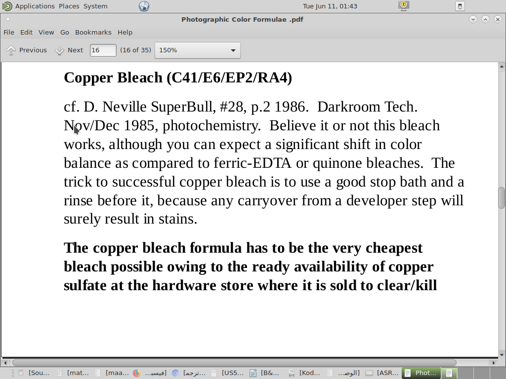

In fact, I brought that recipe from the files attached to the forum and it is actually considered the oldest prescription to be written before it (believe it or not) that this recipe is still working efficiently as long as it was used (solution of stopping and washing) before and after bleaching.
What prompted me to think about that formula is the ease of getting it.
As for Ferricyanide, the dealer told me that he was not authorized to sell it to ordinary citizens unless they had a laboratory with a legal license, and of course that dilemma needed some time,
And for Ammonium Ferric PDTA. , The dealer told me that the quality he currently has is not very clean, so maybe it will be useless.
In fact I am really puzzled by the issue of this typo,
I will attach the photo of the document until you tell me your opinion.
God bless you

FYI: I have not tried this copper bleach with color materials, but have used copper-based bleaches with both collodion negatives and paper. I find that copper bleaches sometimes give unexpected problems with partial bleaching and solarization effects. It may and should work well in theory, but be ware of unanticipated problems.
As a sidenote: I wonder if the use of sodium chloride could slow down bleaching and if eg potassium bromide would make a better alternative to it.
@mohmad khatab : if you are unable to get a chemical compound as simple and non-hazardous as Potassium Ferricyanide, how can you get the other ingredients for C-41 color developer? Stuff like Hydroxylamine Sulfate or whatever precursors you need for making CD-4 ?
Is there a chance you confused Potassium Ferricyanide with Potassium Cyanide, which is a completely different compound? Potassium Ferricyanide, the compound you want, has the chemical formula K3Fe(CN)6 and CAS number 13746-66-2.

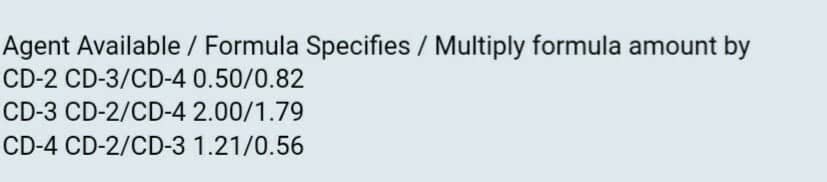

- Meanwhile, my Ukrainian friend told me / Vova Matveev
And he told me that it is no harm to try CD3 replacement instead of CD4 according to the principle that you set yourself and the picture attached,
- One of my colleagues also told me to follow the same path (as long as needed) taking into account increasing the process temperature to 40 degrees and increasing the working time to 4 minutes instead of 3:15.
- Overall, I will try to try this experience in the coming days as soon as I have completed the rest of the material I need, I am currently waiting to get (HAS)
The issue is only a matter of time.
CD4 is very polar, but CD3 is quite non-polar by comparison and thus most CD3 developers in the past have used Benzyl Alcohol or a high pH to get the proper dye formation. I would thus suspect that the use of CD3 will give low contrast and saturation.
PE
CD-3 works without Benzyl Alcohol and at moderate pH for ECN-2 process. Since ECN-2 film stock can be cross processed in C-41 CD (give or take a few color oddities), I would assume the opposite direction would work as well, as long as the somewhat lower activity of CD-3 is taken into account.
