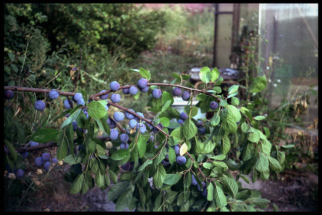

Test pic. LOMO SMENA 8M, Fuji Superia 200 (exp.14). Dev. time 3.15min (38 deg.C), blich time 5min (Fe(III)EDTA), Fix time 5min.
