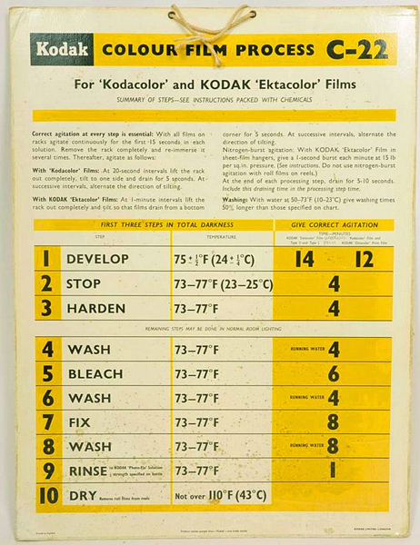

Anyhow I am going to source the C-22 and E2/E3 literature and read through so I have a clearer understanding of what chemicals are used. I have on me a downloaded scanned C-22 instruction list (see image below), I am thinking of from now on using that method after the colour develop stage for my C-22 films, seeing it doesn't have "harden fix" can I use Chrome Alum for just hardening the film before wash and Ferri/Br bleach and then use Ilford Rapid Fixer for just fixing the film after bleaching and washing? If yes and my films are guaranteed colour/image stability and longevity with that opposed to blix then I will stick to that method as I do want the best for my films. For the rebleach process I am going to now order the appropriate chemicals for the hardener fix.

Ok, Step 3 is "probably" chrome alum. Step 7 is "probably" an acid alum hardening fix. Two different hardening agents that Kodak just did not disclose.
The big problem is using a blix. A blix will not complete the dye forming reaction that the Ferricyanide bleach will and thus dyes will be low in saturation.
