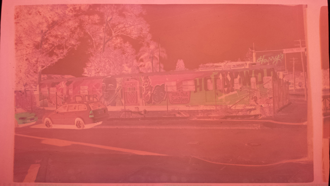

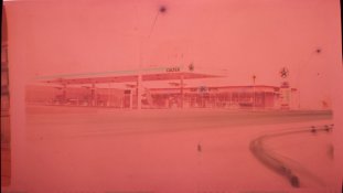

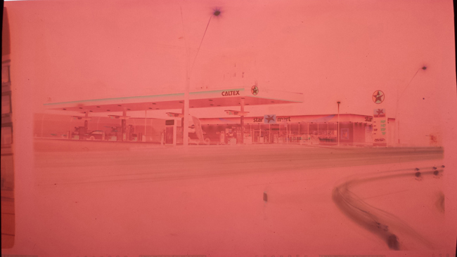

I've recently been shooting unused vintage colour films from the 40s, 50s and 60s and have been cold developing them with my Tetenal C-41 colour kit and have had mixed success, the best result I got was 1958 expired Kodak Ektachrome 120 https://www.flickr.com/photos/51853869@N08/sets/72157644477261449/ and the worst results in terms of colour I got with early 1950s era Kodak Kodacolor films which is the main focus of this thread. Two of my early 50s Kodacolors I developed using the cold C-41 method gave me almost completely blank amber base so I decided to do some test exposures and investigate what was stripping the emulsion. So after some test develops I found that the blix was dissolving the emulsion on the film and so I decided to do a colour develop and fix only instead of blix which successfully gave me pictures but the colour is almost non existent. The developing details are as follows:
Colour develop 6 min at 20 deg C
Wash 3 min
Fix 5 min in Ilford Rapid Fixer
Wash 5 min
Stabilize 1.5 min
With a lot of Photoshop manipulation I was able to bring up some distinct colour in my films though with annoying jpeg compression artifacts due to my crude method of scanning with overhead projector light and mobile phone camera to capture the images. Anyhow here's what I was able to produce with two of my early 50s Kodacolor films Dead Link Removed Dead Link Removed . When I have these films professionally scanned like with my 1958 Ektachrome I will be able bring up better colour pictures.
Anyhow I would like to find a way to bring out rich colours in these old vintage Kodacolor films and I was wondering has anyone here shot early Kodacolor films that old and have successfully colour cross processed them in C-41 and if so I would love to know the developing details. Next time I get a C-41 kit I am intending to keep the bleach and fix separate so I can do them processes separately and see how it goes.
Lastly I actually had more success in processing an even older Kodacolor film that expired in May 1945, I cross processed it in C-41 at 18.5 deg C colour develop, 8 min blix and 1.5 min stabilize and here's what I got https://www.flickr.com/photos/51853869@N08/sets/72157644891640934/ , in some shots there is distinct colour in others I got mostly cyan toned monochrome pictures, I have of course adjusted these photos in Photoshop for best possible colour and picture depth. Interestingly the negatives on this Kodacolor were blue just like that of reversal colour film. I read that prior to C-22 Kodak had three different Kodacolor designs and developing methods between 1942 and 1955.

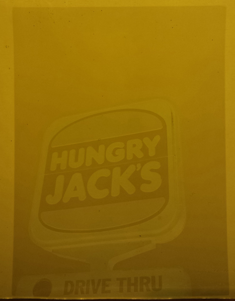

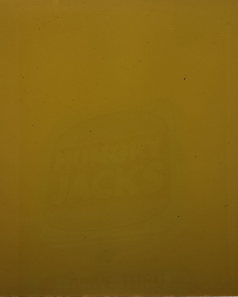

I have now hardened/bleached my 1954 Kodacolor 120 film going by the given sequence using C-22 process times:
Rinse 4 min
Harden 4 min
Wash 4 min
Bleach 8 min
Wash 4 min
Harden 8 min
Wash 8 min
Stabilize 1.5 min
Done at around 17/18 deg C
The results unfortunately are very disappointing :sad: . The picture's depth of contrast is now lost and the picture is barely visible, on the other hand it appears I can see a bit more colour but the images are not going to scan too well. The negative looks quite similar to the other 1954 Kodacolor 120 that I blixed and got ultra faded negatives. I have attached a couple of photos showing the film before when it was colour developed and fixed with a B&W fixer and after being bleached and hardened. For the bleach I used 40g Ferricyanide and 30g Bromide to make 1L and for the Chrome Alum hardner it was 100g in water to make 1L. I really wonder where I went wrong and I know this is probably wishful thinking but is there any way I can bring the depth of contrast back?

Please see my post #3. You need a hardening fix in there, otherwise the images will discolor due to retained Silver Halide.
