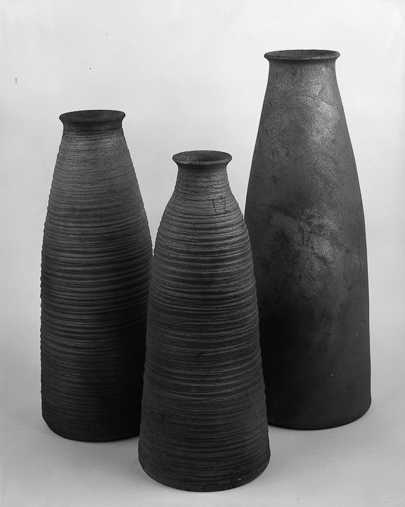

Hi All,
Well, I shot a second film at the weekend and reversal processed it last night. As per my earlier post, I went for broke and shot FP4 at 25ASA. I didn't bother with any bracketing (usually when I make exposure changes in the camera I either don't write down what I've done and promptly forget it or if I do write down my variations, I inevitably lose the piece of paper).
For the first developer, I decided to up the ante considerably, so that was Rodinal, 1 + 25, 20 degs C for 11 mins. Everything else was the same, except that I've invested in a new balance that reads grammes to two dp's, so hopefully more accurate. Weighing out the chemicals (0.8g KMnO4 and 11g Sodium Bisulphate) then adding the required 400cc of water for my tank seemed to work fine. As I mentioned before, I don't like having to store gallons of stock solutions. One word of warning for those who aren't familiar with Potassium Permanganate - don't wear any good clothes, as a single grain of the stuff will leave a brown blob for ever.
The results were pretty encouraging, if a little surprising. The first half of the film was taken in fairly overcast conditions, and I wasn't expecting very much from those shots. The second half was shot in bright sunshine and I was confident that those would be the better ones. It turned out to be the other way around. The overcast shots all turned out remarkably well, whilst the sunshine shots were all rather dark. i.e. underexposed. I wondered whether with the shorter exposures (typically 1/125th) of the sunny day I might be running into some kind of reciprocity issue when rating FP4 at 25ASA? (The overcast shots were typically at 1/15th to 1/30th). Alternatively, it could be that the meter of the camera I was using (Spotmatic) is on the blink and not as linear as it should be. I shall have to compare it to another. The only other slight issue was uneven development apparent in the sky areas that seems related to the perforations. Perhaps continuous agitation in the first development might solve this?
All comments and criticisms are welcome, as the results of about a third of my 30 shots are very encouraging. With colour reversal materials seemingly being chopped on a monthly basis, it could be that this technique may one day become the last stand of us slide-takers!
Best wishes,
Steve

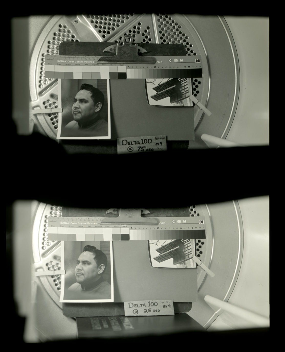

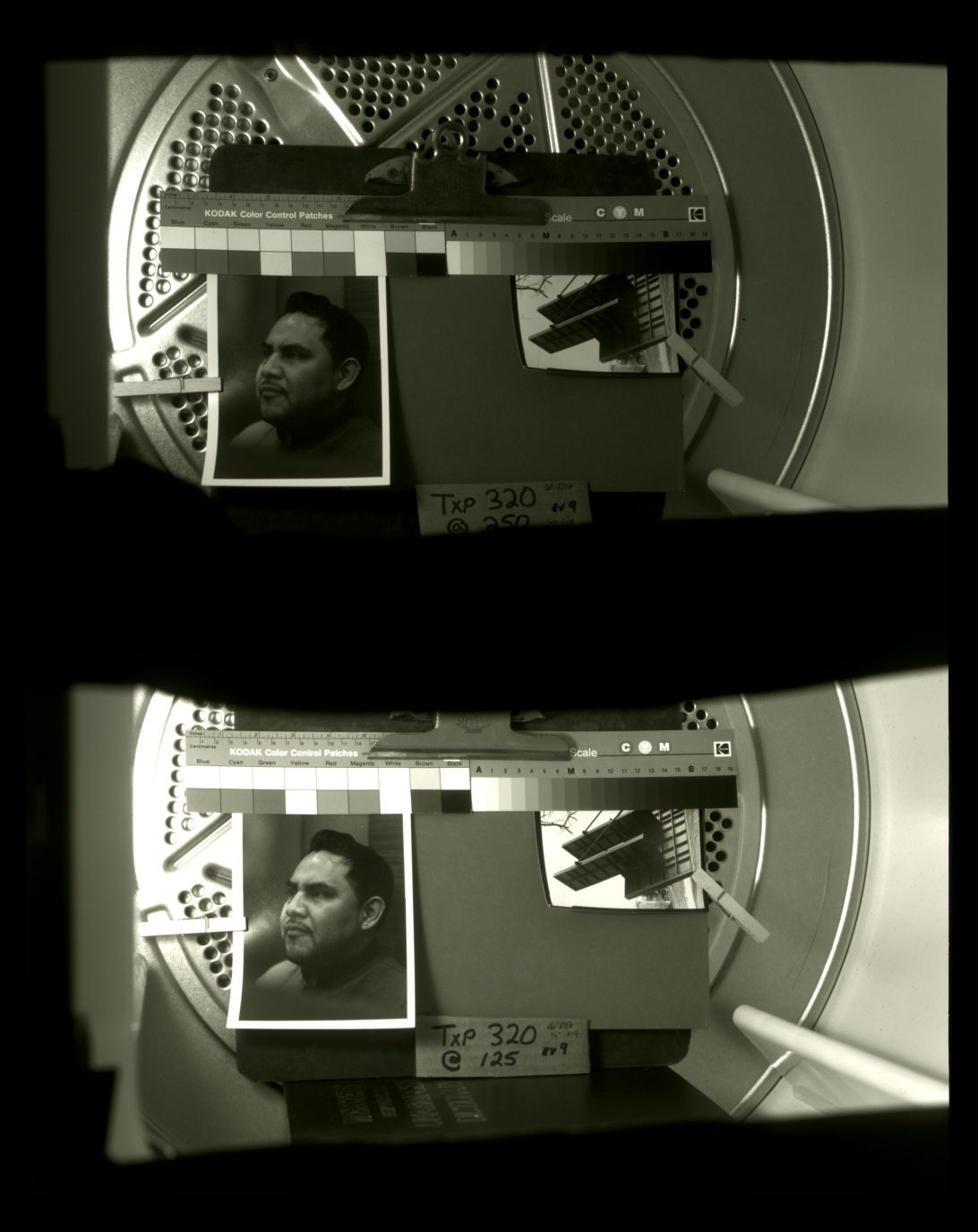

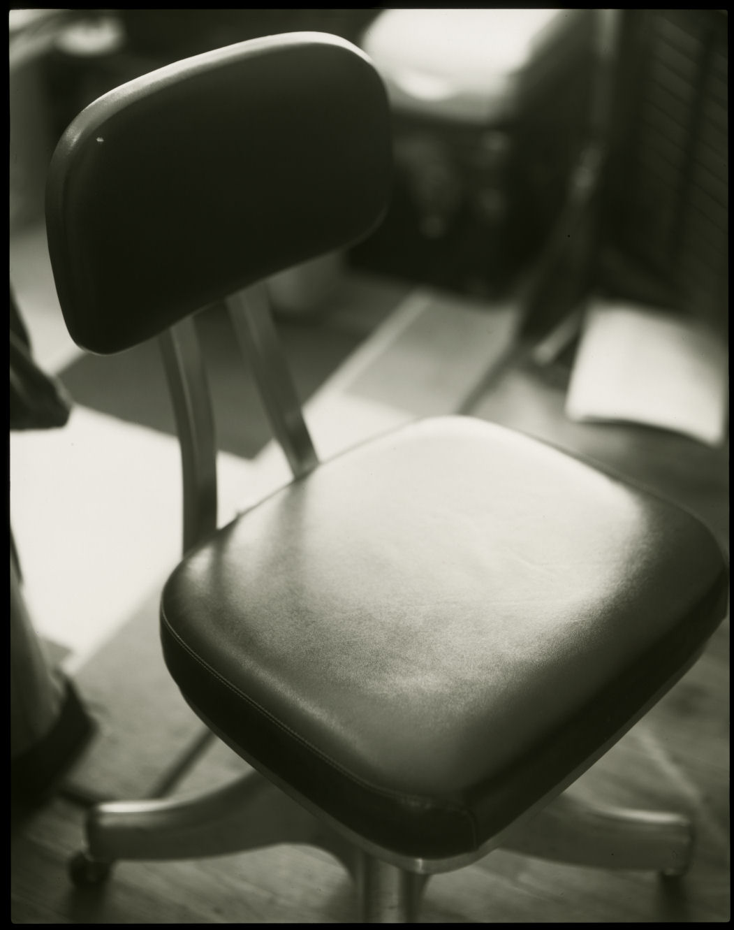

Ok, here we go...
The first two sheets were double exposed w/ two ISO's per sheet. That's why the subject is sitting in my dryer, because that's the only way I could get the surrounding area dark enough to do a good, clean double exposure and not fog the adjacent part of the film.
:laugh: It was fun.
All were taken on a Raptar 135mm f/4.7 lens at 1/4th. In each case, I only adjusted the aperture to reflect the new ISO, metering the gray card as EV 9 in all cases.
TXP loses quite a bit of speed, but I guess no one considers it a true 320 ISO anyways (dr5 at least), and Delta holds its speed very well. Shooting at ISO 64 probably would've been perfect.
The next two pictures of the chair are on TXP320, and the lighter one was shot at ISO 64 and the darker at 200. The main glare area read about EV 6, exposed at EV 4
The plant was also TXP320 @ 200 ISO, leaves ranged from EV 4-5, exposed for EV4.
It's odd that in the tests, TXP @ 125 looks just right if not a little dark, whereas the chair and plant look great @ 200. I guess the latter two photos were pretty high key to begin with, and as I usually do, erred on overexposure.
All in all, very happy with the results!
p.s. I suppose that the tests in the dryer aren't ideal, in that changing the aperture may have had a lot to do with changes in contrast.
Ohh, and also, note the slightly warmish hue of TXP as opposed to the cold grey of Delta. Scanned in color, and no correction.

Ok, here we go...
:laugh: It was fun.

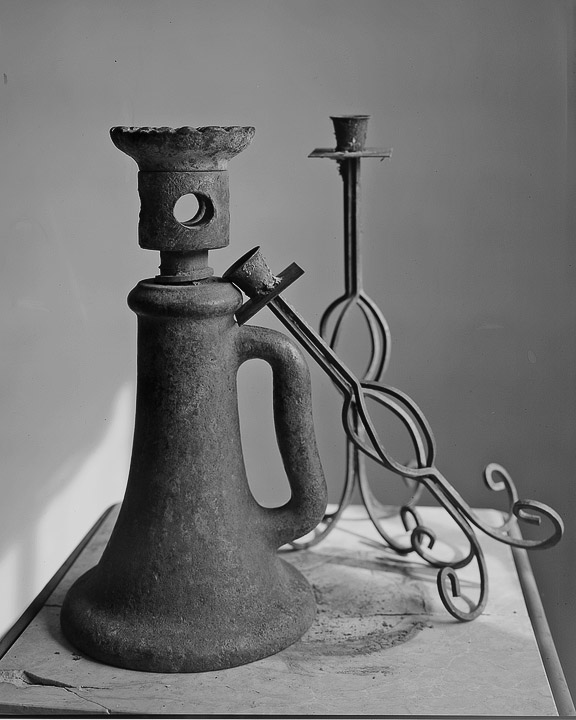

Well after following this thread I got inspired to give reversal a try. I spent a lazy afternoon today taking a couple test shots and developing them. I was quite happy with the results considering it was my first attempt. Nothing to it unless I just had beginners luck:smile:
My process was.
Jobo cpe2 with a print drum
Film 8x10 efke pl100 shot at iso 100
develop in d72 1 + 2 for 8 minutes
wash in h20 for 2 minutes
bleach for 5 minutes ( bleach was 2 grams of pottassium permanganate in 500ml of h20 mixed 1 + 1 with 30ml of battery acid in 500ml.
wash for one minute
clear in sodium metabisulfite for 2 minutes (20 grams in 500ml
wash in h2o 2 minutes
expose to light 1 minute on each side
redevelop in d72 1+2 for 3 minutes
stop bath for 1 minute (3% citric acid stop bath)
Fix in Kodak fixer for 5 minutes
hca for 2 minutes
wash for 5 minutes
regards
Erik

Last one for the day is dry. Same routine with the sodium sulphide as before for the 2nd developer. 8x10 pl100 with 24" RDA

Here's an attempt at using a reversal processed ekfe pl100 8x10 neg on Ilfochrome. This negative is really rich to my eyes. I'm quite pleased but I do not have anything to compare it to except my other attempts. My reversal negs seem a little flat to me which works ok for Ilfochrome and I'm not sure how to increase the contrast with reversal processing.
d11 12 minutes
wash 2 minutes
bleach - ammonium dichromate + battery acid (I answered my own question whether ammonium dichromate can be substituted for potassium dichromate)
wash 1 minute
clear 2 minutes - sodium sulphite, sodium metabisulfite, citric acid
wash 1 minute
2nd developer sodium sulphide (10% solution used 1 + 5 )
wash 2 minutes
fix 5 minutes
this routine worked pretty idiot proof for me except maybe a little low in contrast for my liking.
