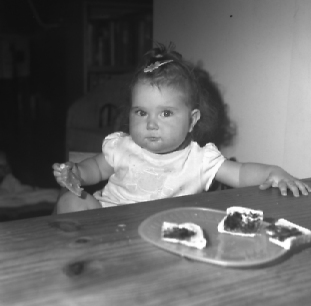

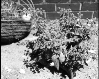

G'day Shawn,
You'd asked what film/s are used. I use the 120 roll Shanghai GP3 film as it has a clear base, and I also run 16mm cine that is the Foma R100 you mention. I have tried Foma 35mm and 120 roll film and even though it has a dull grey base but I barely notice this when projected.
Included two images, one of the Shanghai (6x6) the other of Foma (6x7).
I use a chemistry that is identical to Existing light's but for the bleach which is identical to Mike Wilde's formulation. My fogging is 8 mins (4 per side) in daylight.
I went through a great deal of lost rolls before I was comfortable running the real thing through a process I'd get usable results from. Which leads me to concur with Dr5's comments make sure the chemicals are pure/fresh. I tried using old/cheap raw chemistry and it cost me a lot of wasted time.
Hope this is of some use.

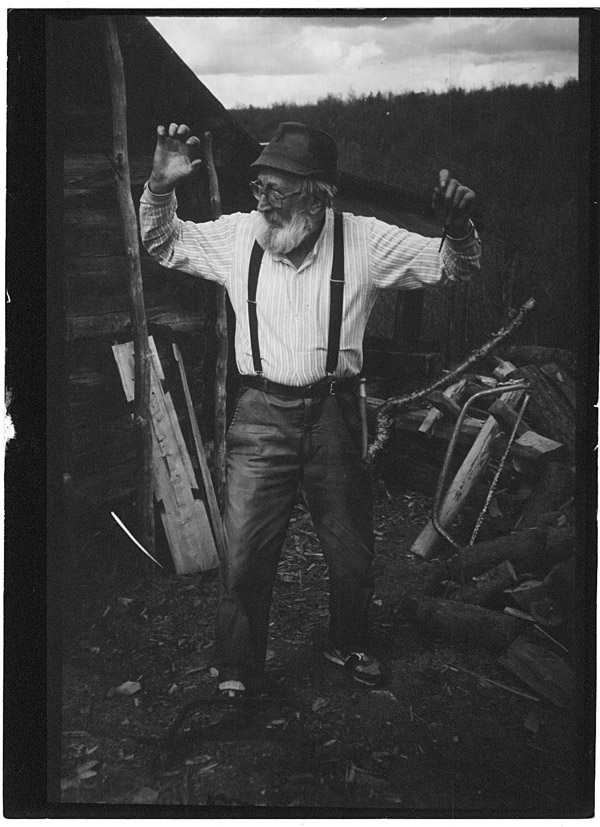

I've also done some reversal prints from color slides. Yes it did work... However the emulsion becomes very soft and you have to be super careful. It also changed glossy RC paper to a matte finish :smile:. The prints were a bit "muddy" as I didn't have a decent clearing bath at all then. It was when I was starting my darkroom hobby... But it really was worth a try and I'm sure you can get good results by tinkering around a bit.
I ended up using preflash to bring the dark tones visible then but it ruined blacks. I think I'd use different methods today. Sorry about scanner noise in the attachment. But I think this BW version looks much more old-fashioned than the original, modern color slide. Fits the scene.
