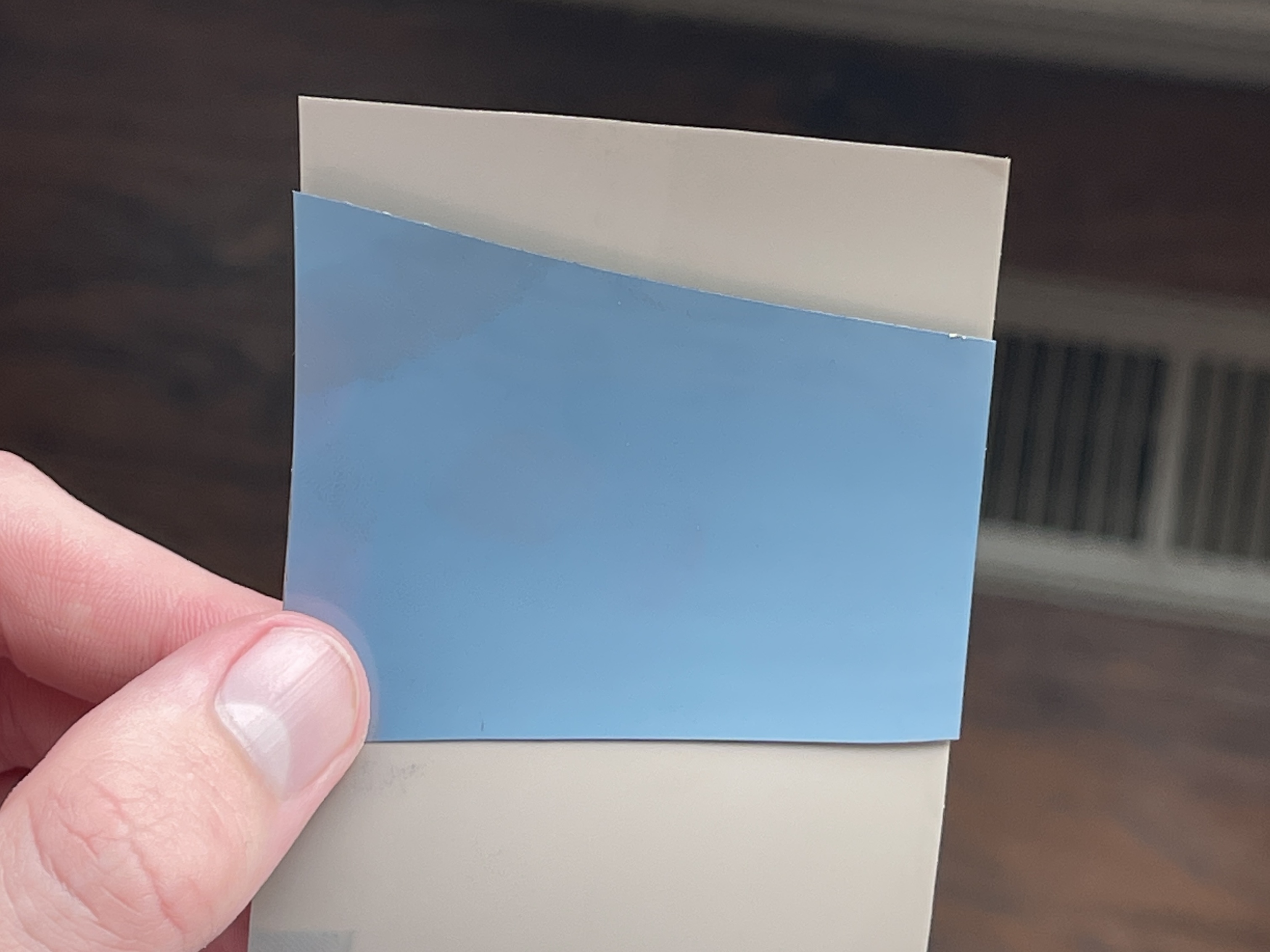

Attached is a piece of Foto 100 120 film compared to Aviphot 200:

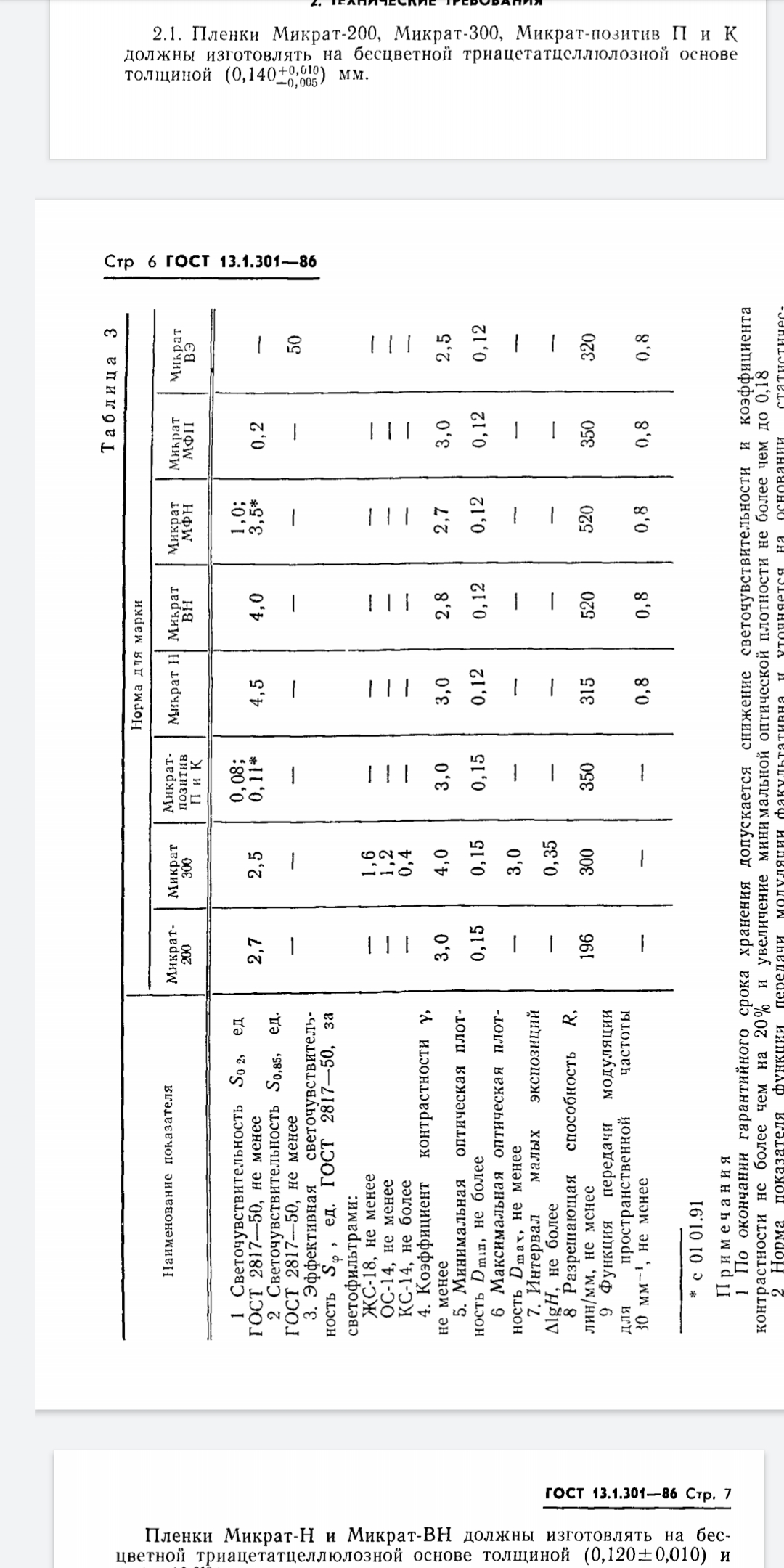

I found Svema's product sheet but poor quality. I tried to process it in a readable format - there may be errors.
The formula according to GOST specification is:
Metol (Elon) - 8 g.
Sodium Sulfite (anhydrous) - 125 g.
Sodium Carbonate (anhydrous) - 5.75 g.
Potassium bromide - 2.5 g.
Water up to 1000 ml.
For gradient 0.62 - development time as written on the box. For gradient 0.80 - 2-3 minutes more.
  • svema.pdf

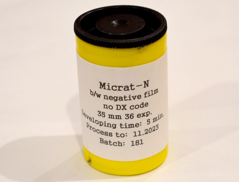

I am on the third roll of Svema Micrat-N, but I cannot understand what sort of emulsion is this. Upon me asking, the Astrum fellows told me this film is 25ASA, but results so far indicates this not to be the case.
The negatives all come out heavily overexposed, although they were shot at 12, 25 and 32 respectively. Moreover, it would appear that the slower I treat this film, the overexposure occurs more heavily. Could it be that the sensitivity is way higher than say, 25 or 32?
The label on the film can indicates "develop for 5 minutes" and this is all there is, as far as recommendations are concerned.
Any idea on what is the actual speed of this Micrat-N negative, please? Any development data? Thank you !
Micrat is a very slow (GOST ~3) high-contrast copy film. I doubt that what you bought is Micrat. I would try shooting your film at EI 100 and 200 and developing in Barry Thornton's 2 bath developer for 4.5 min and 4.5 min. Or (semi-) stand develop in Rodinal.

I did a quick search, and a couple listings online (including one from a Japanese film seller) list this as ISO 6. The Micrat line seems to be low speed (I've used Micrat-Orto Direct, which is < ISO 1).
I know nothing about this film stock, Romanko's suggestion that they probably mis-rolled something else makes good sense.
My general advice would be what I do with an unknown film that I have a lot of - meter at ISO 100, and bracket two or three stops either way.
If you're getting heavy overexposure you're probably at least a couple stops over.
[edit] This is also orthochromatic, so if you shoot it through an orange / red filter and still get an image, it's probably mis-rolled.
This is all part of shooting unknown film stock game. Great fun if this is your kind of things.
Thank you, Romanko. Concerning the fun factor, there is none, I can tell you :smile: Not very funny when the very people who roll it share the wrong info on what they just sold you.
Yes, the 100 and bracketing seems to be the way to test this negative. Am I wrong in my assumption that if the film is say, 3 ASA, and I shoot it at 25, that should come out grossly underexposed and not overexposed? I mean, it's a slow film metered faster, not the other way round. Am I wrong here?
If you shoot ISO 3 film as ISO 25 you will have 3 stops underexposure. Your negatives will be very thin. Your shadows will have no density (transparent) and your highlights will be light-grey. If you post a photo of your negatives we could probably tell you more.
The goal for your next step is to get a negative that is neither too thin nor too dense. If you scan it and look at the histogram you will get a good idea of the actual film speed.
Obviously, you don't need to expose and develop the whole roll, a couple of frames would suffice.
I sometimes shoot very expired film and can understand your frustration. On the positive side, you learn a lot in the process.
Micrat-N should have green or dark-green antihalation layer. If your film is different colour it is not Micrat. The standard developer for this film is phenidone-hydroquinone.
According to GOST, should be 4.5, but Mikrat 200, for example, can be pushed to ~25-50iso with good results and not too much contrast.

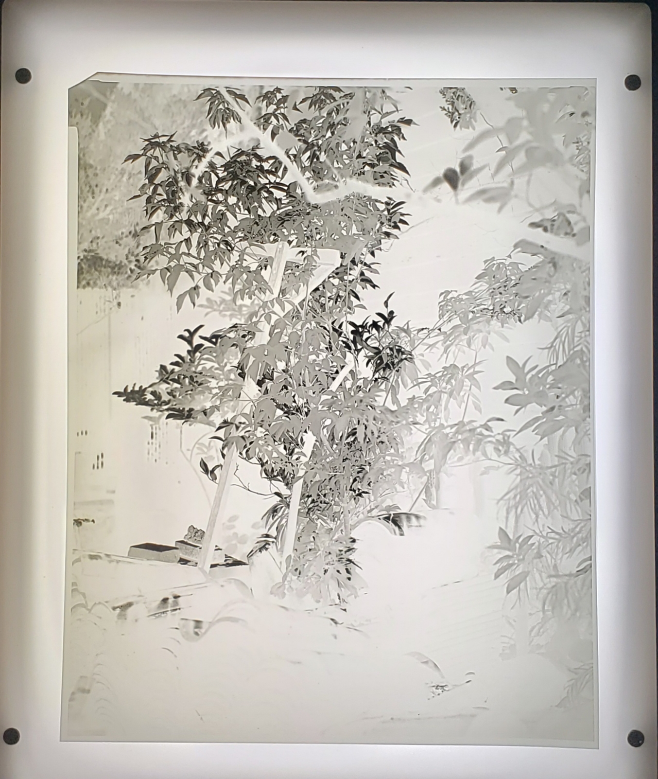

Here is a quick & dirty test negative of 8x10 Svema 100 on my light table.
Exposed at 2 seconds @ f16 with an IR720 filter.
Developed in Rodinal 1+50 for 13 min. @ 68°F.
My cellphone and my light table don't get along, so please disregard the yellow fringing on the left side of the image.
I made this exposure to test the IR response of the film, and to test for Wood Effect in direct sun and in shade.
I look forward to using an inexpensive IR-sensitive b/w film in 8x10!
